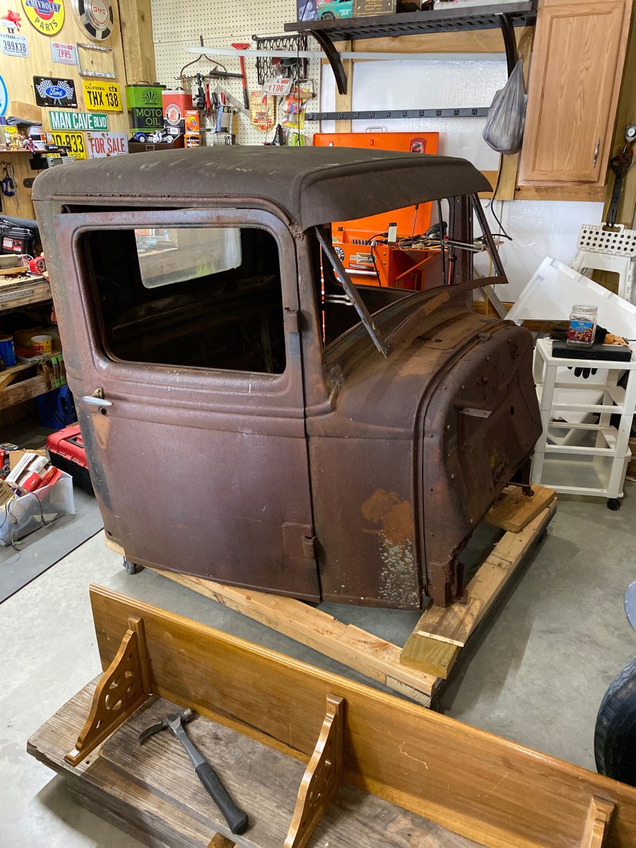

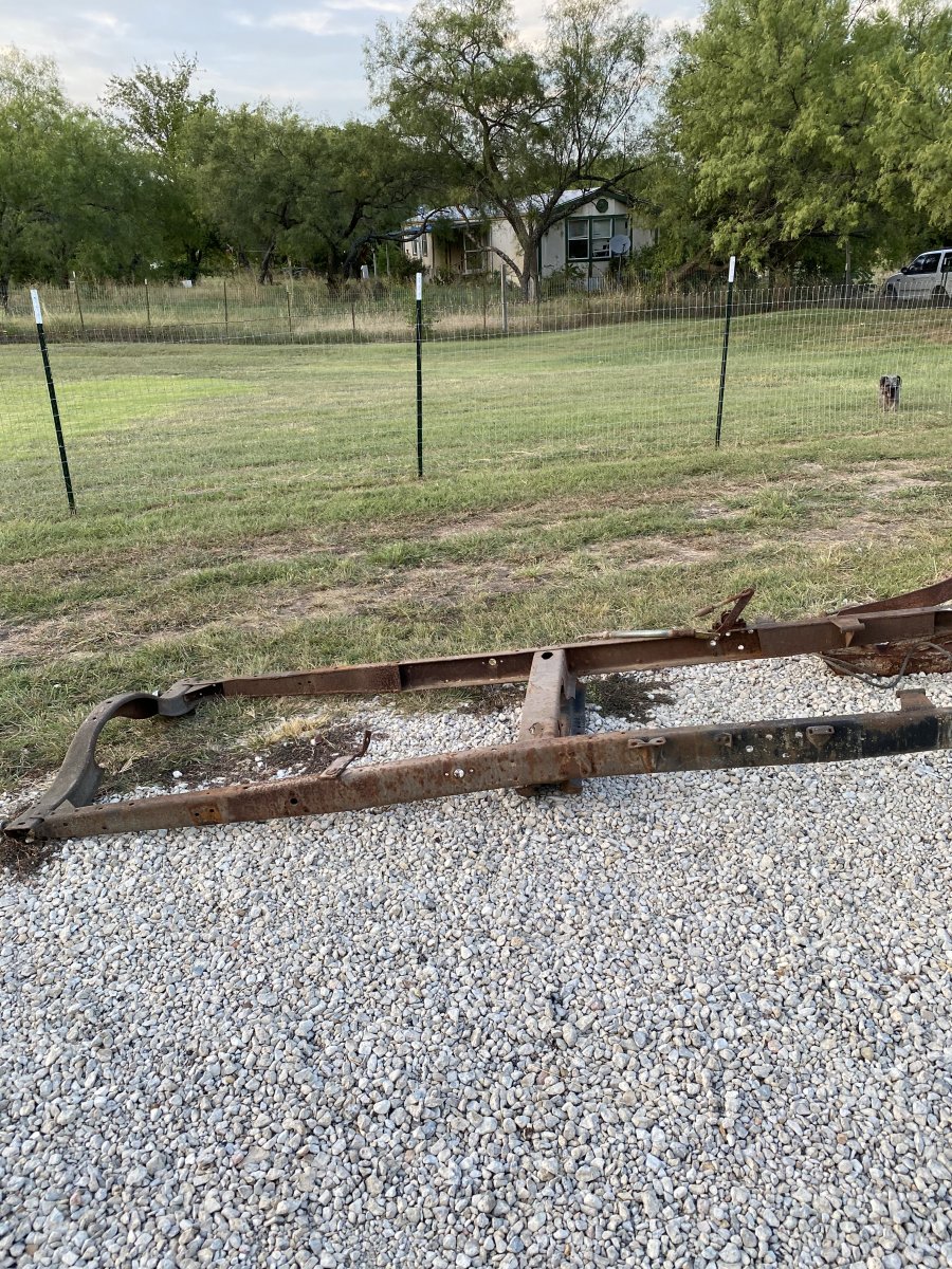

    I have been busy & have cash in hand for these. Considering going for at least the frame. Cab is a 34 and the frame is a Model A frame of unknown year. It came out from under a hot rod & has reversed front springs. He thinks it may already be set up for a V8. I am aware the 34 is not the same as a Model A but can they be made to play together? If not I will take just the frame (if it is OK.) Any thoughts?
    I think price might be a little high on the cab but I was able to flip some guns I didn’t much want anyway so not too worried about the cost, opportunity is knocking at my door...
    @RMONTY I would be glad for your help if you are free! This one is pretty close to me, in Springtown.

    I dont care for the later cab on the A frame myself. Alot can be made to work but I think you can do better than that combo. Now if you can get the cab cheap you can flip it.

    The frame has been partially boxed. I would hope that the frame was straight before the boxing and if so, could be a good frame. The Serial number will be found on top of the left rail right where the cowl will be mounted. There will be a * before and after the number. If the number has been damaged, may be a ***ling problem.
    From what I see, nothing wrong with that cab. If the price is right, could be a good start.

    Keep looking...that frame is not worth $400.00. It appears that the rear cross member is hacked up and I can't see the front. You should be able to find decent A frames for $200.00 no more than $300.00. I personally have never paid more than a $100.00. Stock not modified. Always bring a 25'0 tape measure and check it for squareness from left rear cross member to front right cross member and left front to right rear. you should be pretty closer to the same number on each measurement + or - an eighth. The cab could be worth $1,200.00 but the pictures are limited. Looks like the door is sagging suggesting subrail problems. I wouldn't put it on an A frame. If you buy it look for a 33 34 frame that is correct for it. That will save you a **** load of time. The 33 34 cabs have a bit more room in them than the A cab.

    I didn’t notice the crossmember was cut up. That must have been done to clear a bigger diff? It already has had some of the work done that would save me some time and money, like the reversed front springs, boxing and V8 mounts. If all of that work is good and the frame is square I think it would still be cheaper to take this frame than to build up a stock frame, ***uming I can even find one.

    Usually when a frame has "work" done to it, it's not a leg up. If it was so great it would probably be in a running car. The boxing plates on the frame look like a hack job, and then there's the actual hacking of the crossmembers. I wouldn't bring that frame home for $10.
    Try to find a bare frame with no previous boxing or crossmember mods. It's not that hard to do it correctly. Much easier to do it yourself from scratch than fix somebody else's crooked mess.
    That cab might be worth $1,200 if it's not too rusty. Is that rust through in the drip rail? If it is I bet there's a lot of rust in other nooks and crannies too.

    Model A frames are 103-1/2" wheelbase. (that measurement from center to center between front & rear crossmembers) Marginal length for 8BA type flatheads, one reason for so many Model A's on '32 frames. ('32s have 106" wheelbase, more engine room, lower side rail profile)
    The '32, '33 & '34 pickups are wider and longer at the cab than Model A's, look like Bigfoot on a small wagon if set on Model A rails.
    If you find a solid Model A body, Model A rails are 'proper'...but '32 rails are much more preferable.

    Did some more research. That crossmember is not only probably dangerously weakened but physically unusable for what I want to do since there's no way to mount the stock style springs to it if I'm understanding this correctly. With that section of metal removed there is no way for the U-bolts to sit still.

    The black frame has a cobbled front crossmember, other cludgey brackets welded on, hacked off horns, and a rattle can paint job. Not worth the $900.
    Maybe the other ch***is in parts is worth it. You can rebuild the stuff and ***emble it easily. And then you will know what you have. Only trust the previous work of people you already know and trust.
