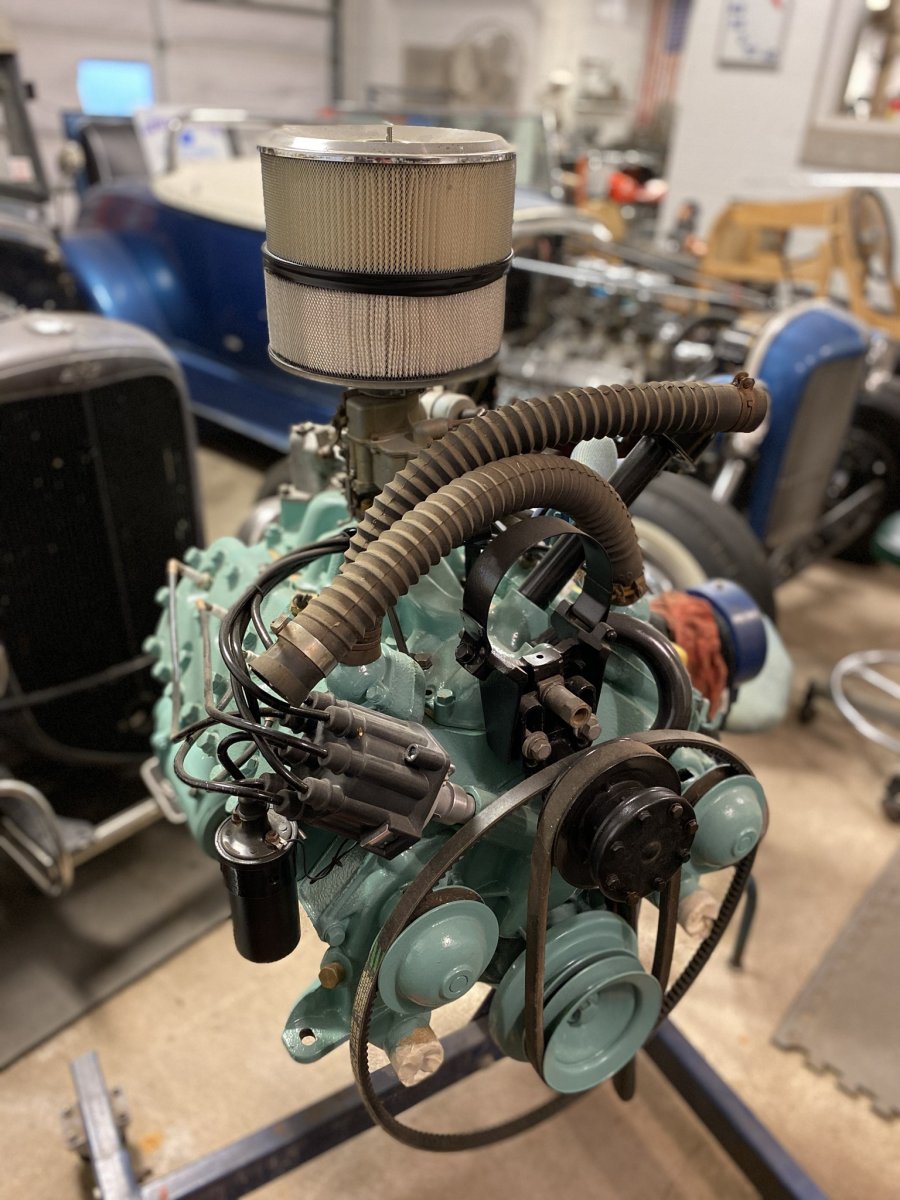

  17. Just for fun and because I was next to it here is an 8RT for my jalopy racer. The distributor is for a Chevy converted to flathead use by bubba here on the Hamb. E578CFC9-785C-4C3A-BAAC-009E92E11292.jpeg This is a great thread. I'm not a young guy but was younger when I started building my '34 Chevy (in my avatar) back in 2006 and that is how I found the HAMB. You are getting some great advice here and I'm excited to see where this goes. I did not always buy things "the right way." My truck was in a dozen pieces when I got it. The people you meet along the way while gathering parts and knowledge will be more valuable than your finished project!
    I may be going against the grain here but you could certainly get your project going with that rolling frame and upgrade things as you go along? Thousands of hot rods were done that way through the years. Hot rods evolve over time. I didn't look that closely at the ch***is pics but you could get it going with your flathead and mechanical brakes and upgrade later.
    Best of luck to you!
