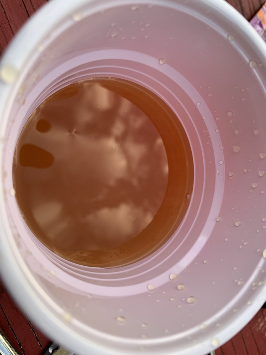

    What worries me a little is the water pouring out of this thing looks like this... it's not oily or anything but man I swear I put clear water in it. Is that just rust? Old coolant mixing with the water? It doesn't smell like anything.

    Eng getting warm, loosening up the rust that's inside, normal ops. Even after my block was boiled and cleaned there was trash that could be dislodged with a screwdriver ,or what ever you decide to probe with.
    More will come out,count on it.
    F/H water pumps are notorious for leaks, use the new style, better seals.

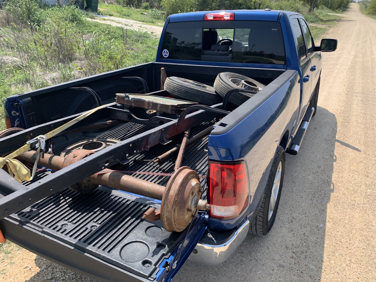

    Is that the one from Salado? Looks like you scored 3 wheels and a radiator maybe?
  29. trevorsworth
    Joined: Aug 3, 2020
    Posts: 2,109
    trevorsworth
    Yep! The frame, 3 good usable wheels that are the respective sizes I want (with the hubcaps I want), a radiator, two F1 steering columns/boxes, and a '40 Ford rear end with hydraulic brakes.

    Great news...The wheels with tires will go right on that rear end so you can roll it around instead of dragging it. The F-1 boxes are perfect for what your doing. Just make sure you inspect the sectors for pitting. They are really easy to take apart and put back together. Is that a Model A radiator???
    When looking for front brakes I suggest 46 to 52 F-1 pick up again. They are just about a bolt on to the Model A Ford axle. You will need to update the spindles. What ever spindles you buy you need to match the king pins with them. They will fit right on your A axle once you locate one. Look for 37 39 round back or 46 thru 48 square back spindles. Either will work.
