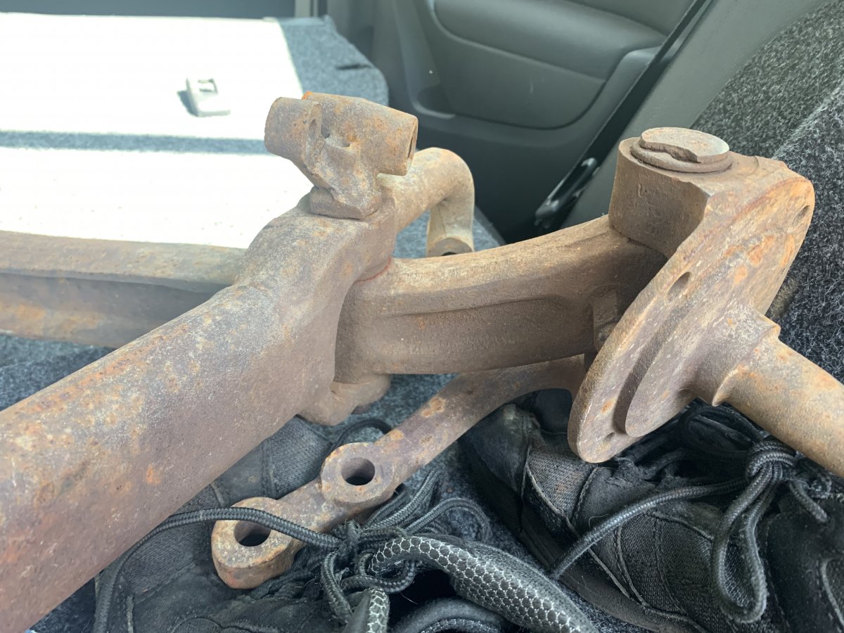

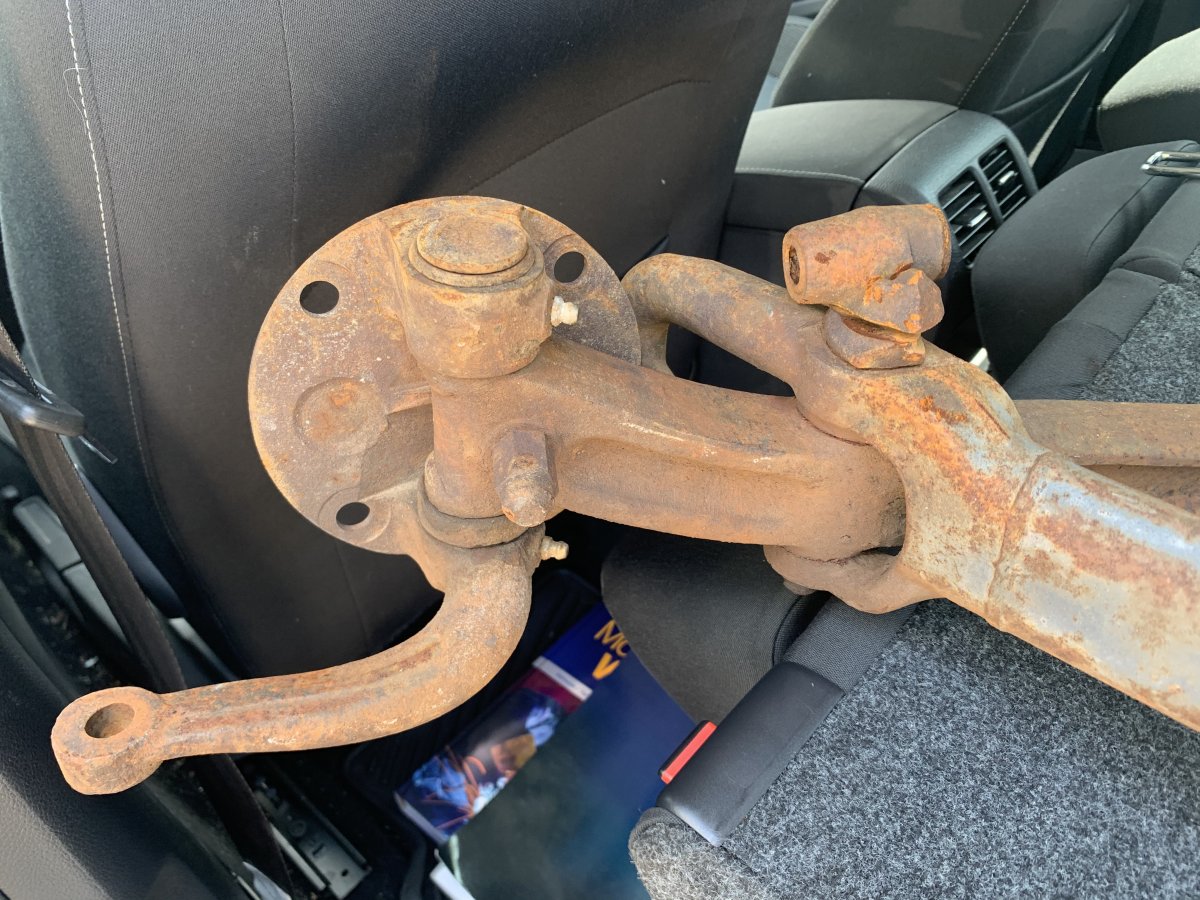

    OK, think I made a mistake. I didn't end up taking the A axle, but I took another setup that he had that he thought was a 32-36. It came with spindles and bones, but checking that chart there I think it's actually 37-41. I will probably strip the spindles off since I know I can use them on an A axle, and then sell the axle and bones.
    3F7B1C37-4D2D-412E-997F-D9556103BB35.jpeg 95FA7E9C-6633-42FE-A470-B7349ED97520.jpeg
    I paid 120 for all of it which I think is fine, even with the busted perch bolt on the driver side. Wasn't worried about that at the time since I knew I'd have to replace it anyway.
    Also got front shackles, kingpin bushings, and a stock top leaf.

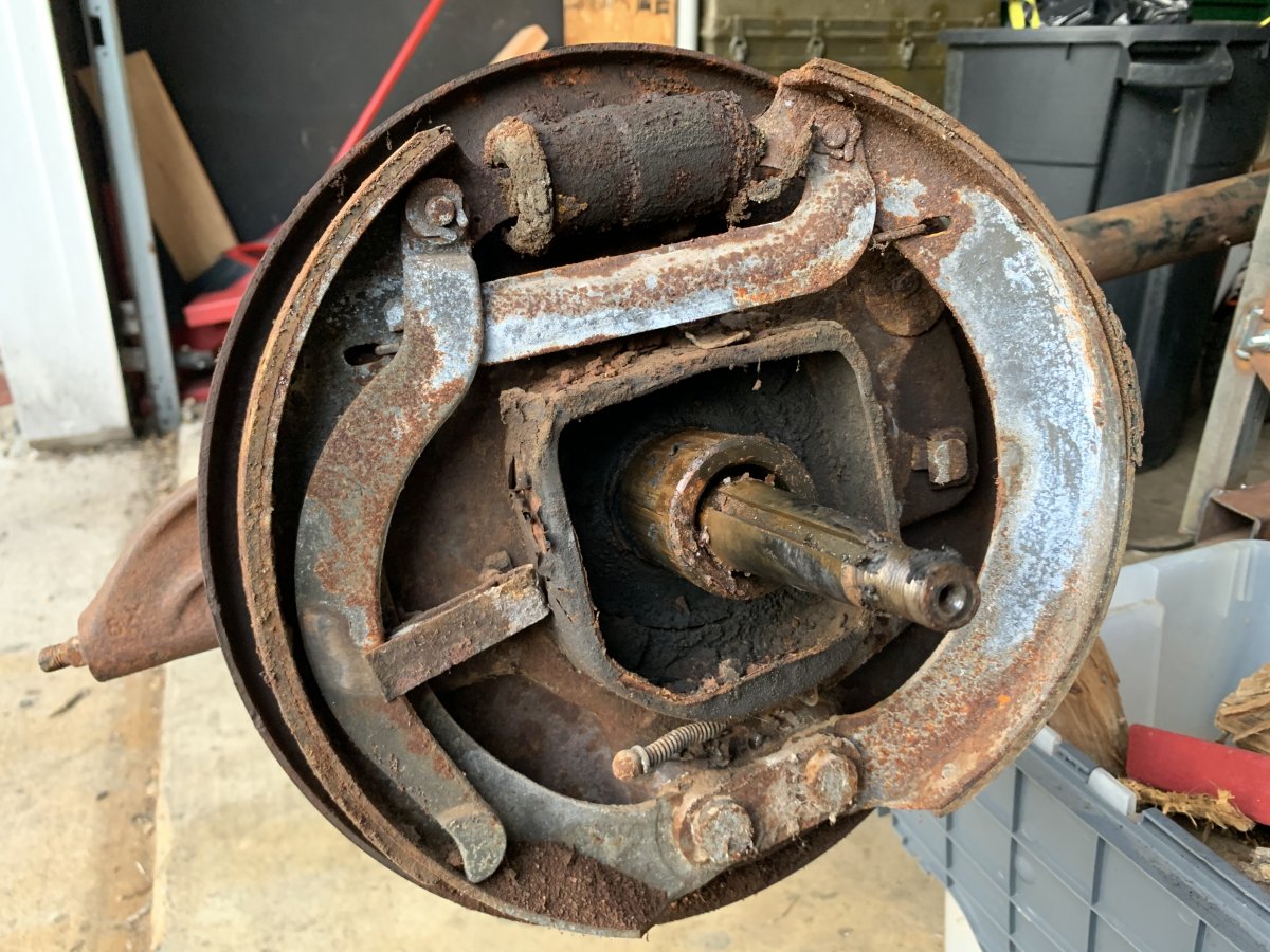

    Changing gears... forgot to mention I was able to get the C-clip off the drive shaft but haven't been able to get the speedo gear to budge.
    Got the castle nuts off but still can't get the drums loose. Not a good sign for this rear end I think.

    Your going to need a wheel puller to get the drums off. The shoes are probably rusted to the drums.

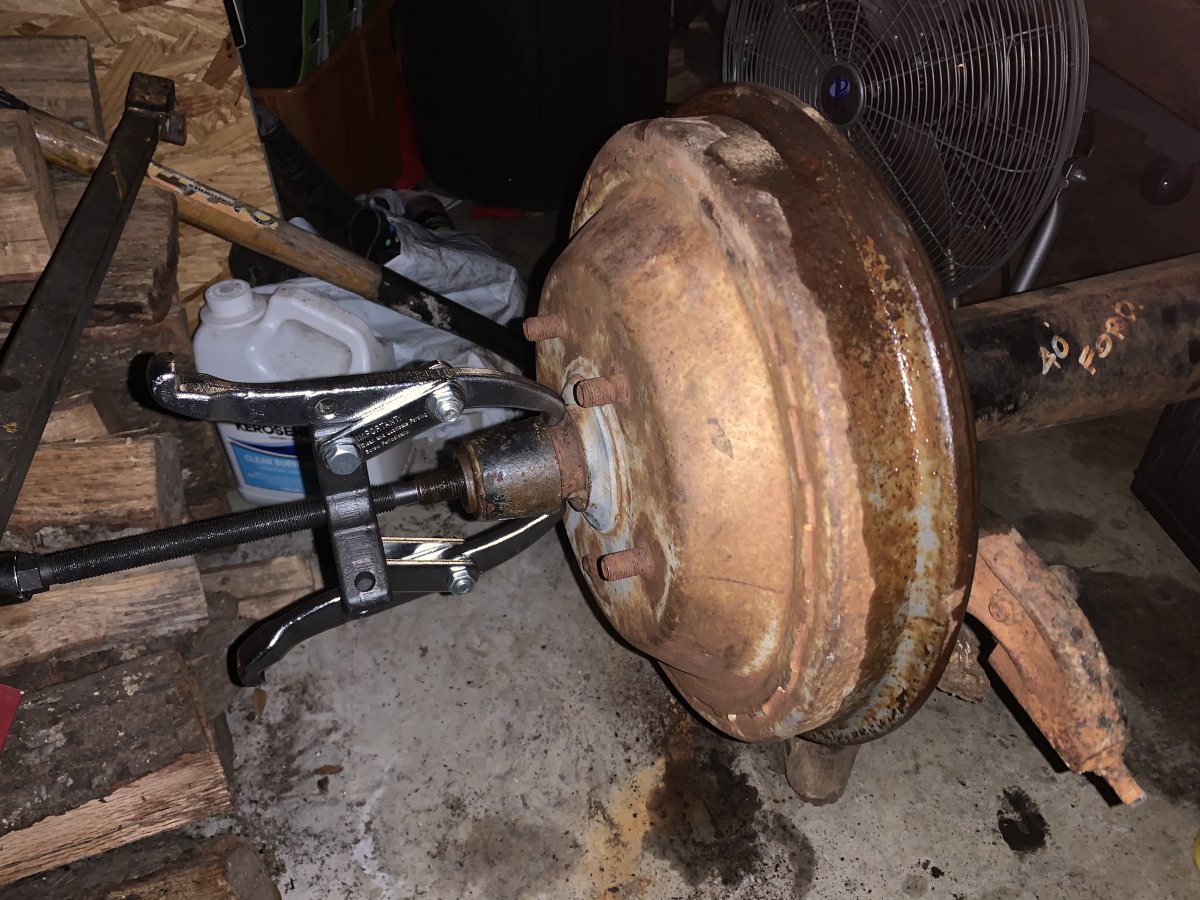

    I was able to get one of the drums off...
    But the other side is not cooperating.
    It’s shearing chunks off the hub and the drum is not even budging. This is the side that had the ant colony in it.
    Tried flooding with PB, tried gently heating with a torch, tried tapping around where the brake pads are probably stuck with a mallet, tried all 3 at once, tried all 3 while applying pressure with the puller... nothing. I think the bearing in the hub is seized to the axle.

  18. I haven't kept up with everything rear axle related but I'm sure somebody has told you your using a No Win style of puller. On top of that your probably turning the Axle itself into S**** Iron. Your not the first person to learn a lesson from making a Mistake. I suspect you'll soon be shopping for more parts if not another complete Rear Axle.

    Other than the obvious tiny chips it's taking off the hub when it slips, what's wrong with this type of puller? How is it damaging the rear axle?
  20. Fair question. My first observation is that you don't have the Nut put back on the Axle Threads to keep from crushing the first 1/2" of threads and closing up the Cotter key hole. You are trying to brake a tapper seal much like a very long Ball Joint Stud. Pulling from 2 spots and and using Heat causes the Tapper to compress in those 2 locations making it Tighter in those 2 spots and adding heat to expand the hub transfers same heat to the Axle Shaft making it expand also. It's a No Win deal. There is a special puller for doing that job and still having parts you can reuse when done. I'll take a photo of it tomorrow. Not a common tool anymore.

    Thanks, that makes a lot more sense. Hopefully I haven't destroyed anything already.
  22. I Googled pre 1948 ford rear hub puller tool. This is a photo of almost exactly what I have. I does a direct draw of the tapered hub section without making 2 draw points. It's also close coupled and stays true to Axle Shaft center line.
