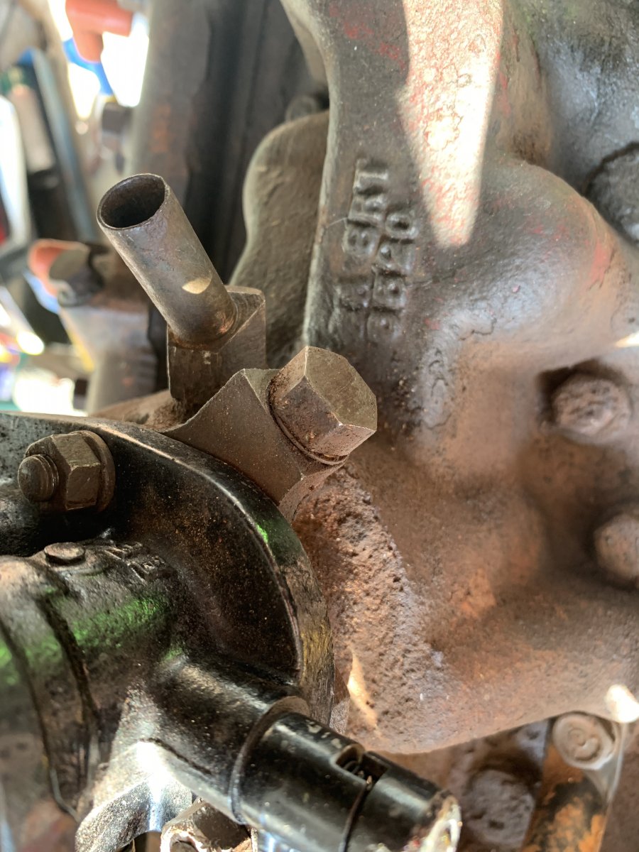

    Has a vacuum port been staring me in the face this whole time?
    edit: Lol yep it has been.
