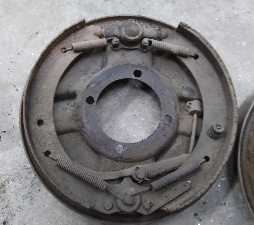

    Really need to see a picture of what you are looking at. Somebody may have put 39 backing plates on a 37 38 car and converted to hydraulics. Do you see a wheel cylinder anywhere?

    Here is a picture. I don’t know enough to tell one from the other. I see the wheel cylinder but it could just as well be mechanical. I wouldn’t know what to look for.

    That's mechanical.

    That's not a wheel cylinder up there. There is a cam inside that small housing which pushes the short rods outward. Same principle downstream of the levers, but upstream it uses a cable instead of hydraulics and rubber cups. None of the parts other than the spindles will be useful on 39 or later hydraulic brakes.
