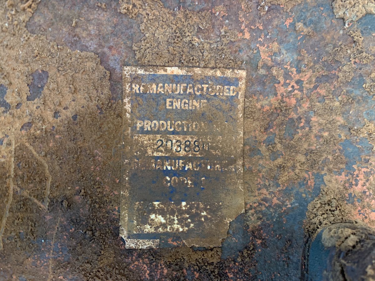

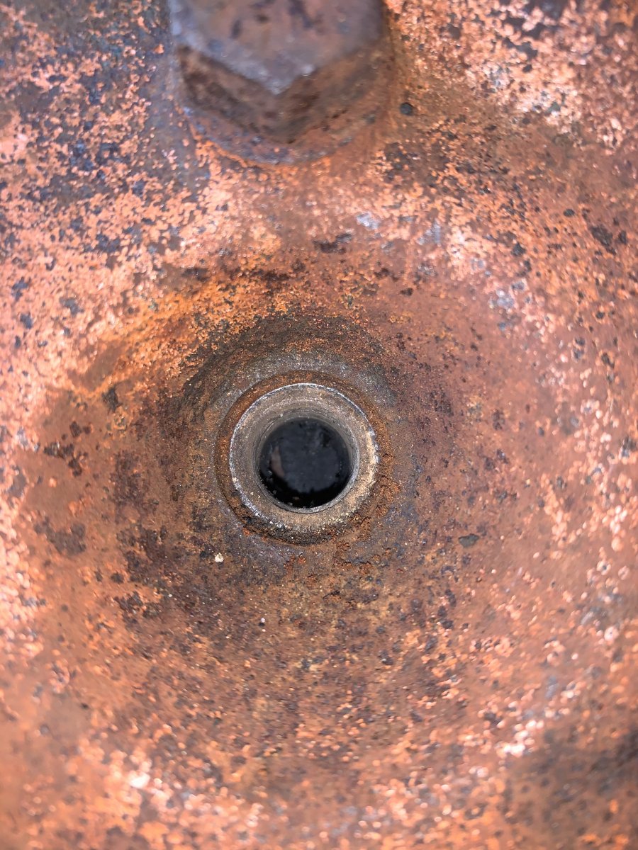

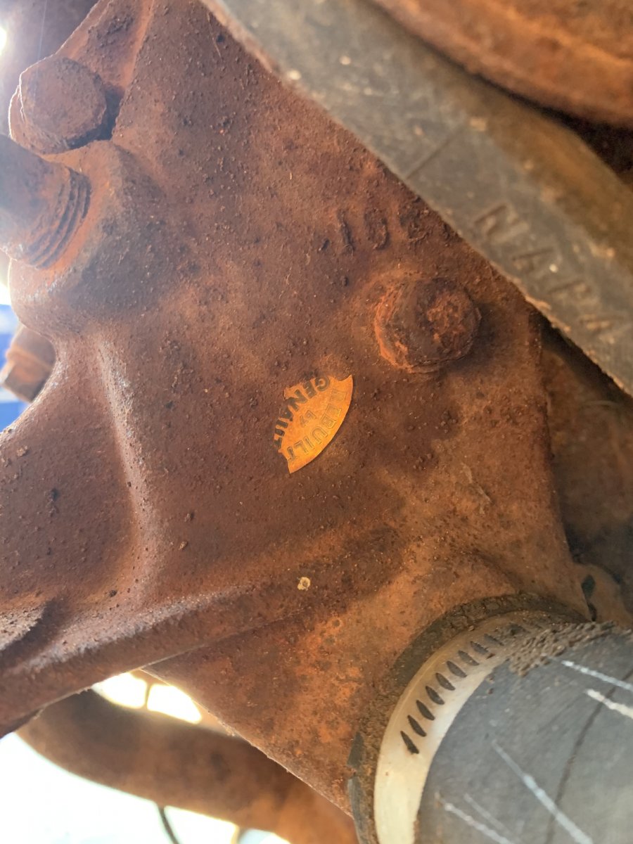

    Here are the two tags I found:
    16DFB624-32E8-4F8E-A25C-C29C41D238CA.jpeg B3B747B1-F3A8-4EB2-BE44-0068D30BB332.jpeg

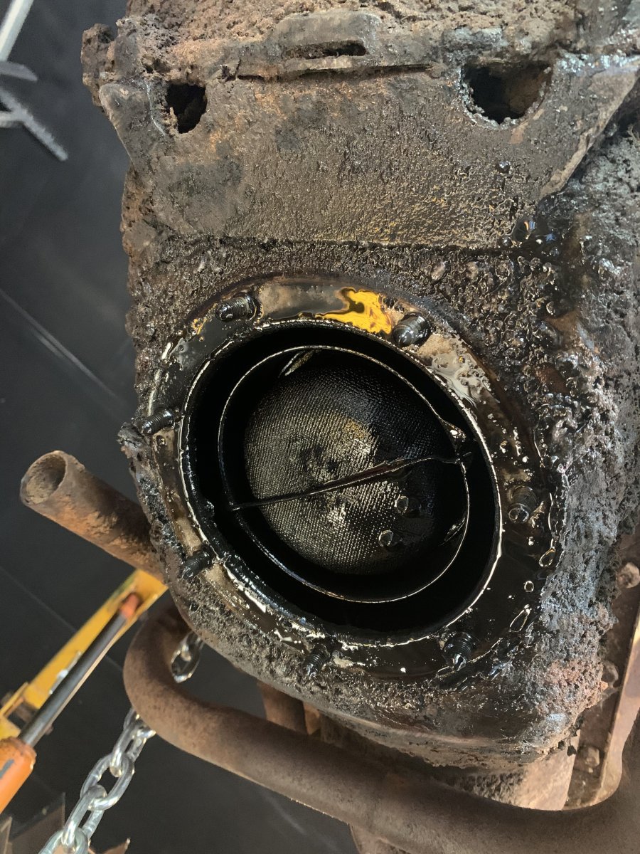

    And here is the bottom of the oil pan - it has the circular clean out @Marty Strode mentioned:

    Tags are a good sign and the truck pan with the cleanout makes it much easier to do a quick cleaning before you try to start it.

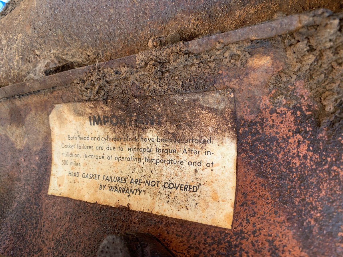

    Here is another rebuild tag.
    There are two plugs I can’t remove because my socket is too long to fit between the head and what I am ***uming is an oil filter housing. However...
    A4C58B55-16AC-4EF4-AACE-1534090F2E28.jpeg CC037073-476D-4934-8812-5EB1B3D2F53D.jpeg

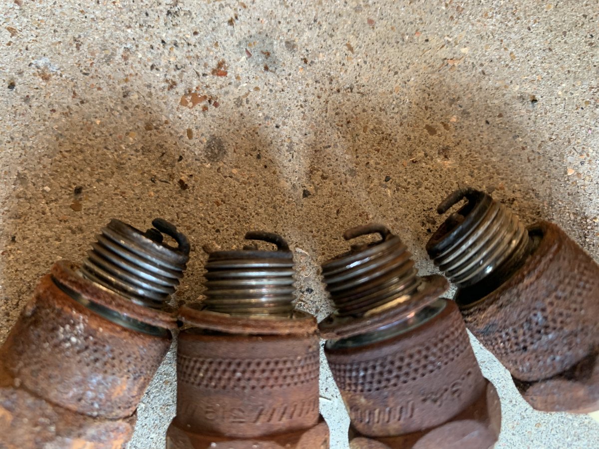

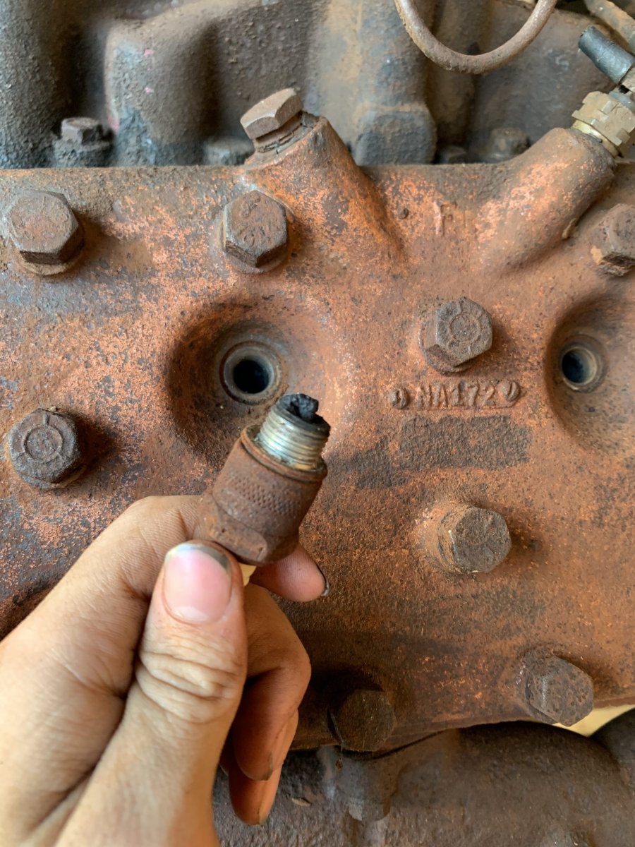

    Cylinder 3 has a ton of gunk built up on the plug and seemingly inside. All the other sparkplugs are clean:
    All sparkplugs came out easily without the use of penetrating oil. I have gone ahead and added Mystery Oil to the cylinders I can access.

    The tag I posted above says "Rebuilt by Genaut". The only reference to a company by that name that I can find is on this page which says it became part of GPC/NAPA: https://www.waymarking.com/waymarks...to_Parts_Remanufacturing_Plant_Morganfield_KY
    The page mentions that Genaut Industries was a remanufacturer, so that seems to make sense. Is this a known name?
    The gunk/oil on the no. 3 plug probably means the head gasket has failed, I think?
    Other than that: I can see all the valves opening and closing (except in the two that I can't reach but I'll ***ume those are fine for now) and can even hear the oil pump pulling oil through the engine as I turn it over. Should be OK to run for a bit even if the head gasket is done just to see if she wants to run?

    No, there is no way for oil to get from the gallery into the cylinder through the head gasket. I'd say an oily cylinder might mean bad valve guides or rings. But it still might just run fine.
    Don't go tearing pistons out until you've prepared yourself with some rebuild costs. Check prices on bearings and pistons. Not the same as a small block Chevy. If you can have fun now with a running engine (even if it smokes), just enjoy it til the whole car is done. Then you can spend the bucks later to rebuild it again, and put a hot cam in at the same time.

    The gunk on the plug means there is gunk on the plug.
    It is a little early to jump to that conclusion. Oil fouling can be a culprit. It has set for a long time. Needs to be woken up.
    Running it will give you an idea of general condition.

    Oil on a plug could be as simple as a bad spark plug wire. Simple.

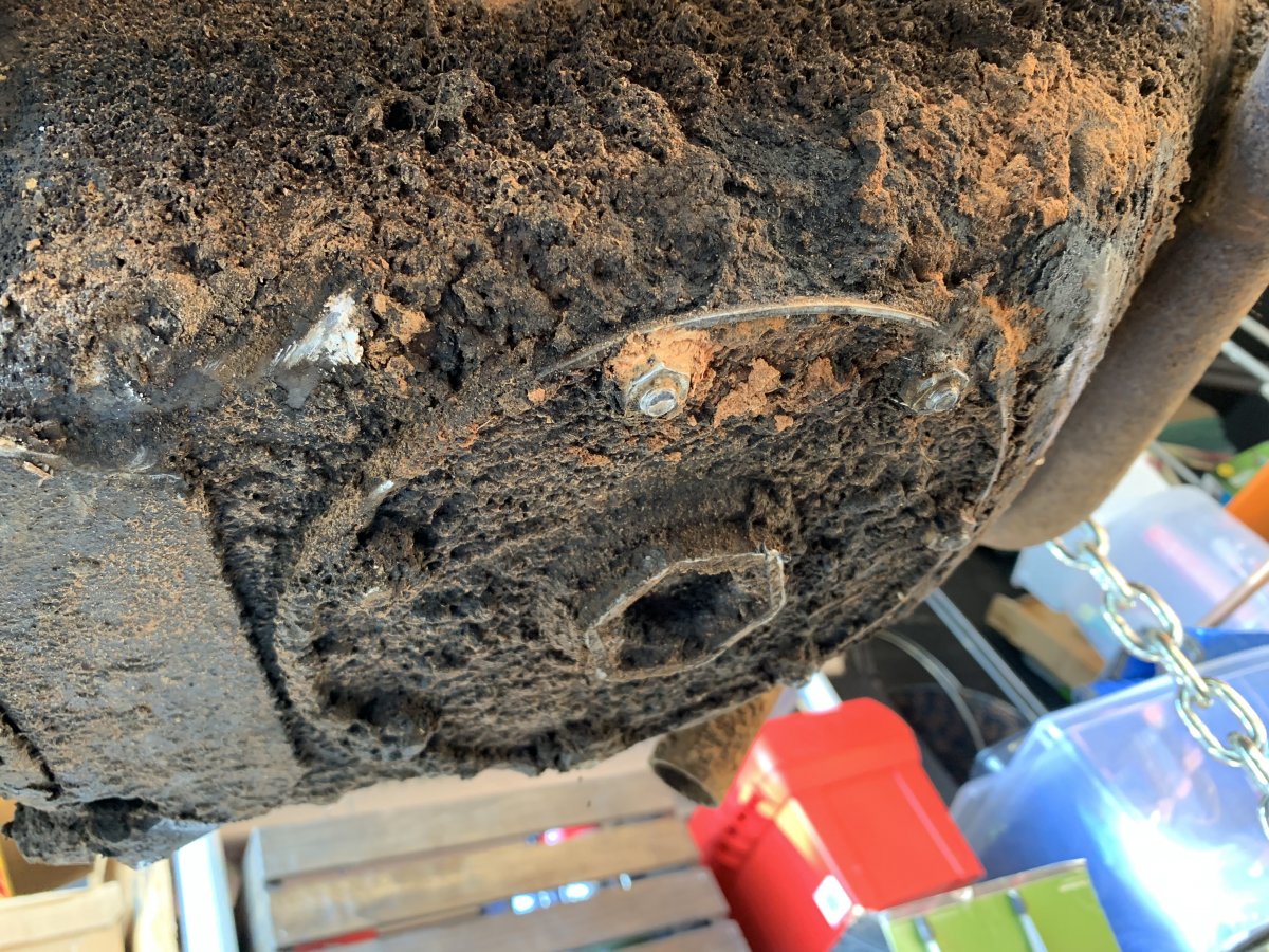

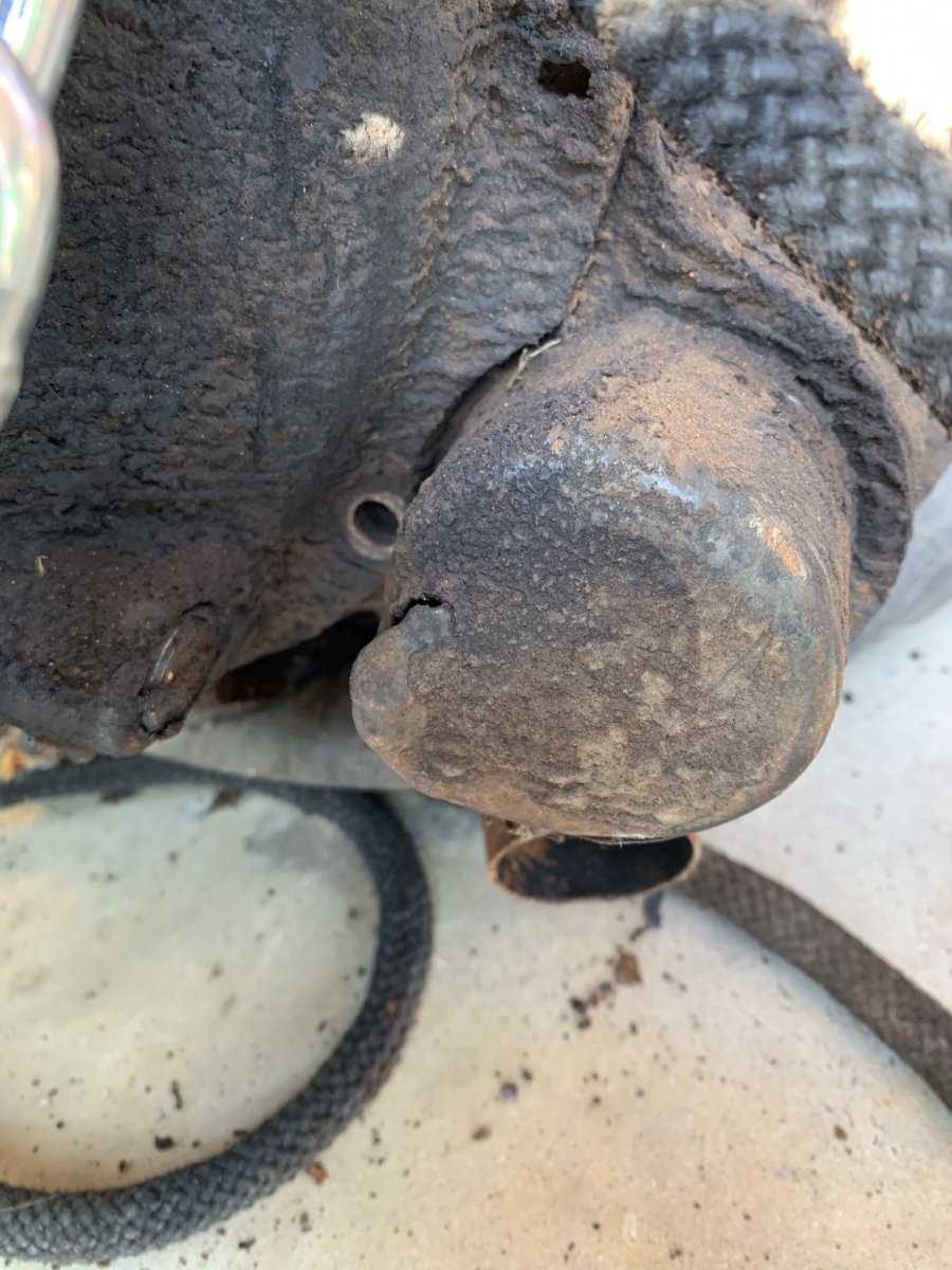

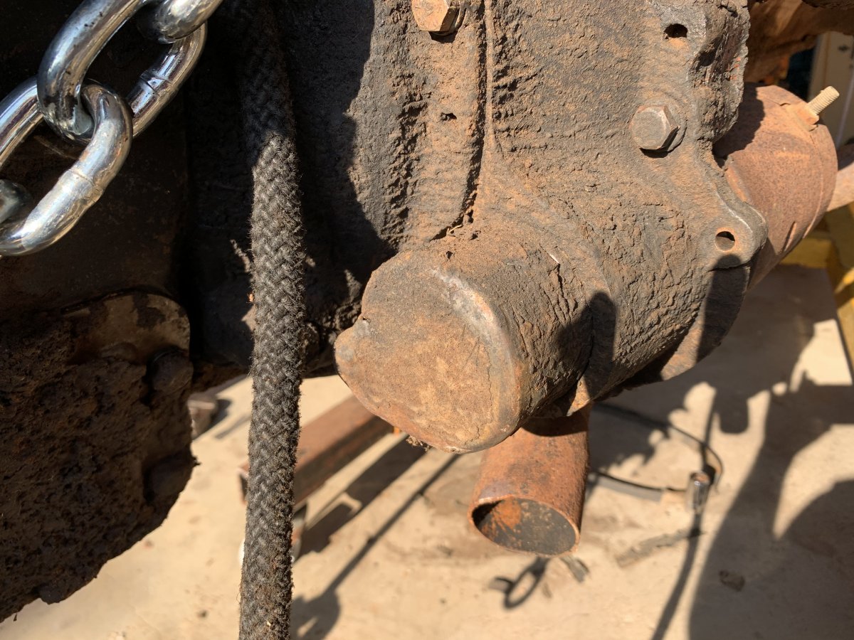

    D46FDC5D-E1B8-45B9-B1E3-ABB9E9B92AB9.jpeg 4F6A68D6-B510-4BEB-BC3C-99EEB551B6E0.jpeg
    That doesn’t look good. Hope it’s not important.
  24. Aaron D.
    Joined: Oct 27, 2015
    Posts: 1,038
    Aaron D.
    That just covers your starter gear and shaft. Probably just patch and weld or replace.
  25. I've seen that damage before. First time was in a Shop. The Bendix drive had come apart, that kind of damage was a result of. Second time was on a core motor that had been sitting outside. Water had gotten inside and froze. Split the can. The tear in the can isn't a big deal but if the Bendix is in pieces you might want to know that now rather than when your ready to connect a Battery to it.
    flatford39 likes this.
  26. trevorsworth
    Joined: Aug 3, 2020
    Posts: 2,057
    trevorsworth
    Alright, thanks. Was a little worried it was part of the starter itself.
    Busted a spark plug on accident when a chain went taut. :(
    Getting ready to remove the oil plug. My air conditioner went out so it's hotter in my house than it is in the garage right now so that's a big motivator to work on this thing tonight...
    I'll see if I can get a light up in there through the tear before I pull the starter out.

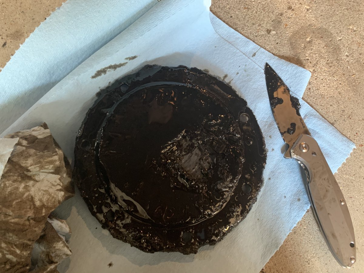

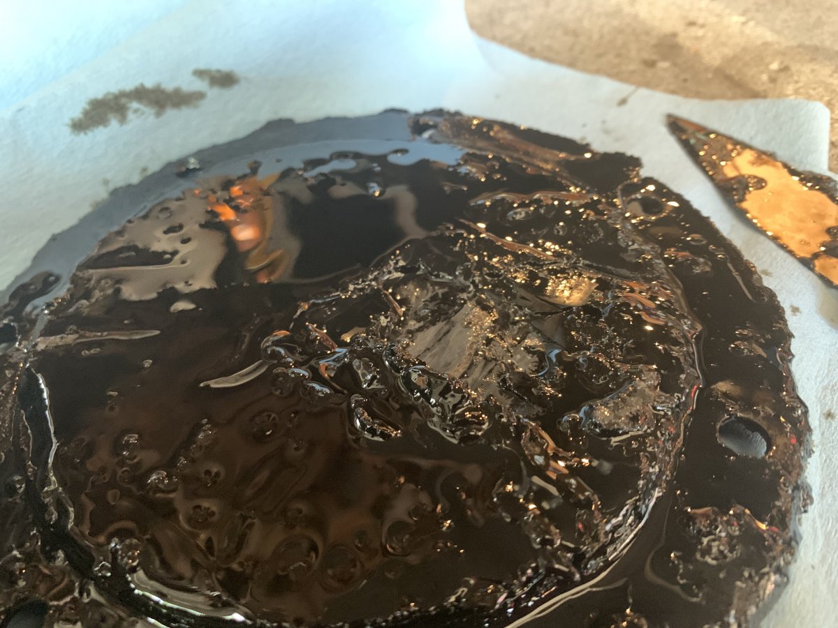

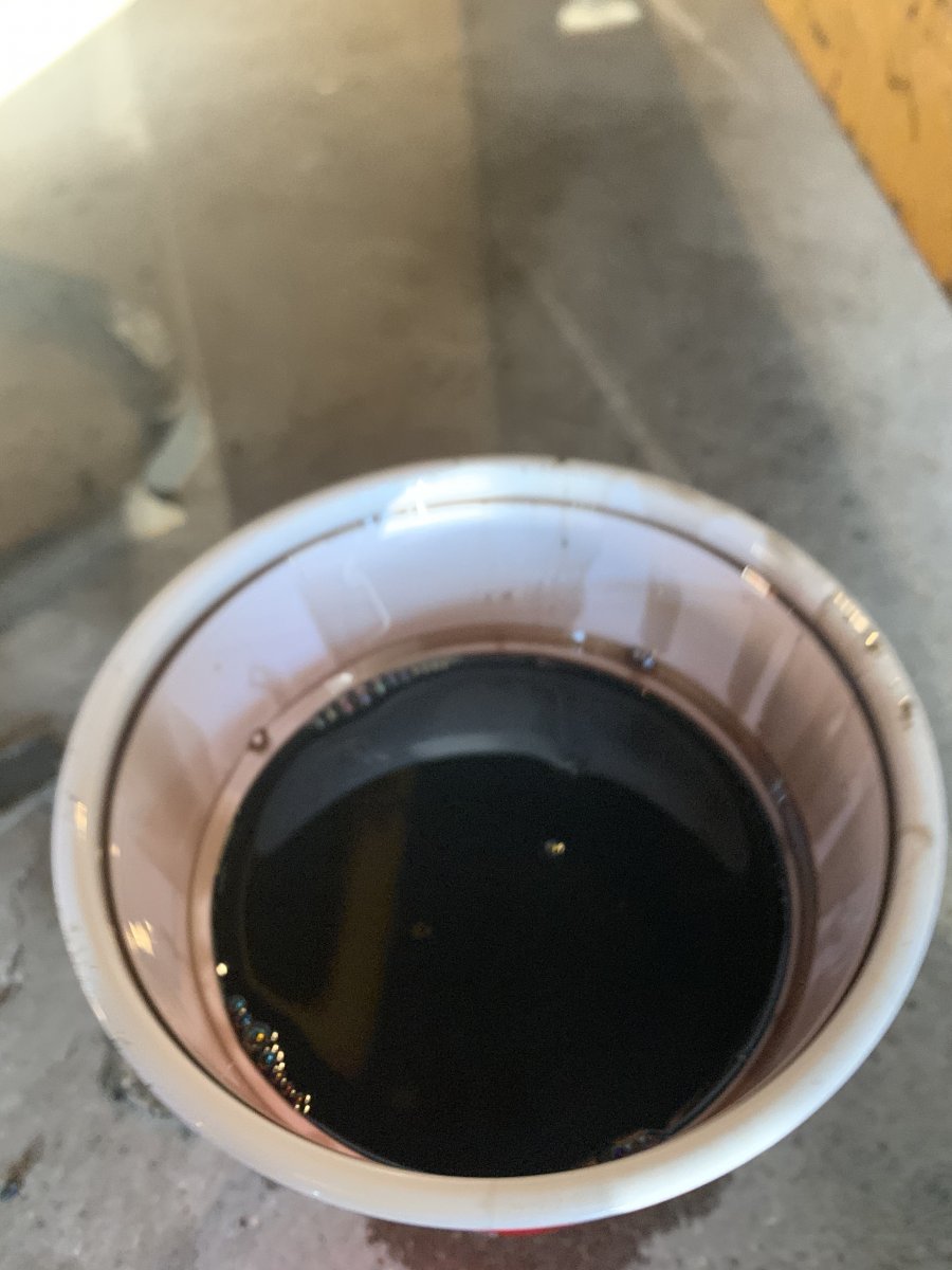

    Drained the oil. Looks very clean - no chunks or metal shavings.
    79CFF3CC-4975-4CF1-AD25-9FC4CADFCA9D.jpeg 1A53CD86-B55A-4E1D-8456-C8E8EB0EDC07.jpeg
    There is a nice thick sludge on the inside of the plug cap though...
    B484446A-75F0-49EB-848F-3EC9A278B1BC.jpeg 7F15F431-A441-4080-AF2C-83FBD0021290.jpeg
    kidcampbell71 likes this.

    The two bolt heads on the front of the starter are actually long bolts that go all the way through the starter and hold it to the bellhousing. When you remove them they also allow the starter to kinda come apart. Just loosen them and slide them about an inch out. Then you need to tilt the whole starter inward to get the Bendix around the ring gear. It's a tight fit.
  30. flatford39
    Joined: Dec 3, 2006
    Posts: 2,799
    flatford39
    Yeah and don't lose those bolts. there a PIA to find. I would remove the starter next after seeing that damage to make sure you an operation starter.
