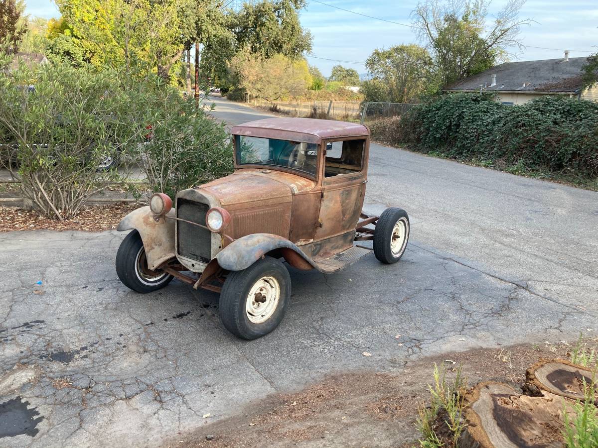

    Be careful looking at pick up cabs. A lot of them are cut down sedans. The giveaway is the belt lines don't match up.

    That one looks right. I have seen some of the cut down sedans and they immediately stuck out to me. If this cab was originally a sedan, it's close enough now that it has the right look and I don't mind.

    It is complete enough that CHP will not complain about inspecting it.

    I'm here. I have shop space that it can be broken down for transport in.
    If we pulled off the wheels, and the front suspension, this will fit in a 15-foot U-Haul box truck.

    I’m sure the truck is pieced together, the roof on the cab as I mentioned previously is late 31, it should have an indented firewall. The aprons are two piece 1930, and look like they may be cut short along with the running boards. The grill shell looks to be for a AA truck, it’s thicker than a p***enger shell for a thicker radiator, notice the gap.

    The seller said that he pieced it together but didn't give any details. You have a great eye and a lot of knowledge, thanks for sharing.
    The cowl may not even be an original companion to the cab. I am not necessarily intending to use the fenders (and therefore the splash aprons etc) but don't mind having them in case I change my mind later. I was planning to go ahead and paint them along with the rest of the body so I have the option to bolt them on down the road if my tastes evolve.
