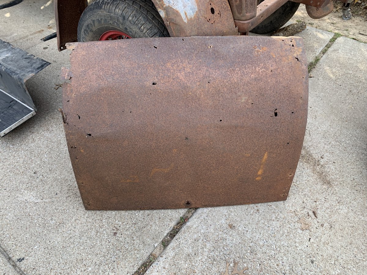

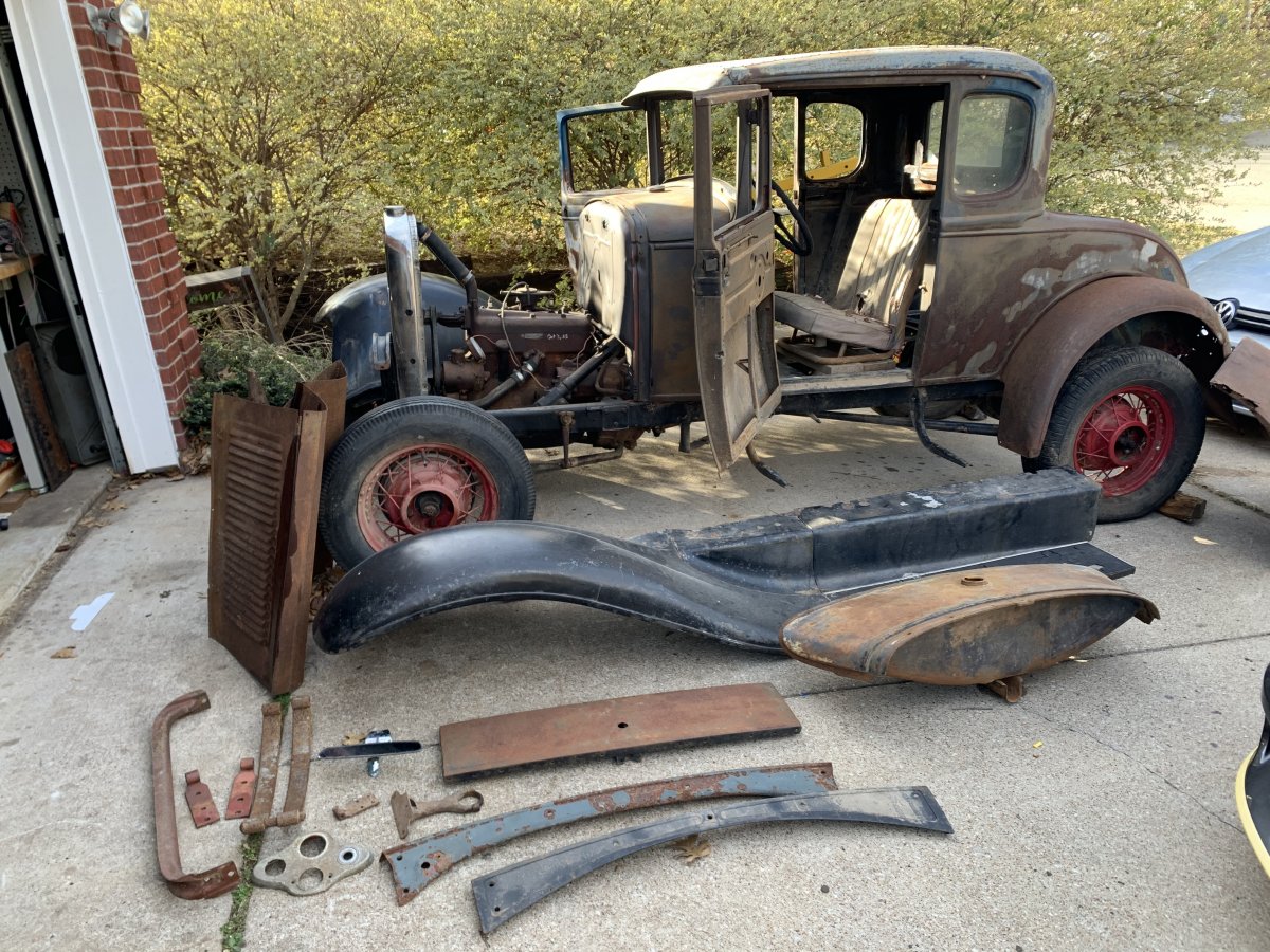

    I was able to get the driver door open. The latch guts are in both doors so you can reach down through the window opening and push them. The p***enger door is stuck fast so it's marinating in oil right now. The driver door opens easily, shuts tight and is fully square in the body. The p***enger door looks like it may need some help. The car was hit on that side and hastily repaired.
    The rear fenders are not as bad as I thought they were, though they have some booger weld repairs. They were the same color as the body at one time and the p***enger fender has a dent that's in line with the scar along that side of the body. They were left outside when the rest of the car was brought in to the barn, so they have suffered. The front fenders and splash guards do not seem to have come from this car.
    There are no linkages for the brakes at all. The levers they connect to are all there... just not hooked up.
    The throttle linkage was not hooked up, but the choke lever was fully out, so the ****erfly on the carb has been open, but it doesn't look too bad in there. Can't be worse than my V8 was when we started with it, at least as far as exposure to the elements goes. It closed easily when I adjusted the choke lever.
    I will need to redo all the wood inside the body. I think kits are readily available but not cheap. There is enough wood in there to use as a pattern that I think I can do it myself on my scrollsaw.

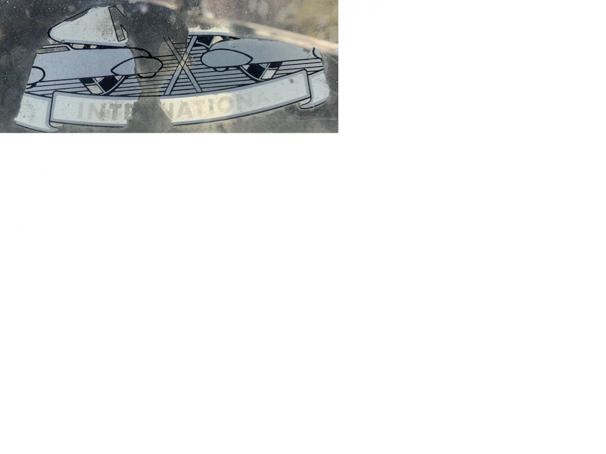

    Here's a close up of the sticker. Does anyone recognize it?

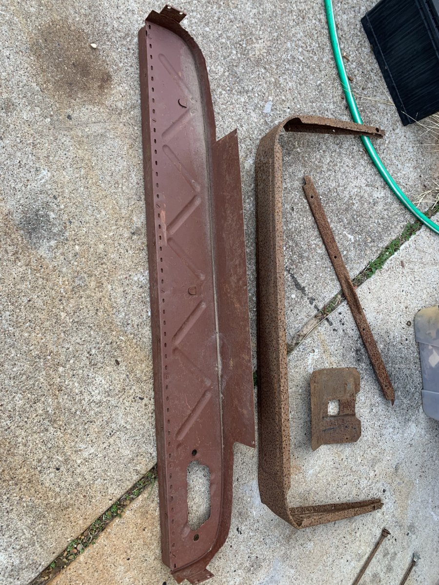

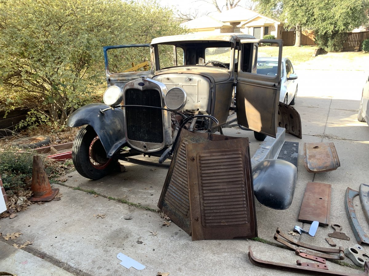

    Here's everything I got yesterday out in the daylight. I'm not sure what any of the metal bits in the last picture are for.
  13. J.Ukrop
    Joined: Nov 10, 2008
    Posts: 3,758
    J.Ukrop
    SUPER MODERATOR
    Such a great find. I’m know I’m not alone when I say I’m super excited for you. I like the ‘banger ideal for obvious reasons haha
    If I’m not mistaken, those metal pieces are the lower seat riser, the package tray and I think part of the floor.
    Looking at that decal, I’m wondering if it may have been some sort of drag car body. I’m guessing the rear window is gl***. If it were roundy round racing, wouldn’t they make you remove all the windows? Maybe see if you can find traces of other lettering on the body? Regardless, this is the best thing I’ve seen on the H.A.M.B. in a long time. Let me know if you need any help with the ‘banger!

    I can already foresee that fasteners are going to be a significant expense. Almost all of them were lost from one owner to the next.
  15. RodStRace
    Joined: Dec 7, 2007
    Posts: 9,790
    RodStRace
    Of course, for a true early build, you want original or old fasteners. You can haunt the local yards and gather up what you can find. Work out a deal for gallon buckets by weight if possible. Cheap, but time consuming.
    There are also restoration places that have the stuff, but that is going to be very expensive.
    Going to the hardware store each time is very time consuming too.
    I picked up a carry box full of common hardware (bolts, nuts, washers, etc.) from a local supply shop years back. It's gone up in price and while it's limited, it would be a great start for mocking up the car.
    Check your local suppliers to see if the have a similar kit. Look at the 97 hole kit. It's also very helpful to have it all in a portable carrying case!
    https://www.copperstate.com/shop/5637158370/portable-fastener-kits
    You can figure out what you need as you go and source the stuff needed. Having a bunch of clean, sorted bolts is very helpful for moving forward and developing a buy list. Return the stuff back to the kit when you have the final hardware for the car.
    chryslerfan55 and trevorsworth like this.

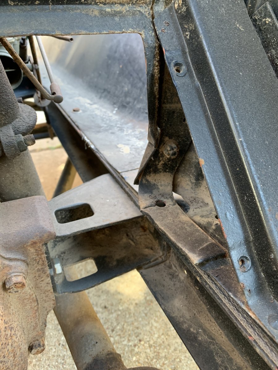

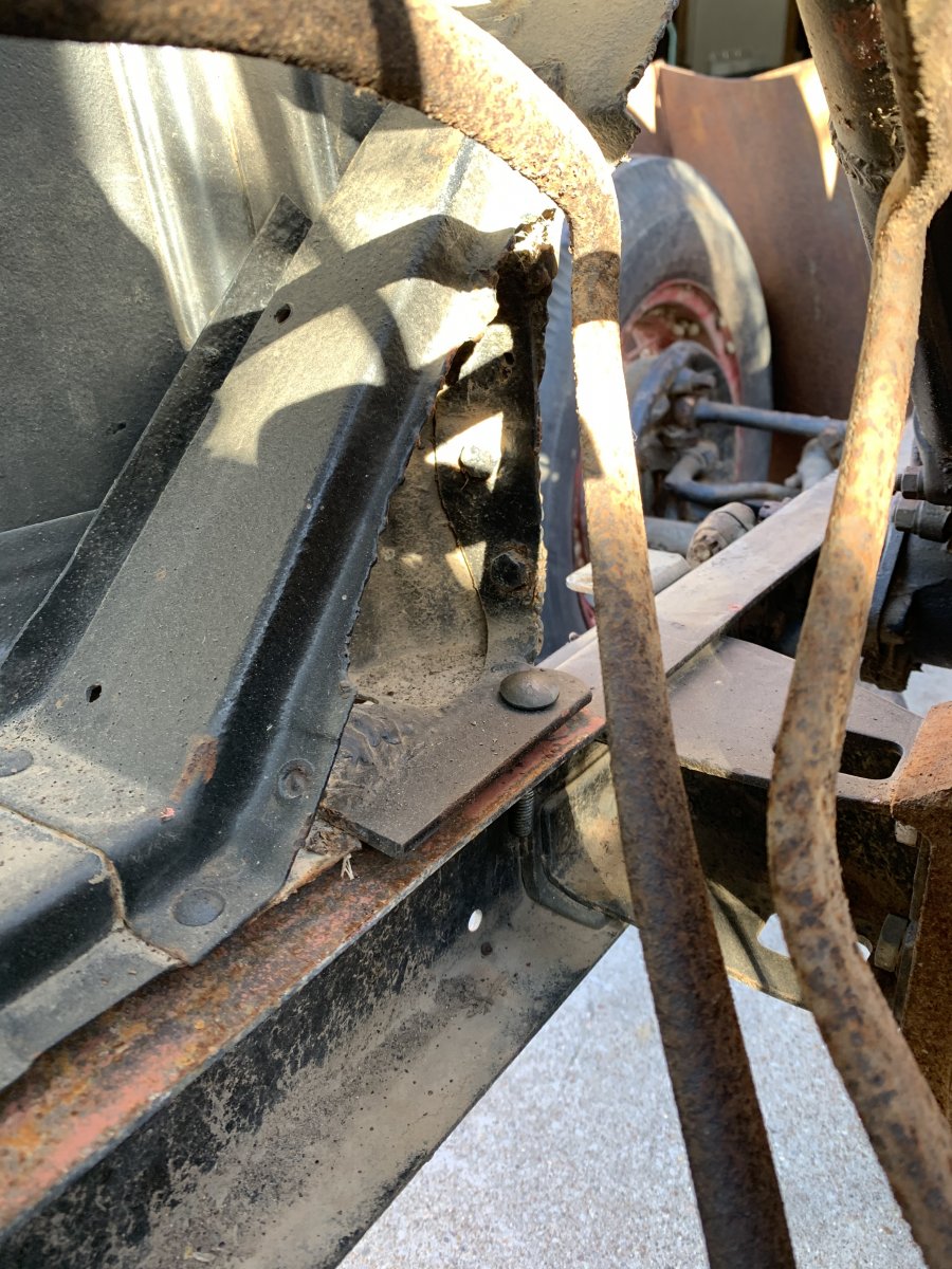

    I figured the first order of business was getting the body attached to the frame but I was having a lot of trouble getting the body lined up with the mounting holes on the frame.
    It looks like someone has jacked with the body mounts in the front; they aren’t set right for the A frame’s holes. When perfectly centered, none of them line up.
    Upon further inspection, I realized that a lot of the structure has been welded in. Only the four holes in the center of the body actually line up with the corresponding frame holes when it's sitting right. This thing was definitely a race car, and I'm guessing it was originally on a custom or later frame. I am going to have to cut the front mounts off and make up new ones, and also drill new holes in the rear.
    A slight h***le but a pretty cool clue to the car's history - this may have been an 11 second car at one time. (But with this workmanship, probably not.) Here I am making it lame and slow!

    I've read that the serial number is located just below the cowl on the frame. Before you get too bolted down, check to make sure the ***le matches the numbers!
    Price out the hardware kits too. They may not be too bad.
    Get catalogs for parts, again so that you know what new stuff prices are to judge the used stuff you find.
    I don't know who are the good guys, but here are some I ran across.
    https://modelastore.com/bolt-kits?product_id=12640
    http://www.allfordparts.com/shop/content/model-catalog
    https://www.brattons.com/catalog/current-catalog/current-catalog.html
    https://www.cl***icautopartsonlinecatalog.com/Model-A-Online-Catalog/Cover/#
    and of course, if you plan on buying stuff in 2021, check into a HAMB alliance membership and save money with the vendors who support this great site!
    https://www.jalopyjournal.com/?page_id=176

    The sticker looks to have crossed checkered flags and swoopy (not race or rod) style cars and "International". The 3 section lower banner could have _____ International Raceway, but that's just a guess and the car style doesn't scream "race", more "saloon". The covered tire spats would be more fitting of top speed (LSR) cars.
    A search found this,
    http://houstonfreewaydragstrip.com/houston-freeway-dragstrip-references.htm
    This site mentions a few other "International" tracks,
    https://dragstriplist.com/texas-f-o
    Odessa International Raceway (named such in 1975-76 under AHRA rules)
    Lubbock International Dragway (named in 1983)
    Edinburg International Racetrack (unclear when)
    Looking at the first of the three banners, the best fit (all caps) is the A at the end of Odessa, but it's not very legible, and looks like a rounded top, unlike the sharp top on the A in international.
    Having an idea of time frame and location would help. That decal could have been done over a few decades. The single "N" or "M" toward the top isn't much to go on.

    After taking inventory, here’s my current shopping list. This is ***uming the engine fires right up, the radiator holds water, the transmission shifts, and the brakes actually function... which is all very optimistic, but I’m not there yet.
    • Fasteners fasteners fasteners
    • Body blocks
    • Rear p***enger window garnish molding
    • Windshield frame (related parts?)
    • Door handles
    • Door guts (window stuff??)
    • Seat/frame
    • Trunk guts
    • Trunk lid skin
    • Brake linkages
    • Gas pedal (whole ***embly?)
    • Headlight guts
    • Welting
    • P***enger side door middle hinge
    • P***enger side cowl skin?
    • Gl***
    • Hood center rod thing
    • Crank handle
    There are window regulators, but I don’t know yet how complete they are or if they work. No windshield frame sadly. The previous owner said he is pretty sure it came without that garnish but if it turns up somewhere he will ship it to me.
    I spoke to the seller, and he said that he knew nothing of the body’s history. However, according to the ***le, it came from La Grange... which is kinda fun.

    So, I've been thinking about the car's history. As I was eating my lunch, I thought back to when NASCAR sanctioned quarter mile drag racing from the mid-'50s until the late-'60s. (More info can be found on this thread here). Well, looks like you may have remnants of an old drag car after all? Screen Shot 2021-01-18 at 12.28.31 PM.png

    Whaaat??? That’s *****in! I cant wait to get home and dig in!! Thanks dude! Here’s the version of the sticker that I have, from that thread:

    Just to expand on the sticker, those wouldn't necessarily be just for participants, but possibly for pit crew and fans too. Go to a modern race and a lot of those stickers will be out in the parking area. Post up some pics of the internal bracing. The body mounts alone don't really mean much.
    Engine or ch***is serial number, not body number. So that doesn't track where the body was located.

  29. Looks like a pretty solid and very cool project.
    People will tell you that you need to box or swap your frame for the v8 conversion, not necessary unless you're going for major horsepower... unlikely with an 8BA on a tight budget. My '31 is pretty rowdy and still sports the original frame, no issues. If you start with the banger, then want to convert to the v8 you'll end up doing a bunch of stuff twice and paying for it too. Start with the flathead IMO.
  30. It looks like the body-bolt pads have been scabbed in at some point in time, probably to reinforce the lower body for a racing application, which just needed to hold it together. I would check ***embly manuals, restoration books, and body sheetmetal vendor sites to determine what they should be, and rebuild/replace as needed. Start by getting the body back to square one, and it will make your life much easier and your build much nicer.
    chryslerfan55 and flatford39 like this.
