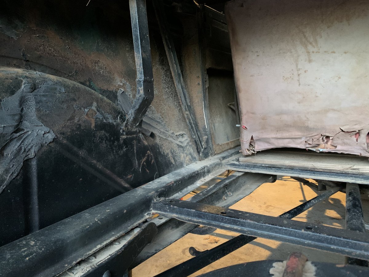

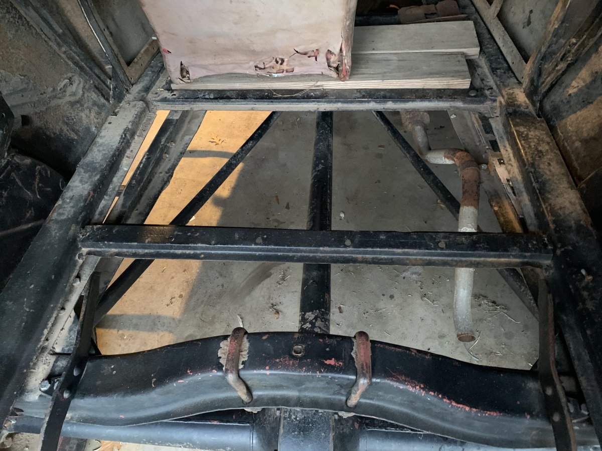

    As requested, here is a look at some of the reinforcements that have been welded in. These booger welds certainly look old school.
    42CD73C7-F8AD-4F96-AAEF-69EC557FF9EC.jpeg 1DA45E78-C9BD-45AE-953E-9ED288161856.jpeg
    The firewall has been torched to clear a different steering column and the package tray has also had a chunk cut out of it but I'm not sure what for. To me it seems to have all the hallmarks of a rush job race car body, but it's straight and square, so I'll take it. The history is a sweet bonus.
    Thanks everyone for lots of pointers on multiple subjects. There's a lot to digest and I'm filtering through it all right now. To say I'm psyched about this thing is an understatement. I'm not going to start jacking with the body until I get some books in my hands, and some expert eyes on the car, but I think I know how I'm going to attack the body mount problem. In the meantime I am very interested in getting the motor to run. I was able to pull it up into the garage today - it's supposed to rain for the next week. It's cramped in there but that's OK, at least it'll be dry.
    As for the ***le questions, no, the number on the ***le doesn't match anything on the car. But that can be fixed. I'm told it came with the body, but in Texas, nobody really cares. The DMV told me just to put the ***le's number on the car somewhere, so that's what I'll do.
    I'm not planning to box the frame, even for the V8 - I'm not sure I could ever afford to hop up that 8BA enough to twist the stock frame. Boxing the frame is cool and traditional but ultimately pointless and puts the frame at risk of warping or cracking. Plus, it creates corners all along the length of the frame rails that will trap water and dust.
    I know I will spend more over time if I start with the banger and later swap the flathead in, but I want to drive this thing yesterday and since I have never driven a Model A this will help me make performance decisions when building the V8 ch***is later. I have no idea how long it will take me to build up the V8 ch***is - I'm guessing a long time - so I'll focus on this for a bit.

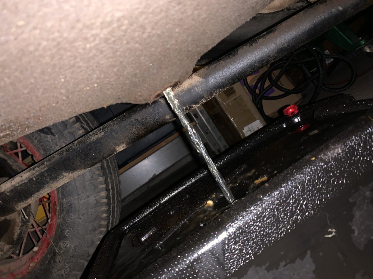

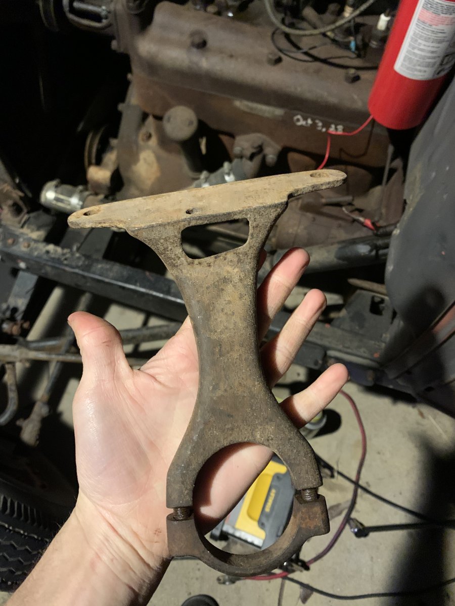

    When we went to bolt the steering column to the gas tank, I noticed something.
    This is a very good gas tank, but someone has cut the steering wheel support off. I got another tank with the car, which is probably not any good and maybe not worth trying to save, but it has the bracket. Can I cut it off and weld it onto the stub on the good tank? I'm not sure if it will weld good.

  22. flatford39
    Joined: Dec 3, 2006
    Posts: 2,799
    flatford39
    Congrats....use the the late 31 steering column bracket. It's a great improvement to the gas tank mounted one.

  23. trevorsworth
    Joined: Aug 3, 2020
    Posts: 2,057
    trevorsworth
    Oh, that’s lucky. Had one of those in the spare parts pile.
