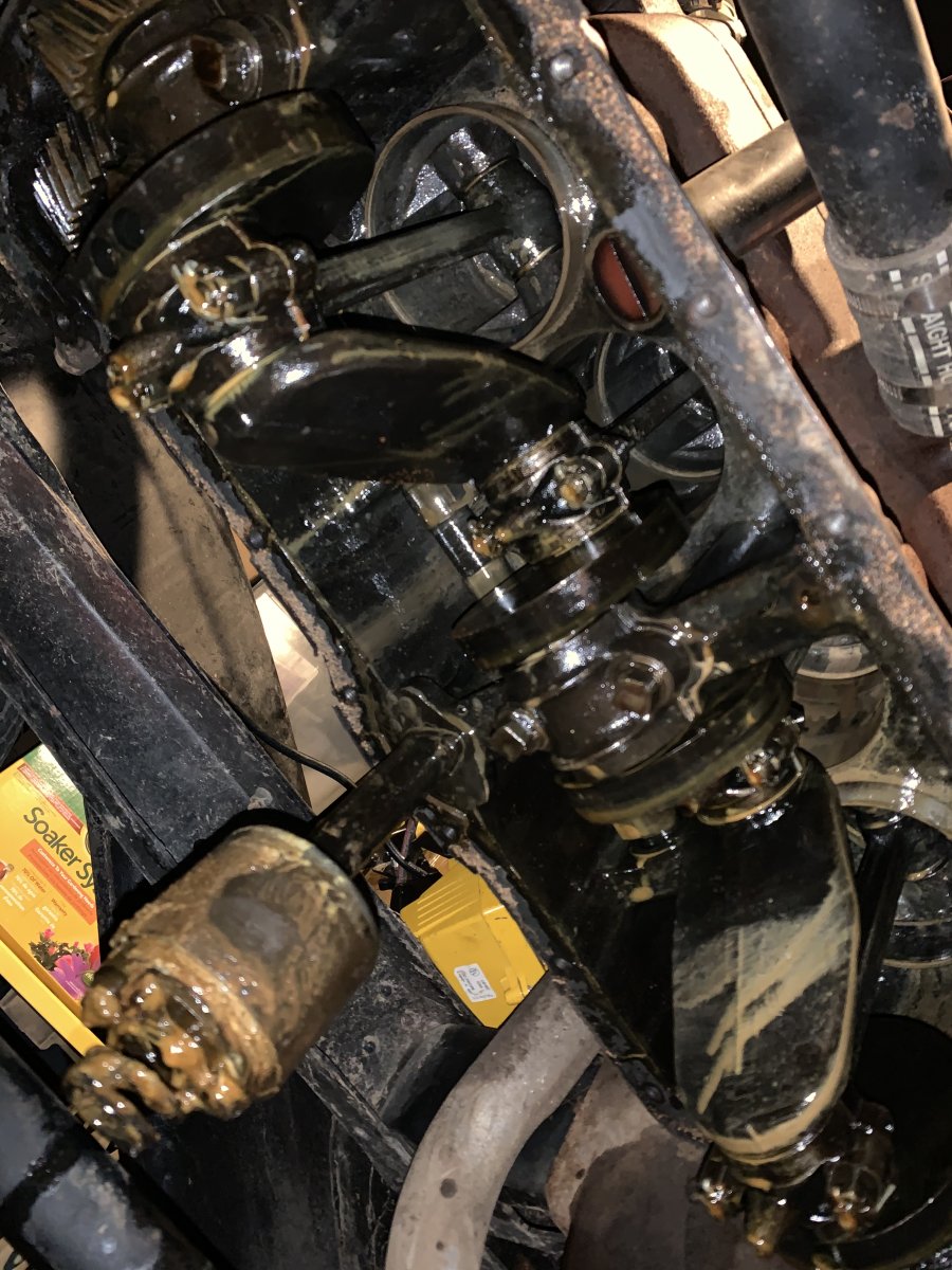

    Doesn’t look too bad. Fresh oil and go for it?
    chryslerfan55 and RMONTY like this.
  29. milosmith
    Joined: Aug 27, 2020
    Posts: 103
    milosmith
    The oil on the crank looks milky. I see some of that milkiness in the cylinder bores, but the bores are nice and bright under it. The bores and rods would have flash rusted if the water was sitting in there for a while. I think the oil was pushed up in the bores when you ran it briefly - not introduced from the top down. I think you're ok to wipe it down, add fresh oil and water, and hope for the best... Worst case you're out 3-1/2 quarts of oil. You'll get a lot of white smoke in the exhaust with all that water in the exhaust..

    Pan is cleaned out. Just need gaskets and a rope seal and I'll be ready to reinstall it. In the meantime going to wipe down everything I can reach from the bottom and hope oil circulation & oil changes take care of the rest. Hopefully it'll be OK for a few days until the gaskets get here and not start rusting now that it's exposed to the air.
    The old gasket was leather & was affixed to the pan with what could only have been rubber cement.
    What a shame this engine was allowed to flood like this. It's really nice in here!
