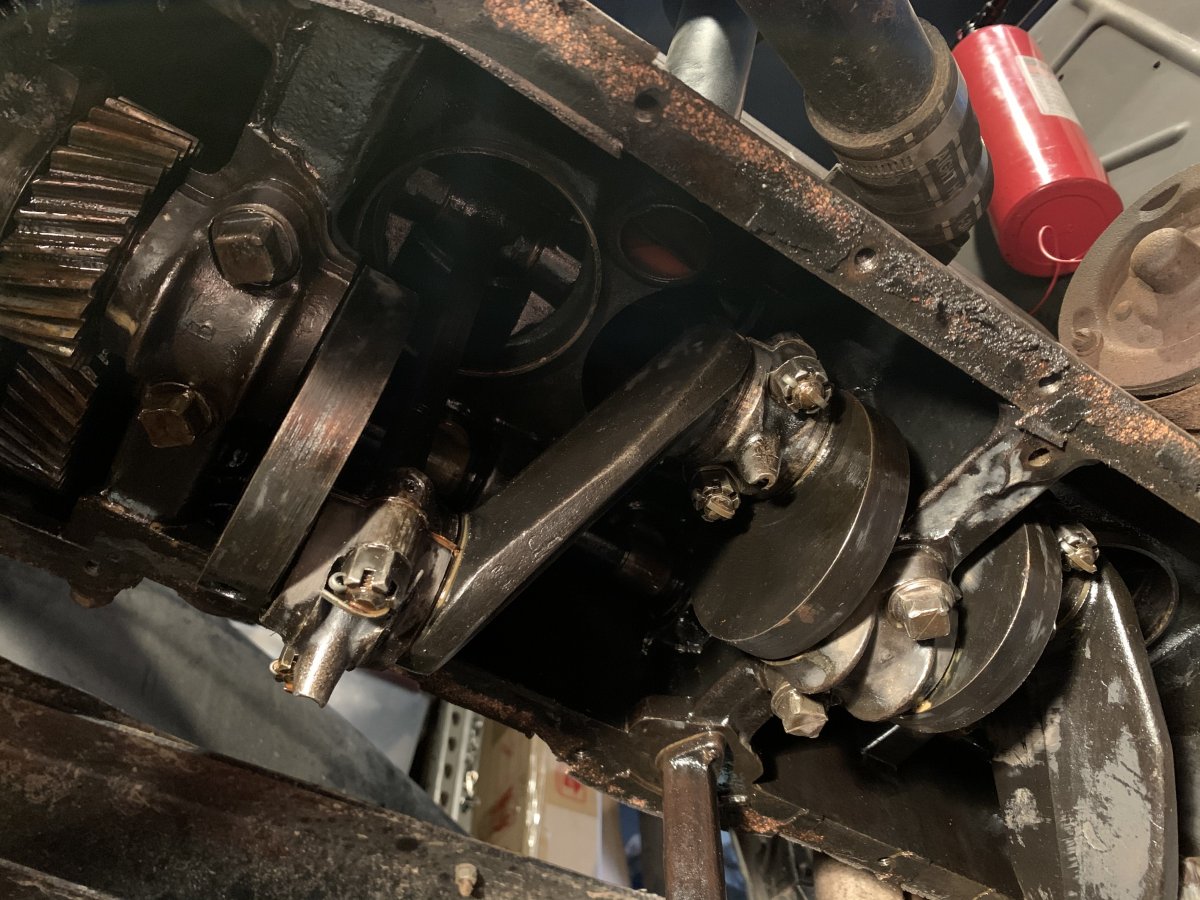

    Yeah, that 'milkshake' is oil/water mix and not great. Clean everything especially the pickup.
    While the pan is off and waiting for gaskets, fill up the radiator and look for leaks.
    EDIT: just saw your latest post, good to go!
    I'd also rotate the engine after filling to
    1. Make sure you don't have water above the pistons from a head gasket
    2. Look at each cylinder wall below the pistons to make sure they are good and clean and don't have a crack leaking water.
    I'd spray it down with a good oil (NOT WD-40) and wipe off just before the pan goes back on. That engine rebuild video shows a pretty complex pan gasket install. Hope yours will be easy.

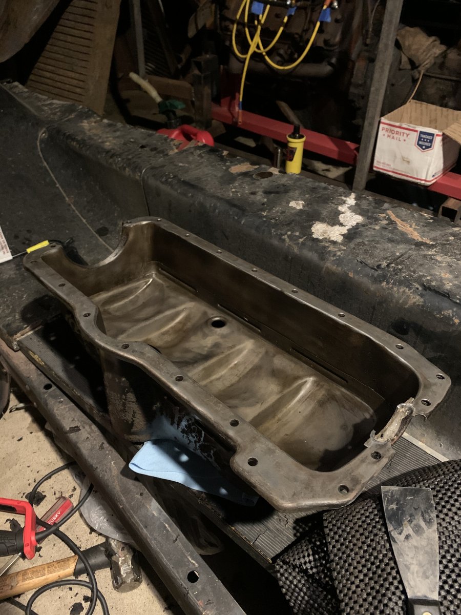

    Now that looks better.
    The pan install looks like it will be a *****, but oh well.

    If you don’t have any obvious cracks I’d say you are in the clear, those blocks are surprisingly strong and it looks pretty good inside in the pics. While you are in there wiggle the rods and verify they don’t rattle on the crank journal. If they do just take the rod cap off and peel off a shim- they were there to adjust worn rod bearings, and the main caps

    Rod caps are great! No wiggle to speak of. I am thinking this engine was rebuilt at some point already.
    The oil pan reinstall looks like it will be a little tedious. It's a pretty tight space back there. I think I'm supposed to remove this bellhousing inspection plate to give myself a little more room.
    S****ing this old gasket material off ****s, but I'll have plenty of time to do it. Looks like the new gasket won't be here til Feb 2. Is there something I can let this soak in to make it easier to get off?

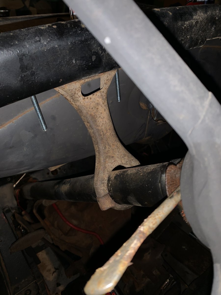

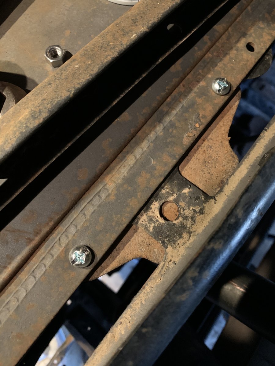

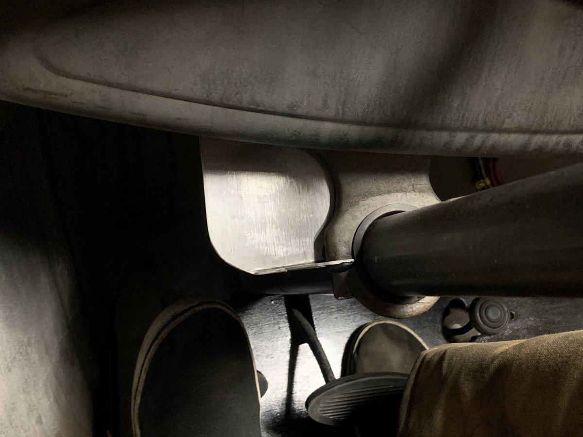

    I don’t like how the steering box behaves when the wheel is turned while unsupported, so I went ahead and fixed it up with some ugly machine screws I had sitting around. I will replace these with pretty screws when I have the money for such frivolous things.
    Two questions: The center hole on the column totally does not line up with anything on the dash, what gives with that?
    Second, is that it? The column just chills there with a half inch gap above it? I feel like I’m missing something but I can’t find anything in the restorer books.

    Trevor, I'm running the earlier-style column drop on mine, so I'm not sure about the alignment question. That gap was a mystery to me too, but I ended up figuring out that you need to run a rubber gasket. I think the guys at All Ford in Campbell *steered* me in the right direction? Oooh. Anyways, your best bet is to break the bank and get yours here. Below, you can see how mine is setup feat. the latest trendz in garage fashion.
