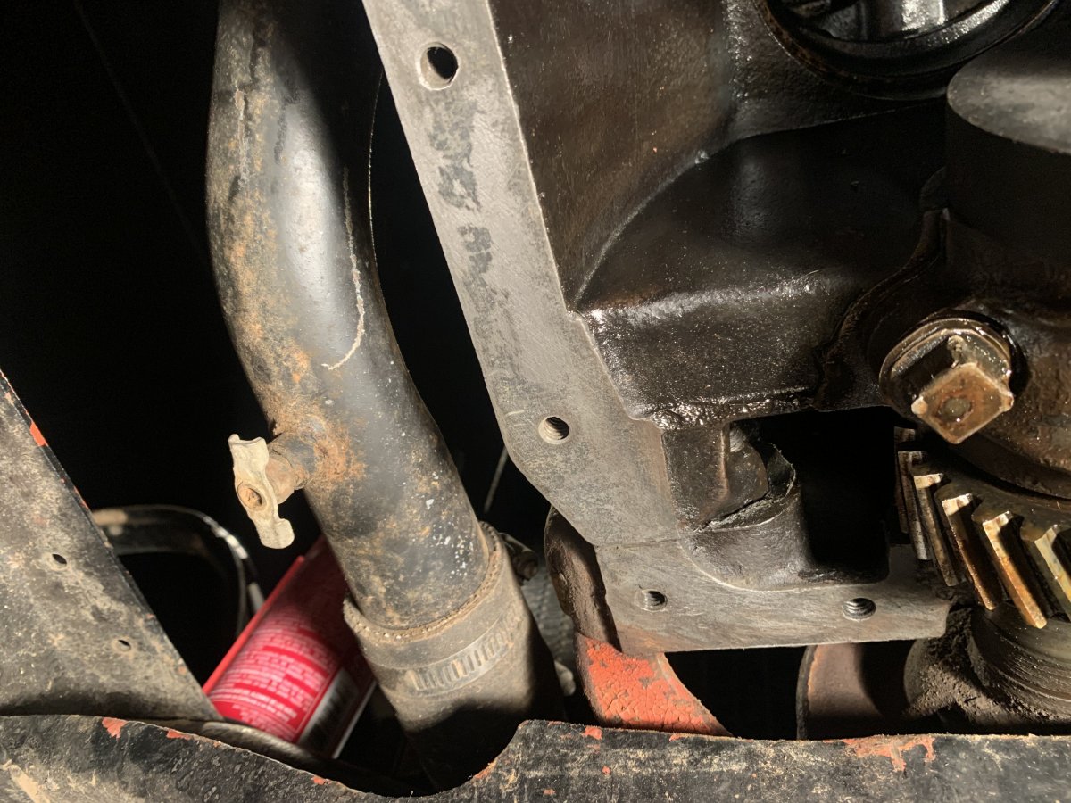

    How clean is clean enough for this surface?
    This is as good as I can get it. There is still some gunk but it is smooth to the touch.
    J.Ukrop and RMONTY like this.
  6. RMONTY
    Joined: Jan 7, 2016
    Posts: 2,668
    RMONTY
    It should seal. Looks good from my vantage point!
    trevorsworth likes this.

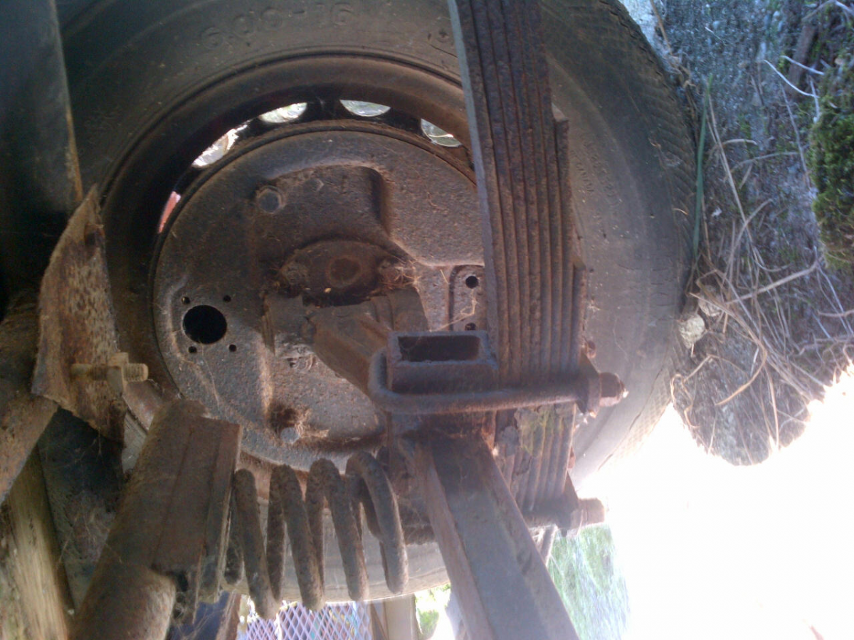

    the ch***is...no worries don't go to too much trouble pics of juice brake b/p's abound but pics of mechanical b/p seem hard to find...I'm trying to determine if a set of wide 5's I have are '37-8 mechanical or '39 juice the pic you posted showed it from the inside but I need a shot of the back...

    Here's a back shot of '37-38 mechanical brakes.
    Nailhead A-V8 likes this.

    Thanks that's very helpful...I have confirmed these are '39 Juice B/Ps what you need if going with wide 5s

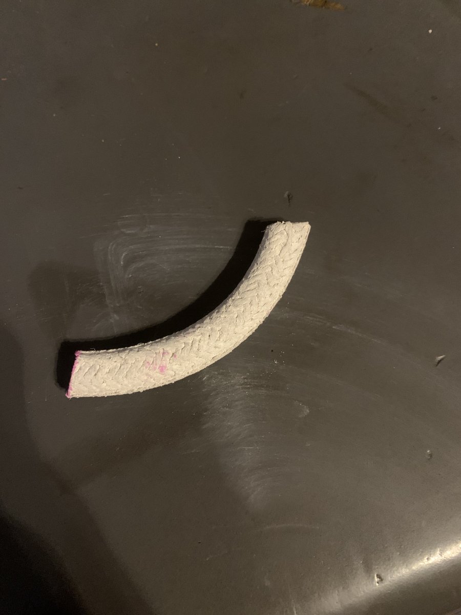

    Knock on wood, my house seems to have run out of ways to fall apart for now so I'm going to try to get the pan installed today and tomorrow. Still anxious about this 4 piece nonsense but I guess if I screw it up I'll just do it again until it's right.
    This is the rope that was provided with the kit. I have been told that some need to soak in oil first and others do not but I don’t know how to tell if one needs to soak or not. It is covered in a chalky substance and is dyed pink at one end. Any thoughts?
    As an aside, I hope everyone understands that I ask some of these basic questions to double check myself because, having never done any of this before, I just have no frame of reference for what’s right and what will work, not because I will need my hand held forever. ;)
