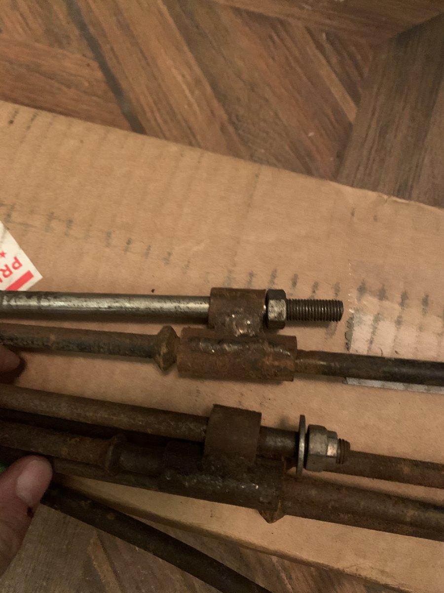

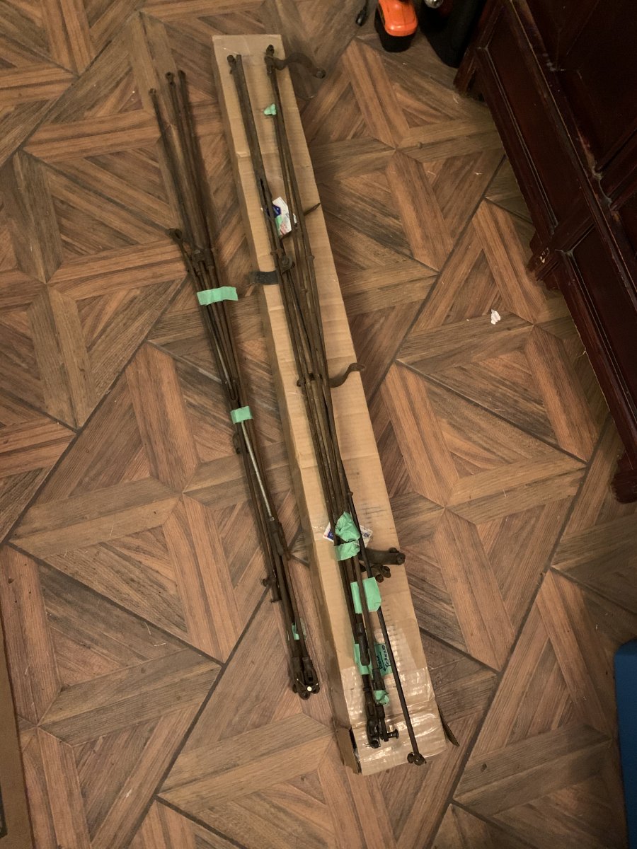

    I scored two sets of A brake rods from fellow HAMBer @lake_harley. One set has some interesting “custom” work in the form of a sliding linkage, which we think is set up to operate the rear service brakes with the emergency brake handle. Any insight as to why this may have been done?

    My guess is the car those rods came off of had sketchy brakes, the previous owner was trying to get all the braking power it could muster. B+ for ingenuity but not what Henry had designed

    Also you will find mechanical brakes really need to be within service limits and adjusted correctly to function. That includes straight brake rods and no slop in the system. The next hurdle with them is the factory drums which are stamped steel. Unless it’s NOS drums they’ve been turned a time or two in ninety years and even then they can grow when they get hot causing fade. All that said they are adequate just don’t drive like you have power discs on all four corners

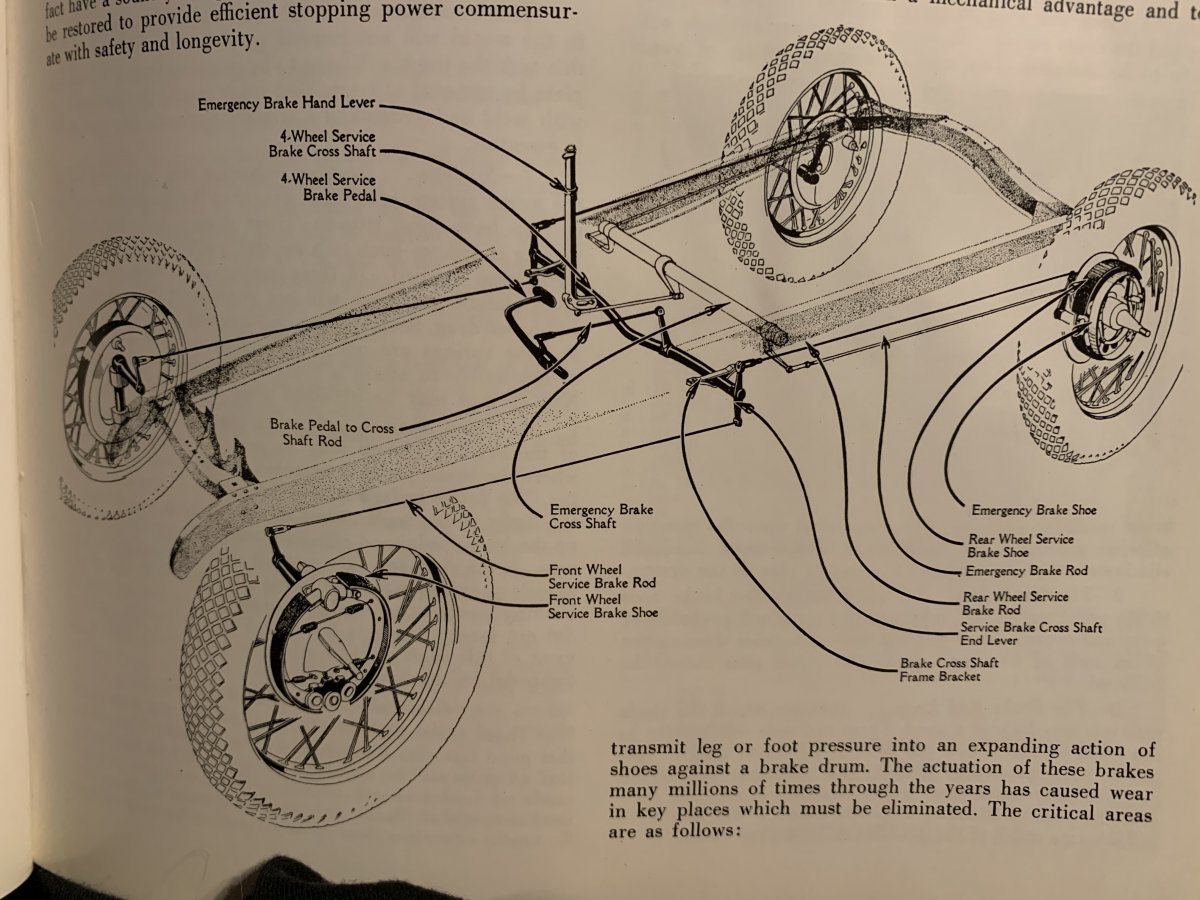

    It's looking like it's not going to be pleasant hot rodding weather any time soon so I think I am going to **** it up and put the brake rods on when I am off on Saturday, during which it will be a balmy 16 degrees. If I go ahead and get that out of the way and I can get it to sip gas from the carb, I can spend the next warm day bombing around my neighborhood instead of wrenching.
    Should I just throw the rods on as they are and adjust from there or should I put the clevises all at some "default" adjustment before installing? I understand that adjusting the brake rods just means taking the slack out but I'm not sure what best practice is for starting from scratch.

    you need to have all 4 brake return springs on hand, as i think the rod goes thru them if i remember correctly. i think in the catalogues they give the rod length, so you could figure out what the deal is with the modified ones, and weld them up to the correct length

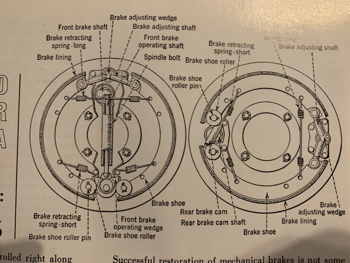

    Can you tell me more about the four return springs? On the diagrams I have I don't see any springs in the part of the system I'm working on. Also, no springs are mentioned in the brake parts lists other than the retracting springs. The only springs I know of are inside the drum. I thought it was strange that there were seemingly no helper springs on the rods or pedal. I was under the impression that a pedal return spring was an aftermarket piece and neither necessary nor recommended. Of course my car came with none of this and I have not examined the brakes on any living As in detail, so all I have is the diagrams in these restorer manuals to work off of.
    Here is what I’m looking at. In comparing these to my car, it seems that the rods themselves are all I am missing. This ch***is was built up from parts of several cars so either it never had rods as it sits or they were lost in between owners after someone removed them while tinkering.

    on each rod there is a bump about in the middle. that bump hits a spring. 2 types, a flat piece of spring steel, and one that looks more like a spring bent weird. 28-29 vs 30 31, sorry cant remember which is which, but i do prefer the one that looks like a spring, the flat ones seem to crack. there is a small angle bracket that is riveted on the frame that the spring bolts to. originally no spring on the pedal as you would think, however they do sell an aftermarket one for folks that have the brake light sticking on

    Ah- I do have several flat springs on the rods which were described as anti-rattle springs. I didn't realize those were part of the system beyond keeping the rods from, well, rattling. Now it makes sense. Thanks!
    I am surprised that none of the diagrams and seemingly none of the text make mention of these springs, they are obviously important. A lot of resources for these things make the ***umption that you have some experience already and that makes things kind of tricky for me.
    A set of new flat springs is not expensive ($11 on Mike's). I think one of mine is toast. I found a picture of the wire spring ones you described but I'm not seeing any for sale, repro or original.

    Also there is an adjustment procedure once you get the rods on, it involves a board with notches in it that wedges between the seat riser and the brake pedal, notches against the pedal. For now you could adjust by feel to putt around the neighborhood. Maybe Jack the rear wheels up and check that the E brake works for extra insurance

    If it were me, and given that these are mechanical brakes, I would "spring" for all new springs.....sorry, I couldn't help myself on that one. BLAME IT ON THE ICE AGE IN NORTH TEXAS!!

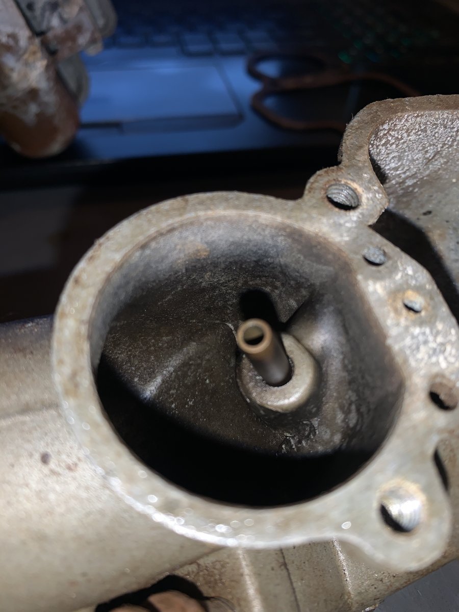

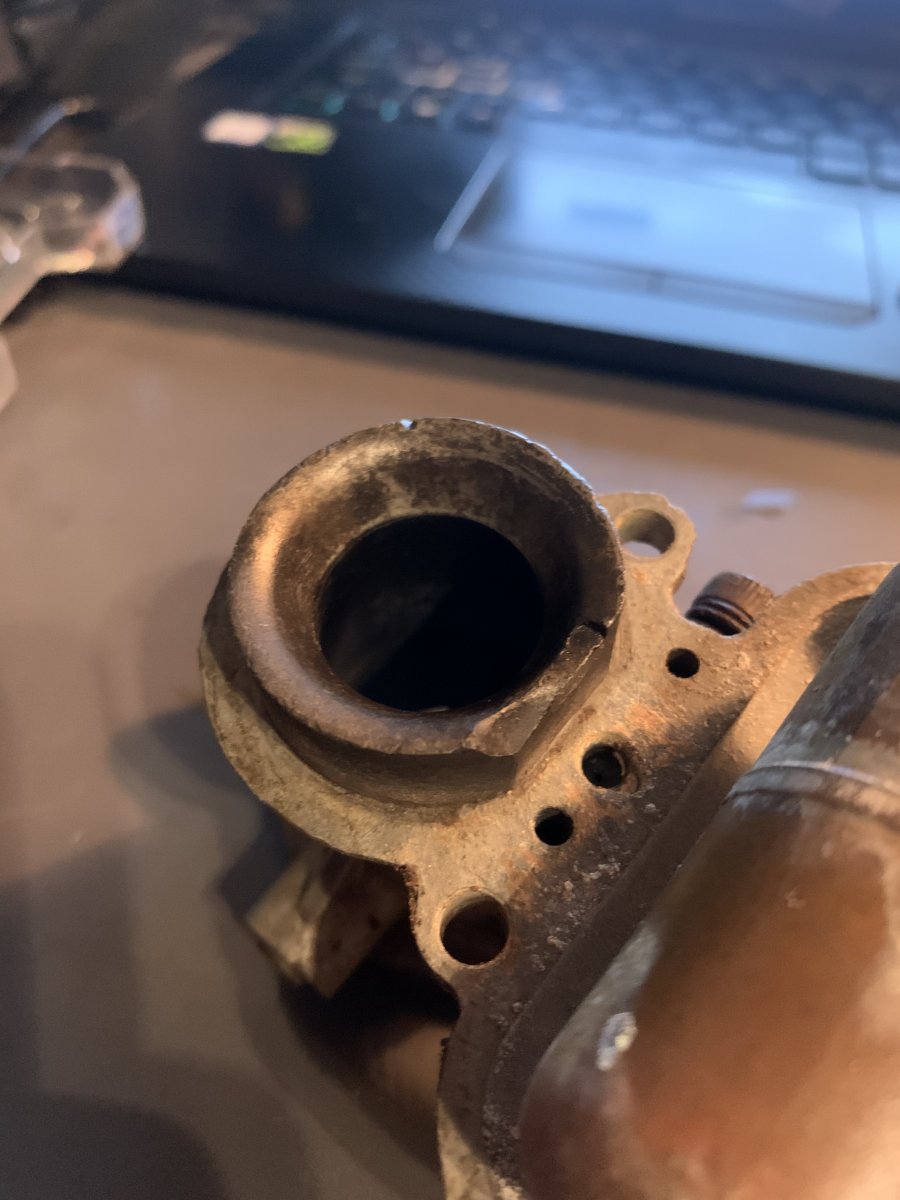

  22. trevorsworth
    Joined: Aug 3, 2020
    Posts: 2,057
    trevorsworth

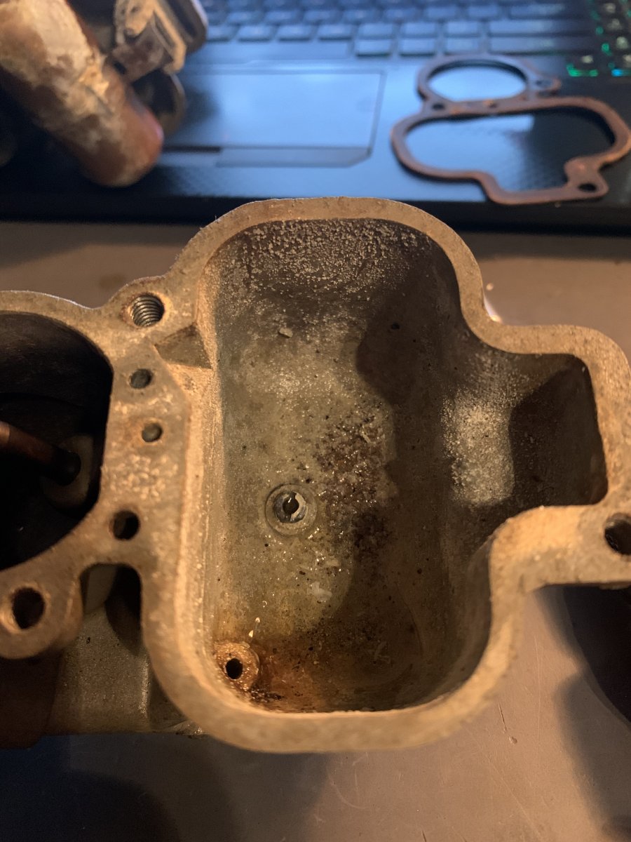

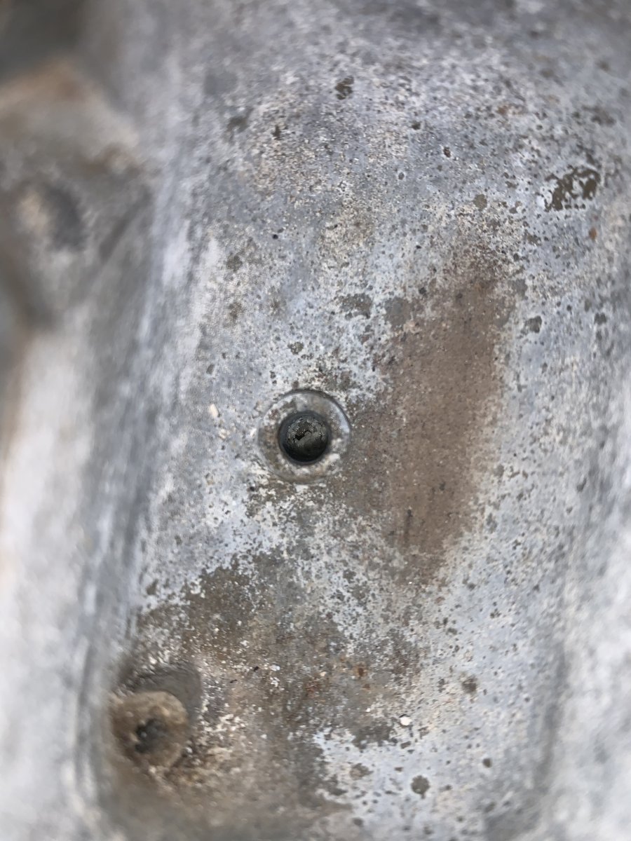

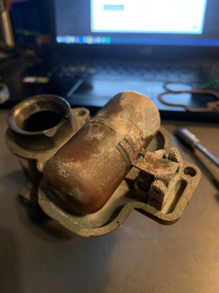

    All my gusto for installing the brake rods today evaporated when I walked into the garage. There is no way my little heater is going to make that bearable, so I brought the carburetor in and I'll tinker with that instead. Here’s what I see.
    This big copper pontoon operates a ball valve that shuts off fuel flow when the fuel level in this chamber reaches a certain point.
    Everything in this chamber is covered in an unattractive crystalline mineral deposit. But there seems to be no blockage in this p***age, so it must be somewhere down the road.
    The rest of it is pretty clean and I was able to save the old gasket. Not sure if it will seal when reused but I’ll try it.
    There’s the problem! The jet was also completely plugged. The p***age is pretty bad so I am soaking it right now. A little bendy brush would be nice here.
