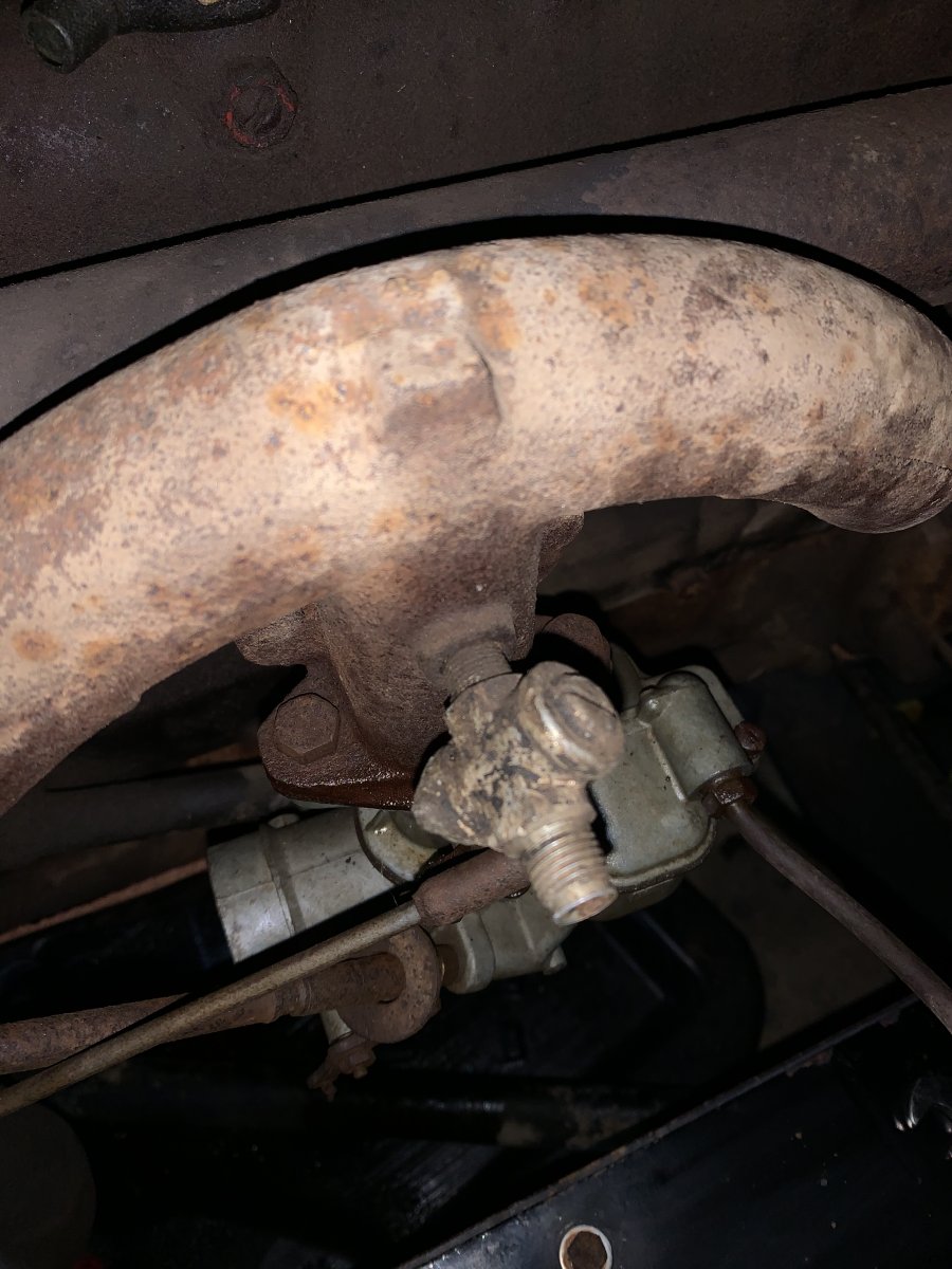

  10. trevorsworth
    Joined: Aug 3, 2020
    Posts: 2,057
    trevorsworth
    Yall reckon the open vacuum port tapped into the intake manifold might be the culprit??? :rolleyes:
    I looked straight at this thing over and over and somehow never focused on it. I think there is a leak between the carb and manifold too though - it looks wet there.
    My question is - could a vacuum leak like that cause the engine to heat up that fast? More air = more hot right? Once it cools down and the battery charges up I'm gonna plug this ****er with my thumb and see if that helps. Right now it's too hot to touch.
    So far no signs of oil in the coolant and it is smoking considerably less.

  11. rusty valley
    Joined: Oct 25, 2014
    Posts: 4,428
    rusty valley
    thats the problem ! it needs an 1/8" pipe plug. i'm surprised it started.
    trevorsworth likes this.
  12. trevorsworth
    Joined: Aug 3, 2020
    Posts: 2,057
    trevorsworth
    I actually don't feel any suction when I cover it with my thumb while it's running - I think it's plugged with gunk so I'll just remove it and replace it with an actual plug. However, this time, standing on the p***enger side of the car, I heard the whine coming from the carb that I've read means there's air getting in between the halves, so either it is warped or the gasket is no bueno (or, my luck being what it is, both). I am certain there is a leak between the carb and intake manifold too. Fortunately I have the gasket for the carb/intake and can probably easily make the one for the carb itself.
    If the Tilly is roached, I will go ahead and pick up a downdraft intake (once the money works out). That is on the agenda eventually regardless but I would like to wait if possible. If the Tilly forces my hand, I have a good Stromberg 97 on my V8 that I understand should work fine if re-jetted for the application, which will pair nicely with the head I have in mind down the road.
    The good news is that the smoke appears to have cleared up completely!
