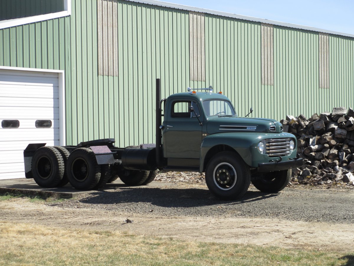

    That's a beautiful truck...what kind of brakes are on it??? Did they have air brakes ten or were they still hydraulic?

    I don't really know about the brakes, but he has an F-1 to match. IMG_6790.JPG
