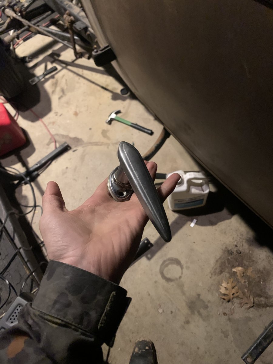

    Decatur swap meet was kind of underwhelming, but I was able to meet up with Randy and make some new friends. I got a great throttle control ***embly which, while I was carrying around, a guy flagged me down and asked if I was looking for Model A parts. He turned out to be a great dude and gave me a bunch of stuff, like body blocks and most of a coupe seat. I did not get the metal frame for the seat but I got the cushions (plus an extra) and wood bits. I figure I can make something work out of this and if not, well, free is free.
    I also got some door handles. The guy I bought them from said they were '32 but I'm not sure. These look nice but I think I will have to cut the shanks down to be able to use them.

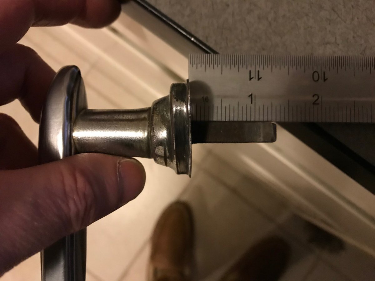

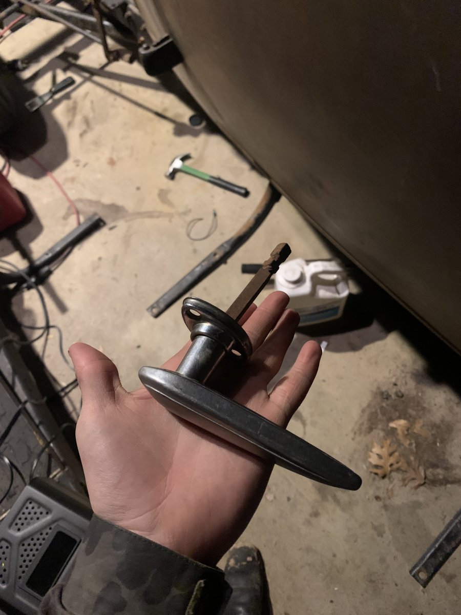

    C415C5D1-11D6-4854-A7A8-197438E93CCC.jpeg AE7EEE37-FB02-499A-AFD2-1FD3291BCF1C.jpeg
    I got a matching pair of these. I like them. The shank seems to be way too long for my A’s latch mechanism. I think whatever these came off of had a handle on the inside that attached to the other end of the shaft. I don't see why I couldn't just cut them down.

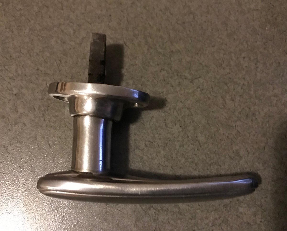

    The square drive end is indexed to the handle position. Before you cut them down check both to see if the clocking of the handle would work. The one in your picture should work - hopefully the other matches. Below is a picture of the door handle from my '34 pickup.
    See how the top flat is aligned to the handle? Yours might be 45 degrees off, leading to the handle not being flat when the door is closed...
    I do have a third matcher to the one in your picture that may have already been cut down.
    I think Tudors and Coupes of this vintages used the same door latch mechanism as a pickup so you need at least an 1-5/16" long drive stub. If you need a third one, let me know and I'm happy to send it your way at no cost...

    Thanks, that measurement is super valuable. I'll cut them down to 1 1/2" and trim it from there.
    The shaft is square to the handle on both handles. The second handle is missing the screw plate unfortunately but for what I paid I'm not going to complain, I will find something that works.
