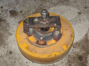

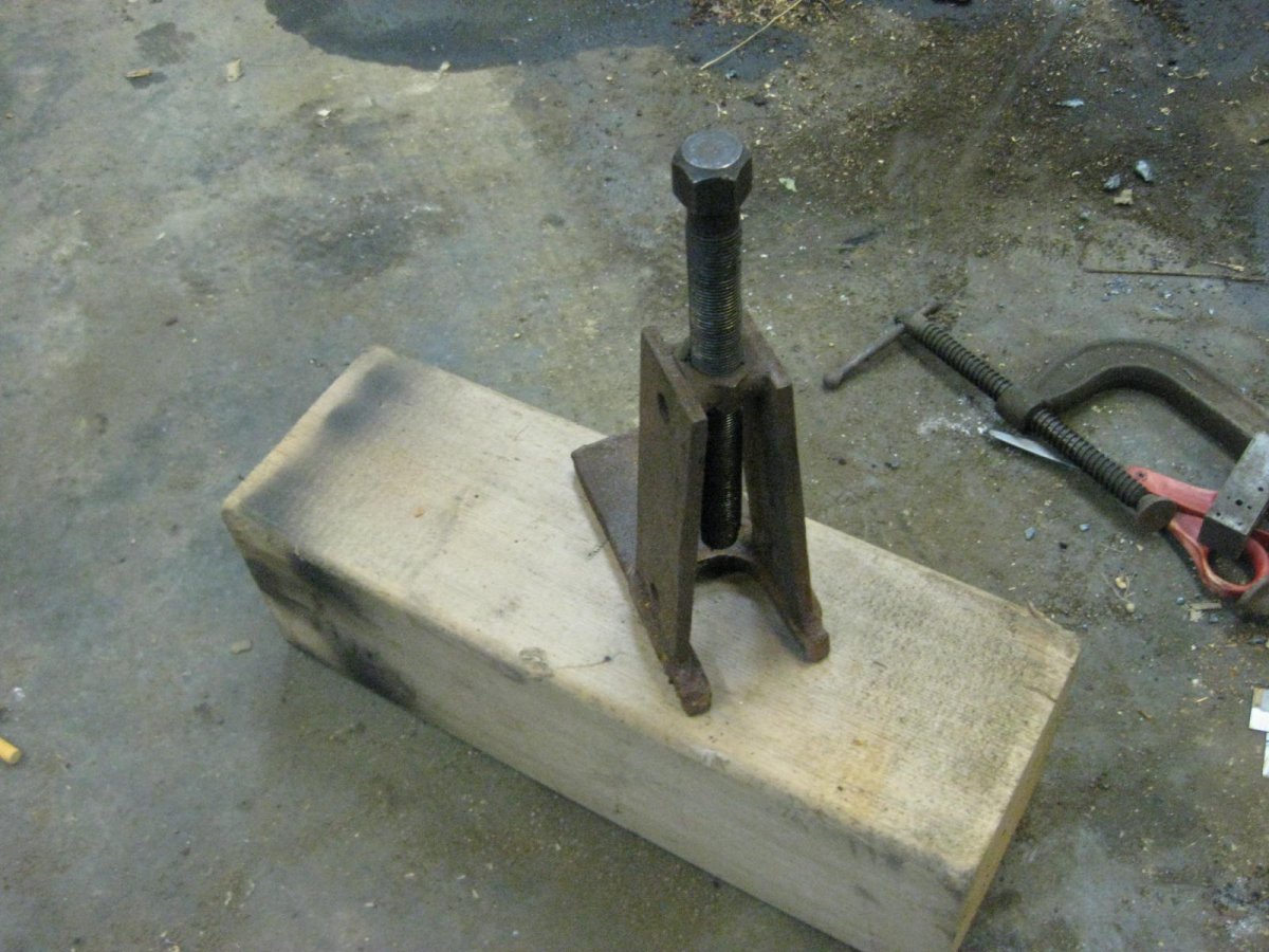

  19. rusty valley
    Joined: Oct 25, 2014
    Posts: 4,428
    rusty valley
    If you have a welder and cutting torch, here's the home made one i made many, many, years ago, never failed me yet. used a threaded shaft from one of my other pullers, a long fine thread nut, like from a rear end U bolt, and cut the notch so close tolerance that you have to hammer it on. 3/8 thick i think. IMG_1172.JPG

  28. RMONTY
    Joined: Jan 7, 2016
    Posts: 2,668
    RMONTY
    Lots of interesting versions....I believe I could make one of these versions easily.
