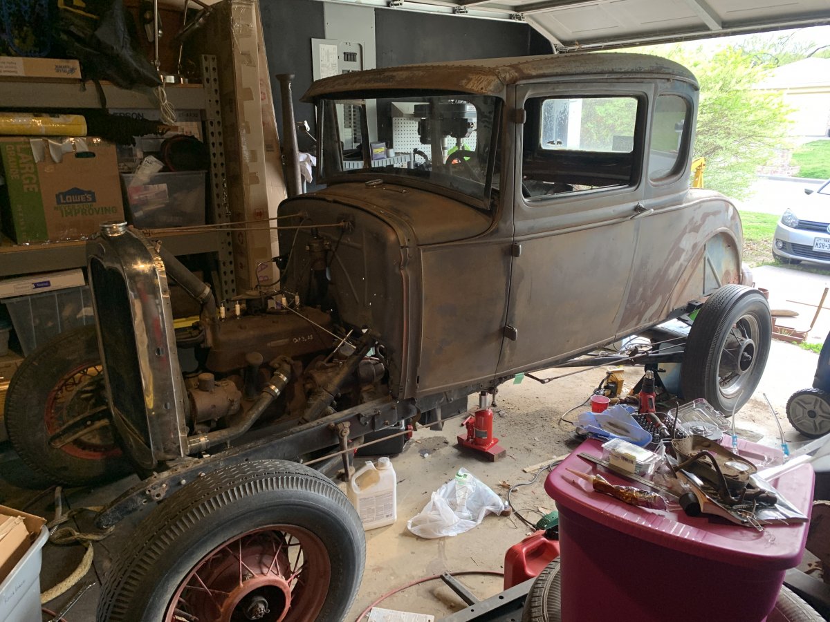

    It’s been a very busy few weeks! I have piles of stuff I haven’t installed yet, but I’m hoping to find time this weekend. Today I went over and wired Brian’s ignition. He has a really clean V8 install in his Tudor, and it was a real treat to get that close and see how everything fits together. Unfortunately the motor ended up having some issues that will need to be sorted before it will run, but I think I did a pretty good wiring job for him!
    As promised, he gave me a ton of stuff from his stash. Unfortunately- this is becoming a theme - the seat I got from him doesn’t fit. It seems that it must have come from a Fordor, but it has coupe side panels, sooo...
    I’ll get more into the parts haul tomorrow, but I couldn’t resist throwing this on as soon as I got home.

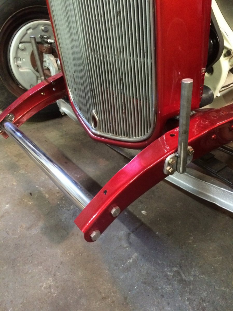

    I’ve been busy building a shed to house my growing pile of parts, but yesterday my headlight stands showed up. I am planning to make my own but I wanted a quick and easy way to put the stock headlights on the car so I could get it inspected and street legal that much faster. My help for the shed hasn’t got here yet so I figured what the hell, let’s mount the headlights. But then I ran into a problem.

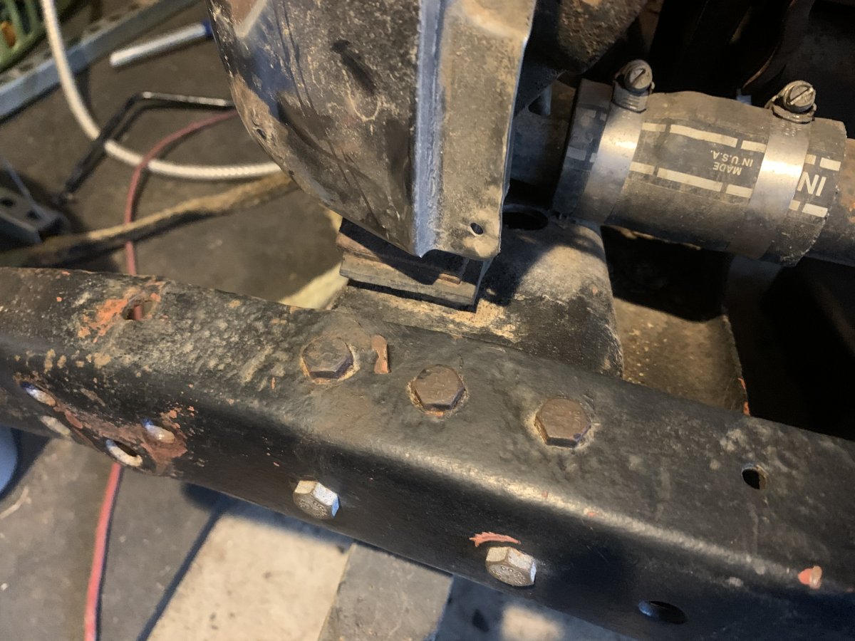

    I have previously noticed the front crossmember on this frame was bolted in as opposed to being riveted in like my other frame, but only now do I realize that these bolts are interfering with the obvious mounting location for the headlight stands. I guess I will have to make my own stands to mount to the side of the frame instead of the top, or maybe I’ll just weld the crossmember in and fill the bolt holes.

    Can you make a small adapter out of 3/16th plate to bolt in between?
    That way you could use the head light stands you have already paid for.
    Mock up the adapter out of cardboard first. Then when you are happy bolt the pieces in place and tack them so you don't need a jig and use welding magnets to position the pieces. Then unbolt and final weld on the table. Remember to protect the radiator from weld splatter.
    If I remember right, in the state of Texas, the headlights can be between 24 inch and 48 inches tall from the ground.

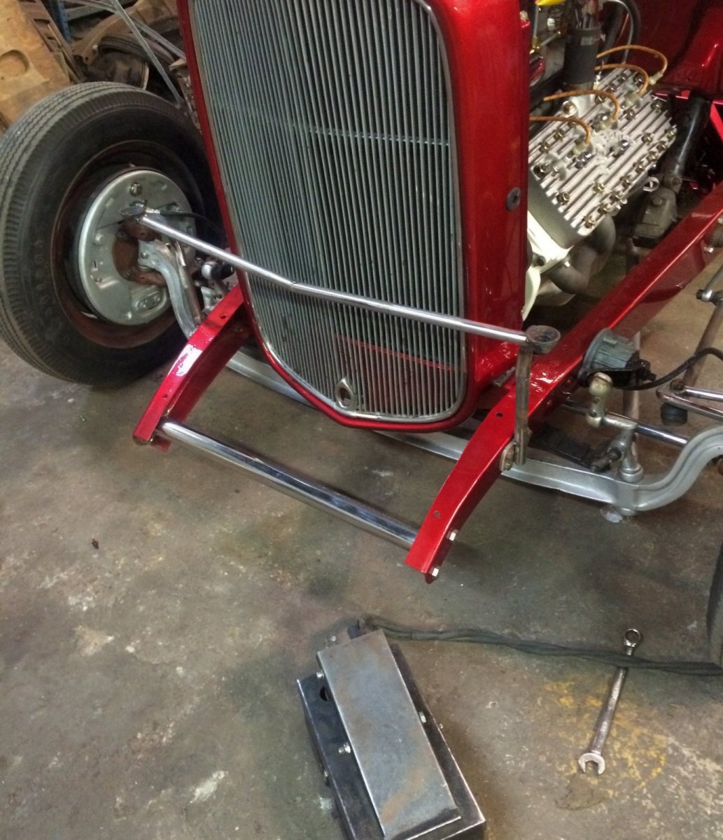

    Trevor, I've been thinking about your headlight dilemma. While doing some brainstorming, I thought back to how your neighbor @B*** set his up on his Deuce roadster. As a matter of fact, this is how I initially planned to do mine too. It's a traditional and downright clean setup. Plus it'll let you pick your headlight height. Img_6302b.jpg

    How about using rivets inserted, either from the top or bottom, and then either peen the rivets OR shorten their length put a 45 deg chamfer on the end and make a "plug " weld that resembles a rivet head. It gets rid of bolts and looks original.

    Switch to ****on head Allen screws.
