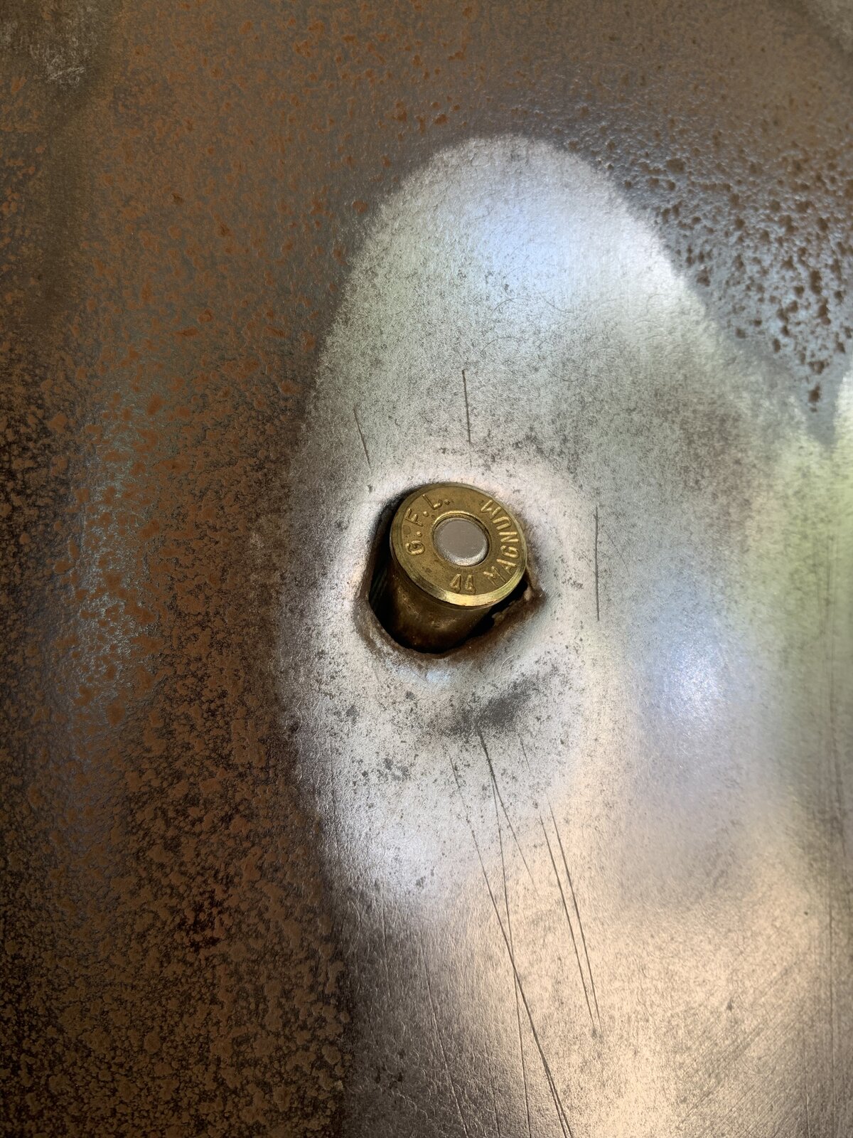

    Under a ridiculous amount of bondo I found these holes. I wonder if they're related to the car's race history? The bondo was applied over the electric blue paint from its racing days. I don't know much about race cars so maybe someone has an idea. Could they have something to do with a roll cage? Anyway, more holes to fill!

  13. 1-SHOT
    Joined: Sep 23, 2014
    Posts: 2,912
    1-SHOT
    from Denton
    Could have been a antenna mount
  14. Runnin shine
    Joined: Apr 12, 2013
    Posts: 3,383
    Runnin shine
    Looks like two different caliber coincidental bullet holes to me or punched holes not drilled?
  15. J.Ukrop
    Joined: Nov 10, 2008
    Posts: 3,757
    J.Ukrop
    SUPER MODERATOR
    I have two very similar bullet holes in both of my roadster's doors.
  16. Runnin shine
    Posts: 3,383
    Runnin shine
    .45 up top, .357 magnum below or is that .38? Small lol.
  17. 1-SHOT
    Posts: 2,912
    1-SHOT
    from Denton
  18. trevorsworth
    Joined: Aug 3, 2020
    Posts: 2,057
    trevorsworth
    Not a bullet hole, unless it took a stray musket ball! They are punched but too wide to be anything smaller than .50. A .44mag cartridge drops straight through the hole with plenty of wiggle room.
    Antenna mount or perhaps a grab handle would make sense. If those are bullet holes, it would be a heck of a bullet.

  19. 1-SHOT
    Posts: 2,912
    1-SHOT
    from Denton
    Grab handle for a rumble seat

  21. Runnin shine
    Posts: 3,383
    Runnin shine
    Maybe a 28 gauge slug?

    Great progress. I probably would have drilled another hole in the seat base rather than modify the car, but it's done and can be fixed later if need be. Those seat bases are HARD steel, too.
    Do you have enough room to slide in under the wheel? Looks tight. Have you made Vroom noises and checked operation of the controls yet?
    As for the holes, I agree that it looks like a grab handle for rumble seat, but who cares? They will get fixed when you get to that point on the body.
