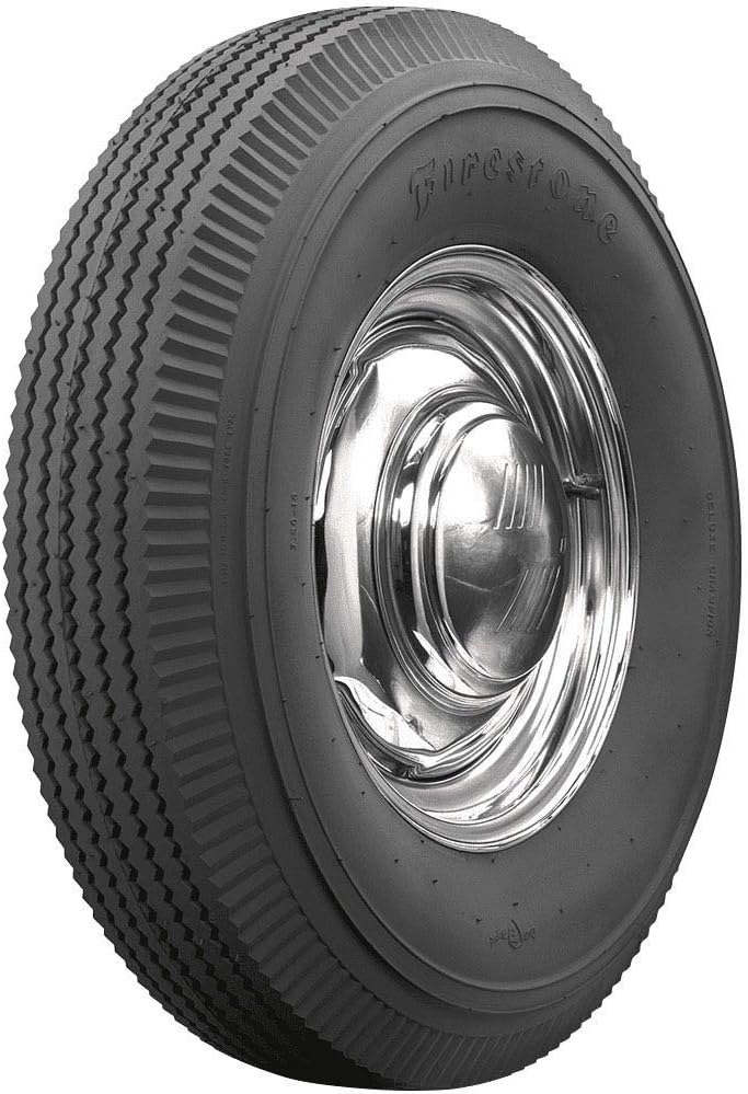

    More thoughts... Rear tires are in great shape - they're older bias plies but look basically brand new. They are a bit small for the rear. I think I'm going to move them to the front and order a pair of big fat tires for the rear, as the fronts are shot. I'm planning a reverse eye on the front & rear springs but overall I want the car to stay pretty tall, so I want a pretty big tire to fill up that space...
    Those front tires have MONSTER flat spots, in addition to not really holding air - so the car rides like it's on square wheels. Above 20 mph it's literally painful.
    Thinking these for the rears... nice fat sidewalls.

    As far as the tires go, I debated on 7.00 vs 7.50s for the rear for quite some time. I ended up going with the bigger tire for both looks and an extra mph or two on the top end. Use that Alliance discount!

    Wow, shipping is a ***** on tires. My bill after my (substantial!) Alliance discount is $532. Think I’m gonna have to sell some stuff. Anyone interested in some solid ‘28-29 fenders? Or a used kidney?

    Watch for Coker to run free shipping on Firestones. They just did it May, so you may not want to wait around for them to run it again. Also, look for them to run specials when the Me*** auction is in town. I ordered mine when I was at the auction here in Indy, and got free shipping and 10 percent off. I don’t think the auction comes to Dallas until December, so again probably don’t want to wait that long. But, something to keep in mind.
