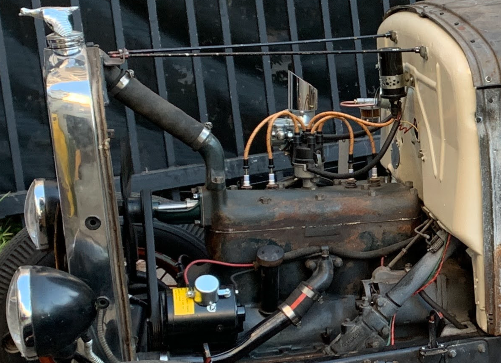

    Great to see the progress continue. I know it's not super traditional, but I'm very much a fan of my PowerGen on my roadster. I dressed it up with an old waterslide decal from a long-defunct electrical company and some cloth-wrapped wiring. Screen Shot 2021-06-12 at 12.54.32 PM.png
    With a bit more road grime, it'll fit right in. Plus it keeps my 12V battery charged perfectly.
    On the topic of wiring: I used to not be a fan either. Wiring my car from scratch got me over that hump. If you take the time to make every connection count then it can add to the overall appeal of your car. Here's my rough schematic that I made pre-lights.

    That wiring diagram is real helpful. Does the PowerGen have a built in voltage regulator?

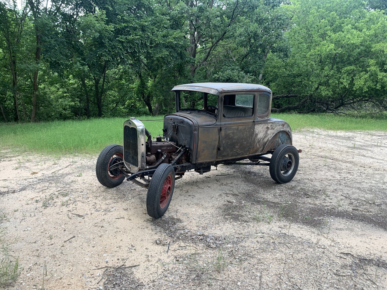

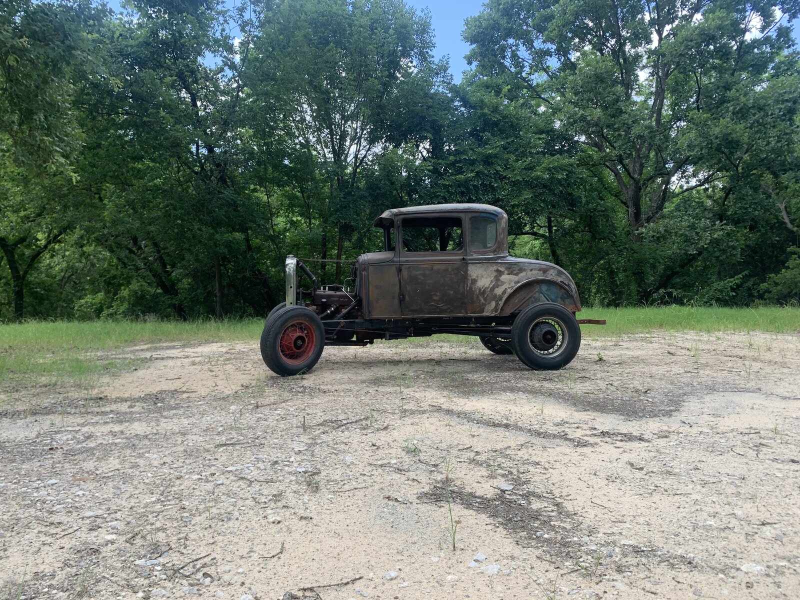

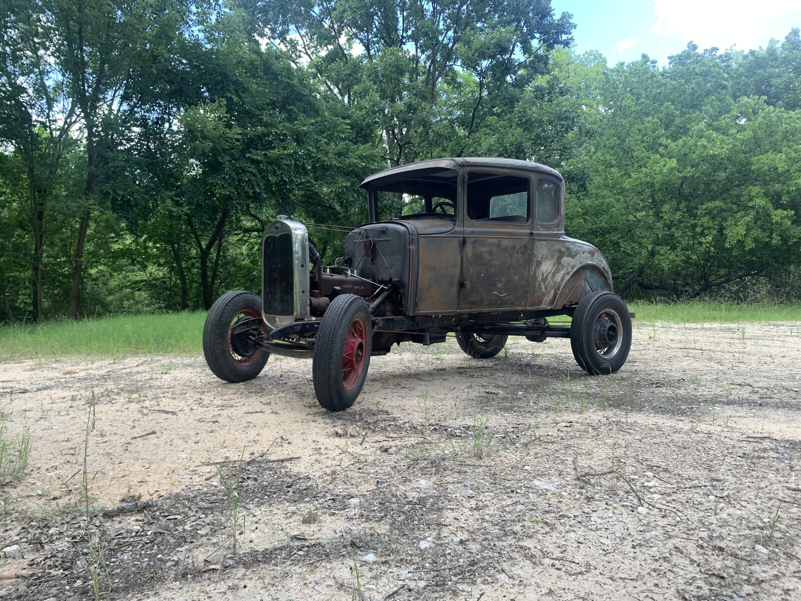

    Ventured further…
    9CD8853A-D2C0-4194-9CEC-7E66CF855625.jpeg A5C3E885-618D-4245-9C73-9646336F79B6.jpeg
    Running great, but definitely jumping out of second gear. Still not sure if it's me doing something wrong or a problem with the transmission. It only seems to happen when I let off the throttle, so maybe I should just keep my foot in it. :D

    Mr. Ukrop, Is the output from the gen less than the 20 amp fuse (x2) in the circuit?

    Sorry for the poor penmanship—all fuses are 30A on my system, which works just fine with the PowerGen.
