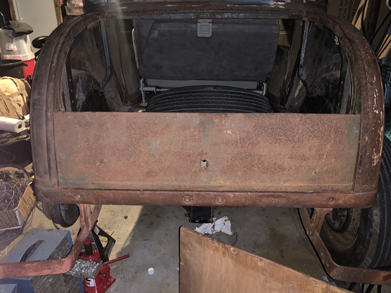

    I really wonder if a car like mine that’s almost street worthy but just slightly jacked up everywhere is a worse/harder starting point than a totally stripped carc***.
    I managed to get the under decklid panel to fit but it was a pain. The subframe below it is not completely straight, so there remains a narrow gap on the left side. Not sure how to proceed. I was going to just screw it down for now but the threads are jacked up too, so I guess I have to hog them out and tap new threads.
    I haven’t removed the bumper support brackets yet because I will be using them as reference points when I fix the body alignment. I got frustrated when drilling the bolt holes in the hacked in subframe rails. The rails are not even with each other, which made it a huge pain in the *** to get the holes right. It looks fine from the outside but it’s ****ed to one side just enough to put the hood out of alignment.
    I’m really jealous of the guys with the space, tools and money to do all of this stuff right.

    I got an agreeable quote for sandblasting the car, so that will be soonish.
    Also, now that I have a better understanding of what to look for, I'm pretty sure my deck lid is not worth pursuing. The inner structure is worse than it looked, and even if I repair it, I still need to convert it to a trunk lid. Since this is a rumble lid I would rather hand it off to a rumble guy who can use it and I will just look for a trunk lid.
