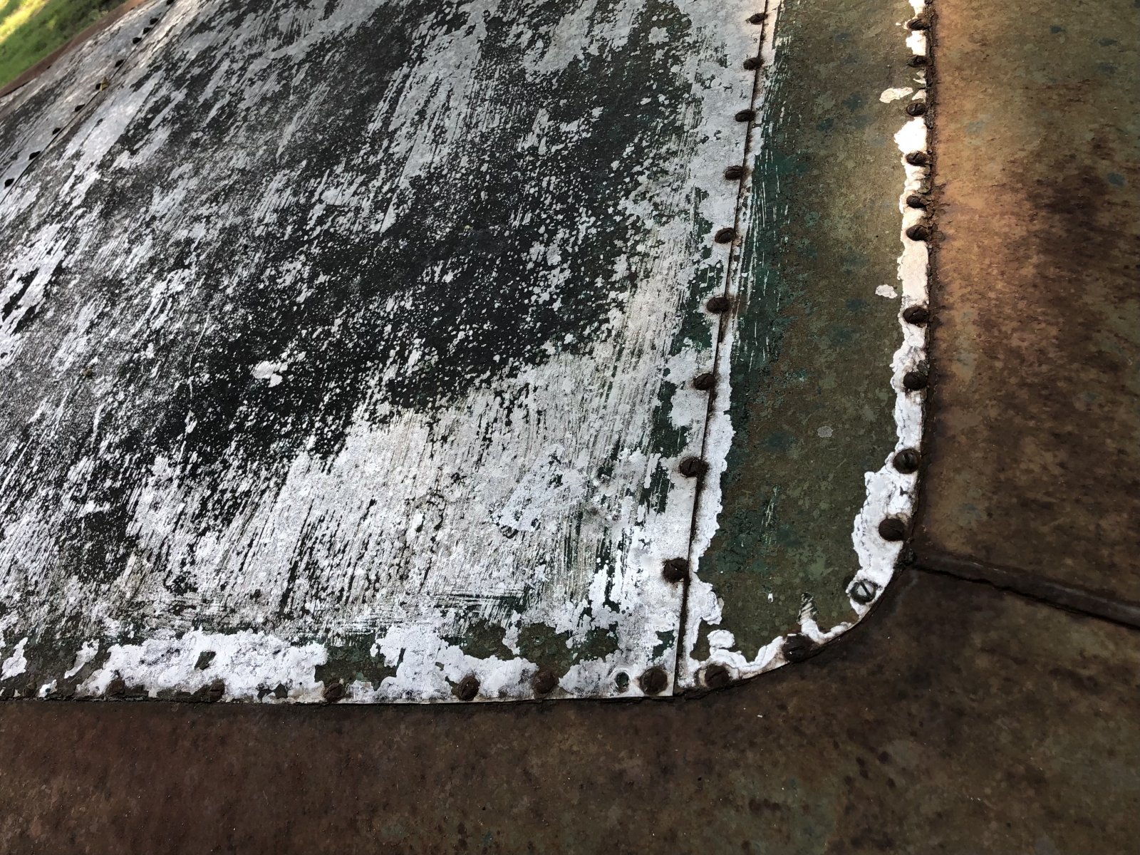

    I decided I'd better just rip the band-aid off and remove the roof. This promptly kicked my ***. I managed to get two screws out, partly remove 3 others, and break one. In the process I destroyed a screwdriver and 3 bits. Only like 50 screws to go! Decided to soak everything in aerokroil and give it time to think about what it's done.
    I dropped a bit and had to get down on the floor to find it. While standing up I managed to impale my kidney on the lowermost door hinge. Lots of blood!
    While sitting on the floor wondering if I was going to bleed to death in my garage, I noticed oil seeping out from between the head and block on the driver side, so I guess I need to do the head gasket. :rolleyes:
    Not looking forward to eventually having to fill all these little screw holes.

    My 31 sedan has a roof insert similar to yours..in fact there’s tons of “fabricated” aluminum bits and pieces. Guy who did the “restoration” in the 70s must have worked on aircraft or something cuz the roof insert is multiple pieces and is fastened with a slot head screw every inch. I’m definitely not looking forward to the job of removing them all when the time comes. I’ll try and get a pic later this week, it’s a little excessive
    here’s the only pic I have, kinda gives you an idea

    See iffen I can help, w/o pics. ;( . Sorry, hope words will work ok.
    To lessen the stuck-screw-removal-syndrome pia, get an air-hammer & an adj swivel for the air hose, so you can turn down the "hit". Next, get or make, an attachment(that holds 1/4" screw tip bits) that snaps onto or is welded onto, a air chisel (needle point style adapts best), & fasten a handle (w/rubber covering where you hold it, as the vibration form this will actually hurt like hell.). So as you apply the air hammer, the vibration loosens the rust-grip, & you slowly & gently, turn the handle to rotate the screw out. You do have to hold the air hammer in tight & hard to the screw so things don't slip out, but the air pressure required is variable, as you don't want to blow or push the screw into or thru the surface it's located on.
    I don't know what this tool is called, tried looking for it, but couldn't find one like my friend had, but aircraft mech do use them, which is where he got his, but didn't remember from whom or what co. I made my own, it looks like a sideways "T", although when used hard for very large screws, like 50's door hinge screws, I eventually broke the handle off at the weld. NBD, as I expected that, since the air hammer tool is hardened & doesn't like being mig-welded. Braze might work better. but it's not a hard fix.
    I'd also suggest foam ear plugs while using this.
    HTH.
    Marcus...
    trevorsworth likes this.

    p32037_2_1.jpg ^^^^^ Is this what you're referring too? Eastwood screw buster $19.99

    @Shadow Creek, I read your post earlier but the image didn't load then. Your roof is almost exactly identical to mine, even cut the same, using the same type of screws spaced at the same interval. You don't live that far from where my coupe was fished up. I wonder if there's a relation. o_O

    I added the pic later instead of making a second post, probably why you didn’t see it originally. My sedan actually was in Missouri for a good portion of its life til coming to Texas about 20 years ago. To my knowledge it hasn’t been touched or worked on in probably close to 40 years. It’s a project for the wife, patiently waiting its turn which will likely be 5+ years from now since there’s other projects and other priorities right now. Kudos to you on your perseverance, if you ever need anything you can PM me and I’ll help if I can.
