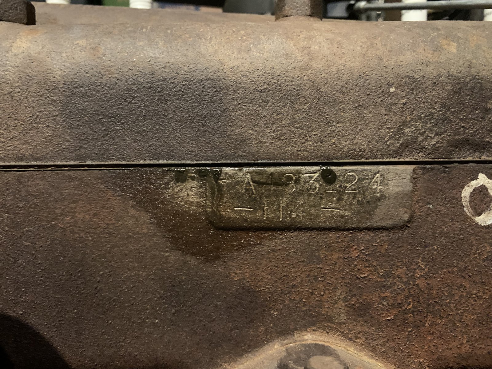

    trevorsworth
    I’m as confused as you are. But I’m sure it was oil.
    I had already wiped my finger through it but you can still see it beading on the serial plate.

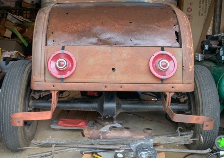

    I got some tail light lenses for $20 today. I think they're early 60s Galaxie? Anyway I figured for $20 I'd slap them on the car and see what I thought.
    Too big, I think. But I have an idea.

    5 minutes in photoshop later... If I cut a smaller hole and mount them inside the panel, I can hide the reflector rim on the outside of the lens with the bodywork and fit a chrome trim ring around it. That improves the proportions and I get to keep the cool turbine element in the center. So I think I can still use these if I can find a piece of trim that will fit.

  15. OMG NO!!!! That's WAY too far from the vibe of the whole car!!

    I kind of had the same thought when I stepped back and looked at it. I admit I have no idea what to do here and have yet to be struck with inspiration for the tail lights. All I know for sure is I don't want the same 50 Pontiac lights everyone else has - they look nice enough but they're not that interesting on their own.
    I think big, flush fit lights like this are the kind of thing you'd find on a 60s style, chopped/channeled/lowered/32 frame kind of car. Which is not what I'm doing. But I'm not sure what to do. I'm definitely not cutting holes in anything til I've settled on something.
    I already know what I'd do if I had the truck body I was after...

    Trevor, as we talked the other night, I am kind of shooting for an early/mid 60's vibe with my car. I think it's important to sort of figure out what era you want your car to represent and use that as your deciding factor. If you're wanting an earlier vibe with the eventual A-V8, something more like the '39 teardrop or '48 chevy tail lights are easy to get. Chrysler airflow tail lights are beautiful as well. There have also been guys who used 48-51 Hudson lights. I like the turbine look, but let your timeframe decide.

    I think you're right. I'm gonna kick these frisbees down the road and look for something else... I dig the turbine look but it's not really for this car.
    All the lights I really like from the 30s are big $$$$, so I'll probably set up a simple, single, license plate mounted light for now.
