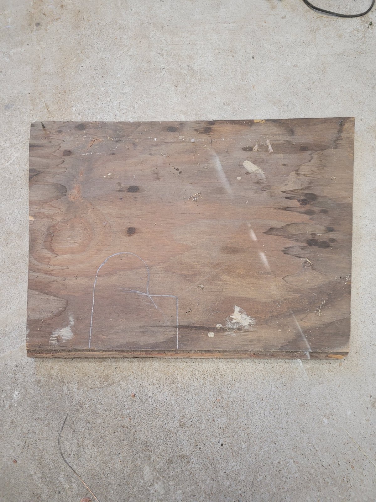

    I made this floorboard pattern working on a friend's Model A. If it helps you, it's yours! If I remember right, the angles on the sides are correct. I traced it off the original floorboard, cut the angles,, and that's as far as I got with it. You can see the pencil marks where the battery cover goes, I just never cut it out. 20210922_142148.jpg
    Jrs50 and trevorsworth like this.

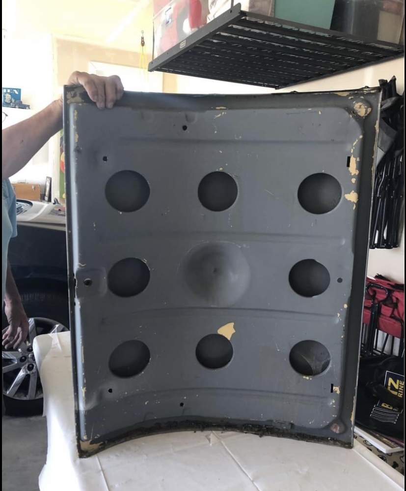

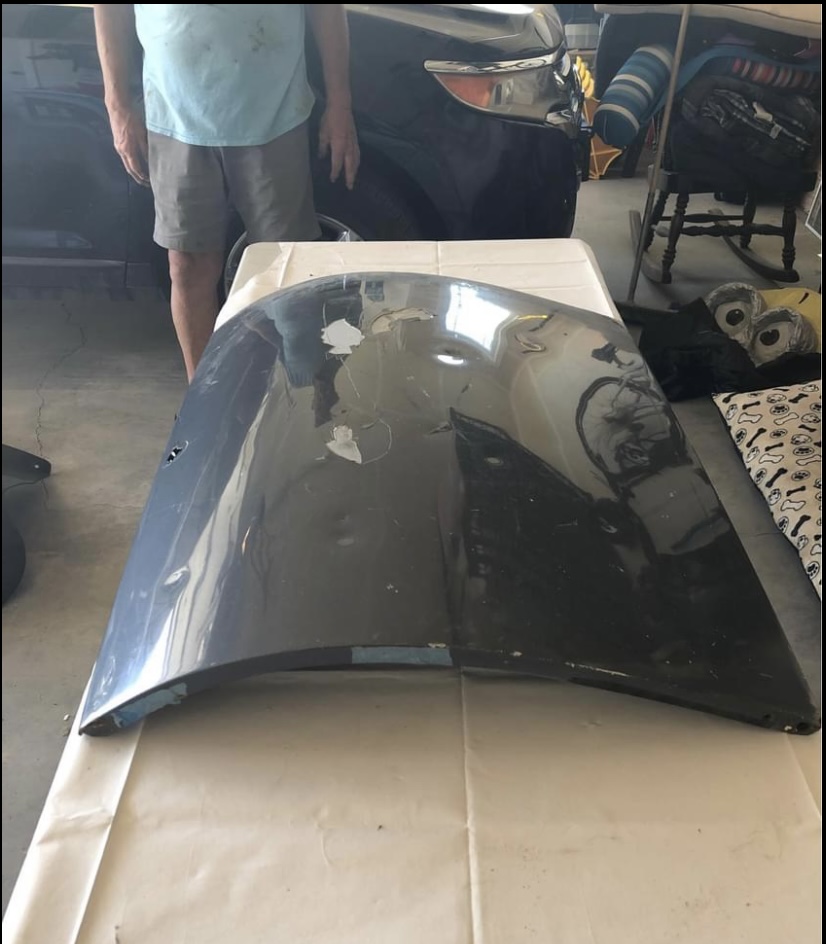

    Wood kits seem to be OOS everywhere, but I snagged a smokin deal on a deck lid. Not really what I needed right now but that will go a long way toward making this hoopty feel more like a car. It has some hail dings but nothing that can’t be m***aged out I think.
    8362D4C2-5957-4C5D-B352-B81E439CA0A2.jpeg B6BECEE4-D67A-4FFA-B093-825991DAB29B.jpeg
    Original steel lid. Gonna strip it when it gets here and see what I’m working with…
