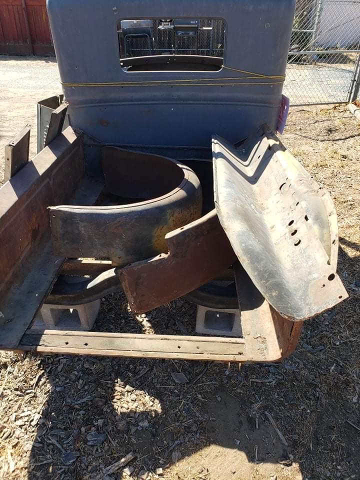

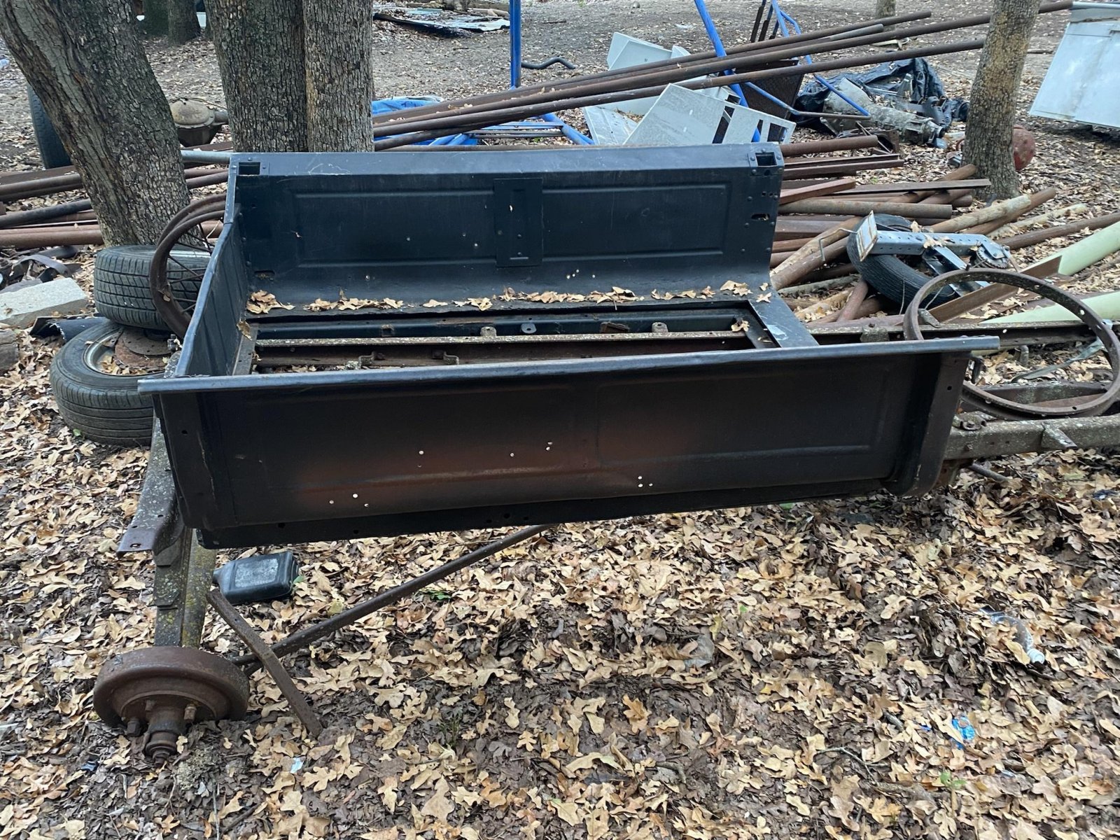

    I've received two offers to trade the coupe body for trucks - one an actual '31 truck and one is a converted sedan of unknown year. Both are solid, both have some complications. Hoping the '31 works out but I will probably settle for the cut down sedan if not, so for now I'm not doing any bodywork other than finishing cleaning up the trunk lid.
    Here's the '31...
    The complication is that it's in California and not currently owned by the guy offering it to me! He says he will buy it and bring it to me to trade for the coupe. I have done some trading with him before so I'm taking it seriously, but I'm not betting my life on it. We'll see.

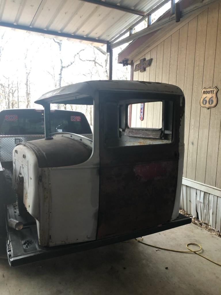

    Here's the cut-down sedan:
    Unlike most cut-downs I've seen, the cab is virtually indistinguishable from a truck other than the beltline not quite matching, so I will settle for it if nothing else comes along. It's 30 minutes away. The complication with this one is that it is a smidge longer than a truck cab, so the bed will have to be scooted back a little on the frame. Not the end of the end of the world but it does mean the wheel arches won't line up.

    Or cut down the bed some. How much are we talking? 3 or 4 inches or way more than that?
  7. trevorsworth
    Joined: Aug 3, 2020
    Posts: 2,104
    trevorsworth
    I'm thinking just an inch or two from what the guy said. There's enough meat at the front of the bed to take out as much as needed to make it line up, but I'm worried about two things, one - messing with the proportions and two - making the already tiny bed even tinier. I do want to be able to chuck **** in the bed so the less room I leave the worse off I am.
  8. One or two inches would be virtually nothing when it come to usable space. A bigger question is: will you be comfortable in a pickup?? Those cabs are might small, so if you are not vertically challenged (like I am) you may want to check out your comfort level in a pickup vs. a coupe. I've known a lot of guys that have parted with rigs (old pick -'em-ups and chopped Model A's) because they couldn't stand them for more than a half hour.
  9. trevorsworth
    Joined: Aug 3, 2020
    Posts: 2,104
    trevorsworth
    I sat in a truck and thought it was just perfect for me. I know they are a little cramped for most guys today. My build is pretty much what these things were built for I believe - I'm 5'7", 130 pounds soaking wet.
    I think I would even be comfortable taking a couple inches out of the pickup cab if I cut the seat down a little to match. But not too far or I wouldn't be able to see over the steering wheel! :D

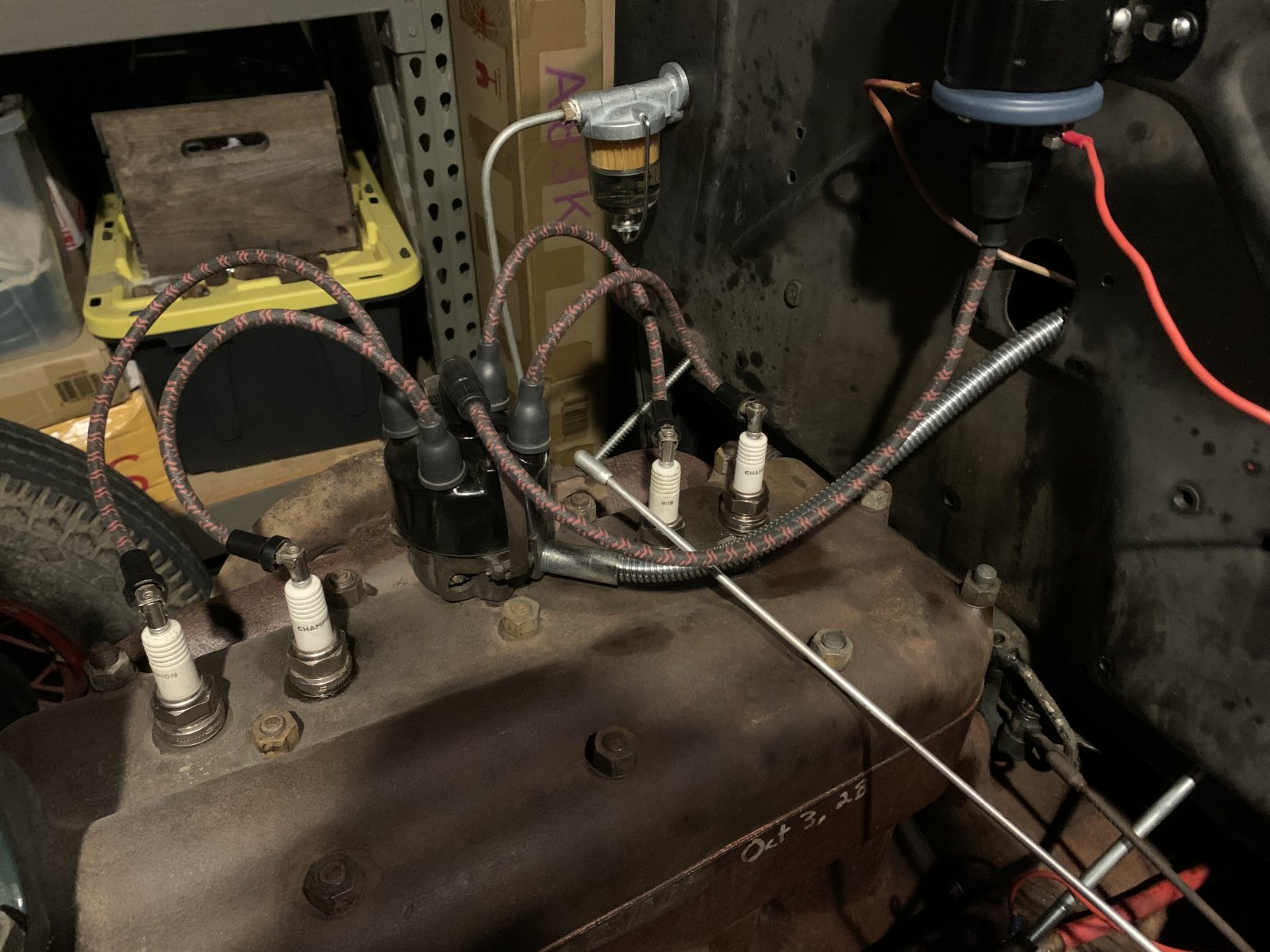

    I finally blew up the 6v ignition coil. This covered much of the engine compartment (insofar as it could be called a compartment) with PCB oil, so I blasted everything with degreaser and hosed it off.
    Went to NAPA, got a 12 volt coil. Dude at the counter had never heard of an ignition coil. He brought me some **** that looked like the international space station. He had to go get his manager who was like, dude, really?... anyway...
    The car has always shuddered/missed occasionally but today in lower lighting I noticed arcing between the br*** clips and the distributor cap. I decided now was as good a time as any to upgrade and reached into my parts pile.
    I had to trim all the plug wires waaay down. I think #2 and #3 need to be even a smidge shorter. But the car is running better than ever. I butchered the super stock coil wire to make a coil wire out of what was the longest plug wire.
