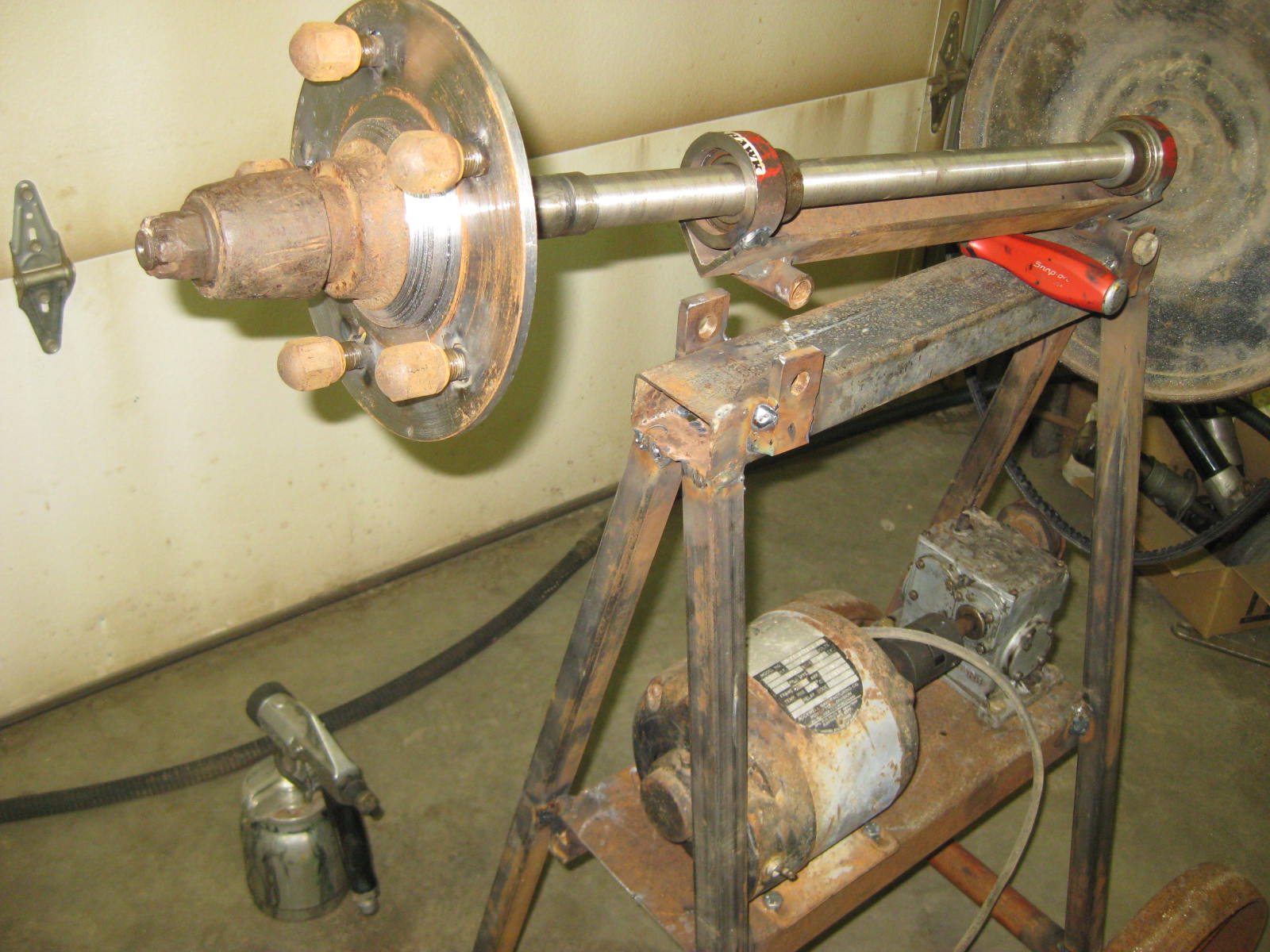

  11. rusty valley
    Joined: Oct 25, 2014
    Posts: 4,509
    rusty valley
    My spinner rig, its been posted here before. mainly made for painting wire wheels, as there are so many angles to cover all spokes. The other benefit is no skill required, you can just about pour the paint on and it flows out perfect while turning at 5 rpm. IMG_1217.JPG IMG_1218.JPG IMG_1219.JPG

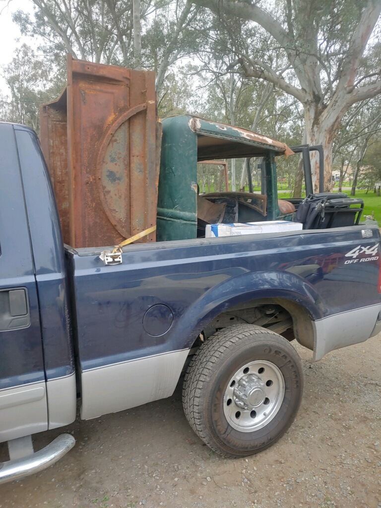

  24. RodStRace
    Joined: Dec 7, 2007
    Posts: 10,868
    RodStRace
    Sweep the heck out of the driveway, those hoist wheels hate rocks.
    If you can mount a pulley next to the fridge on the back wall, a rope can be run to the front of the ch***is, in to the pulley and back out to a truck to pull the ch***is into the garage uphill.
    The links mention unbolting the steering box to lay down and clear the column out thru the floorboard. I'd get the steering wheel and levers loose too, to make it easier to feed the body off. You may decide to keep it all together and protect the levers/linkage. The ch***is may be tough to roll with the box unbolted.
    Where it's sitting in the picture, the truck backing in may hit the curb just as the tailgate is close to the back of the body. Test this before lifting the body. 3-4 feet in or out could make a big difference.
    It may be easier to load the coupe into your bed, then back his truck up and slide the PU cab onto the ch***is. Last, move the coupe body from your truck to his. This would be good if both trucks are similar bed height and he's willing to help with the cleaning and mounting. A sheet of plywood will help here too.
    Best of luck, hope to see pictures of the truck cab on your frame soon!

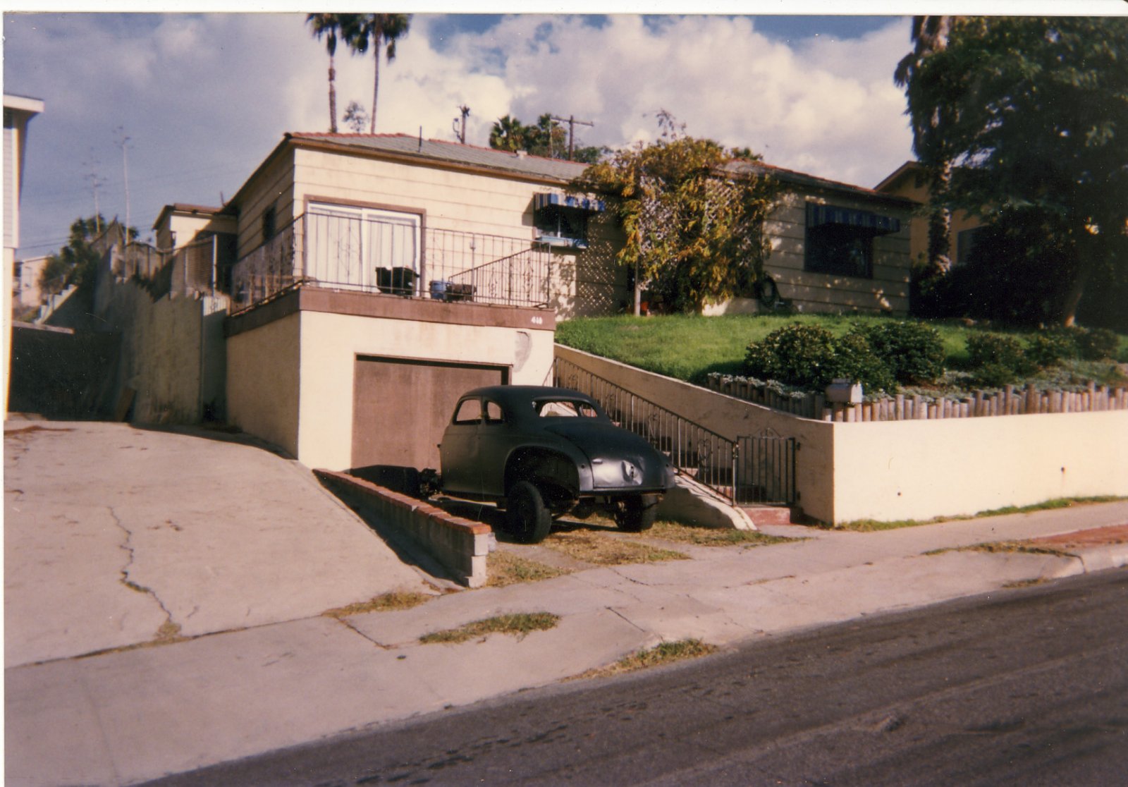

  26. RodStRace
    Joined: Dec 7, 2007
    Posts: 10,868
    RodStRace
    Had myself and 3 friends lift a 40 Plymouth stripped body shell up onto a retaining wall to get it out of the street. It ****ed, big time. Body ended up on garage roof for a couple years to allow garage access.
    That was my first house. Big lot, great view, nice house. It ****ed for a car guy with the one car driveway and one car garage (no power).
    A come-along is slow and annoying if it's a cheap one, but beats having to push the ch***is and kick the wheel chock. Make sure the saw horses are wide enough to let the ch***is (rear axle/tires) roll between them.
