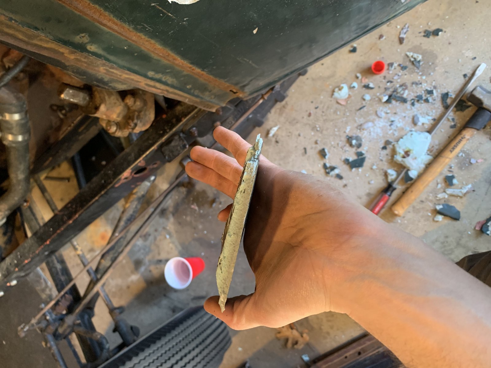

    Fingers crossed but this looks to be the only rot on the entire body. I chipped away some of the tractor paint in the other usual trouble spots and found solid metal beneath.
    Some older paint in the door sill. Looks like this car may have been andalusite blue at one time - my favorite Model A paint color.
    Big bondo spot filling a dent in the driver side cowl. Don't see any signs of rot, p***enger side looks to be bondo-free.

    br*** wheel on a grinder wont hurt anythig an will clean bondo an rust an they cheap

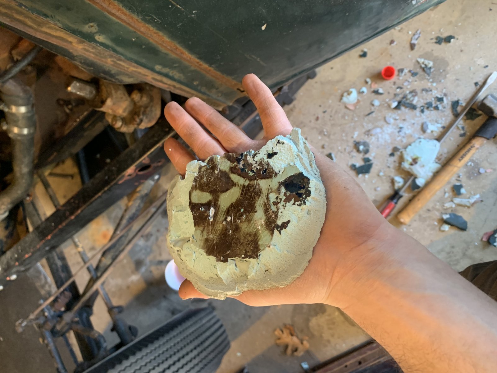

    1BD76F7A-060D-4C31-BFDA-257635A56B28.jpeg B44AE9E2-F290-4285-96AA-D8DE1CE2A4D2.jpeg
    Bondo-Man strikes again!
    MBog likes this.

    I just got a couple shrinking hammers and dollies. We can try them out. I'm sure there is some stretched metal there!

    It doesn't take as much skill to sculpt bondo as it takes to fix it right!:confused::rolleyes:

    And for all that, it’s not even that bad of a panel. A little wavy and cratered but the edges and body lines look intact.
    Looks a lot like the p***enger side on the coupe, oddly enough.
