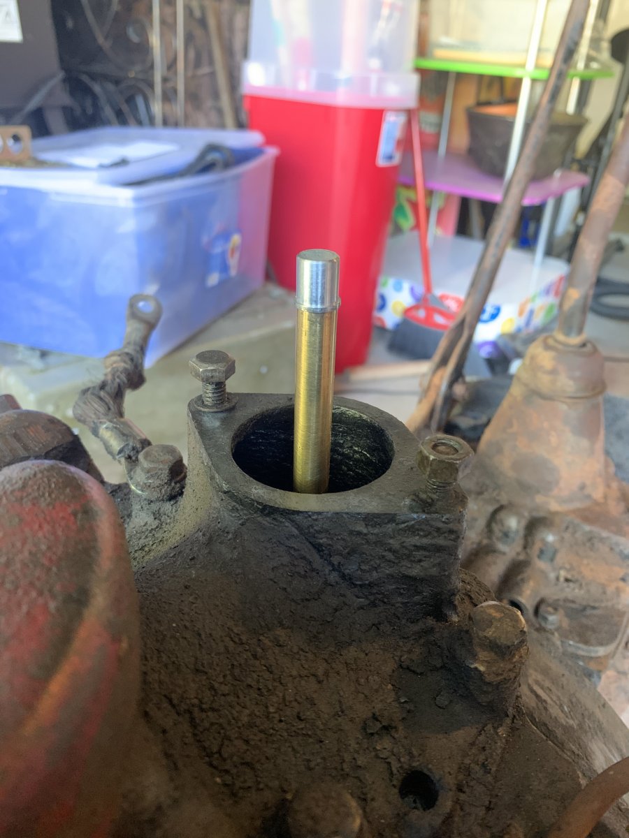

    The fuel pump pushrod I got to plug the hole in the block stands proud of the hole in the intake manifold by quite a bit.

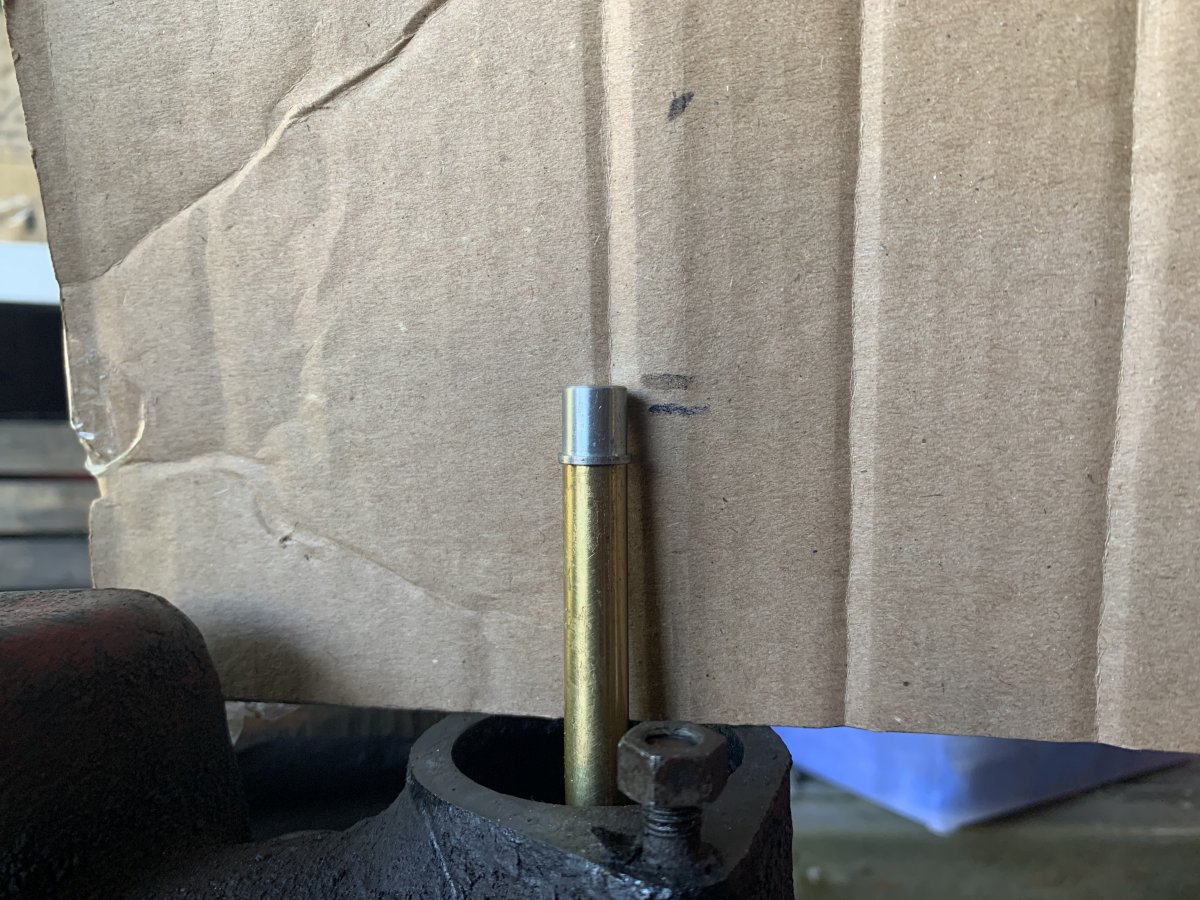

    trevor, take a picture of the pushrod at it's highest point, and then rotate the engine and take a pic of it at it's lowest point. Also, take a pic of the pushrod all by itself if you dont mind.

    The actual throw is so short that it’s impossible to take a picture that really shows the difference between highest and lowest points. The lines in the second pic were drawn above the rod at its highest & lowest.
    B6BA30C3-2267-4673-A127-771BFC1DF6F3.jpeg 969BF21C-FCB3-4581-8246-2152ACDDF47A.jpeg

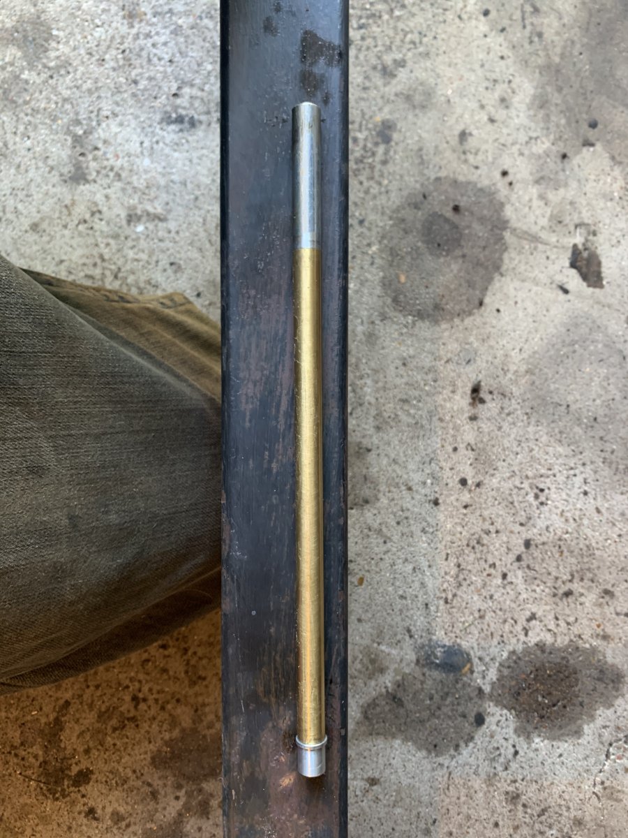

    Here is the pushrod by itself.

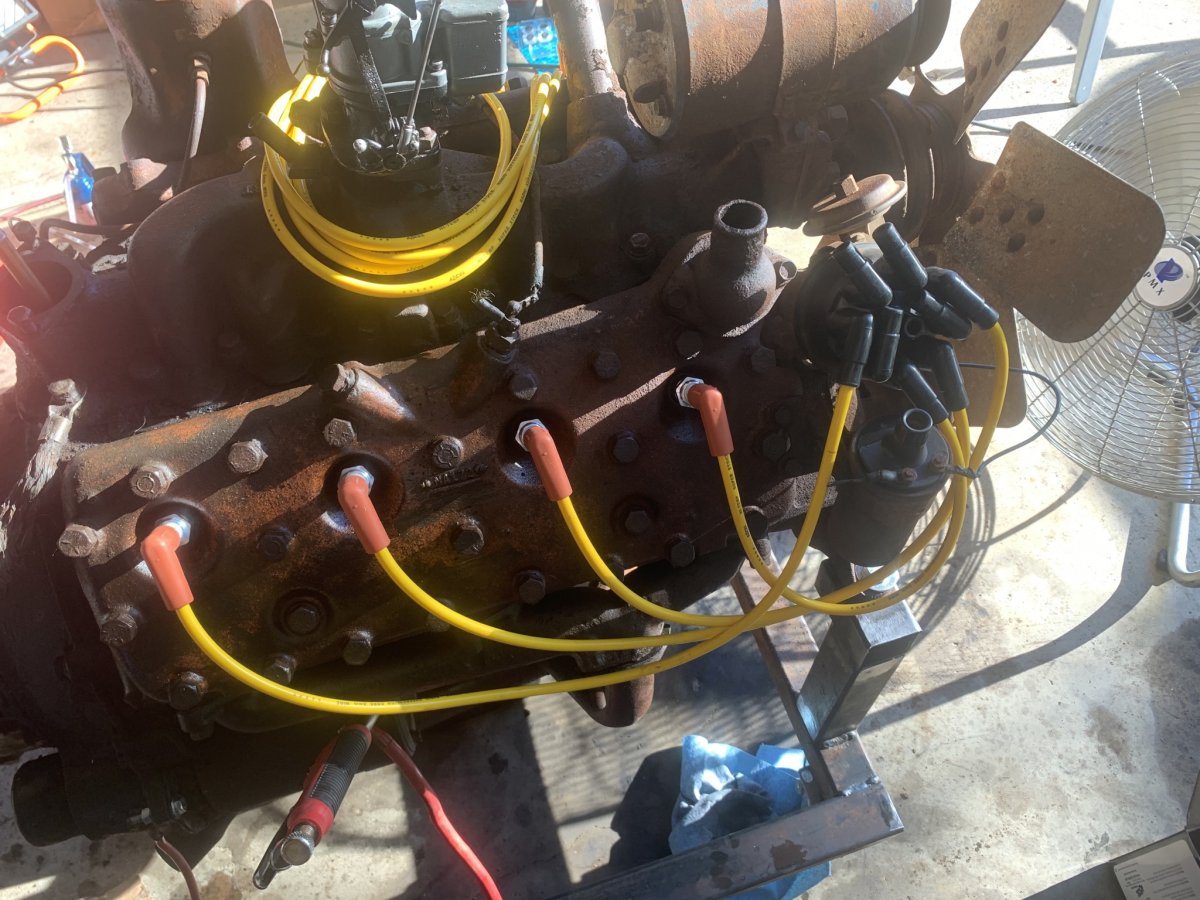

    I got a set of plug wires. Gotta trim them and whatnot. I think they're too big around for the original P-shaped wire holder things. Not sure if there's a technical term for those.

    Taking a breather. Got the firing order worked out. Just need to cut to length and fit boots now. Definitely can't fit 4 in the factory wire holder deals but I know I need to suspend those 4 somehow so they aren't resting on the heads. Hmmm.

    Nylon Tie wraps....just dont cinch them down really tight...

    For no longer than we are going to run the engine, it isnt going to hurt the wires for now. Once we get it to where you can run it for extended periods, then it becomes an issue. Going to have to find a radiator and at least one water pump before any of that happens though!
