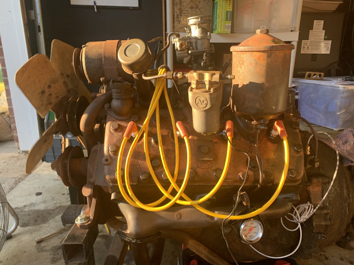

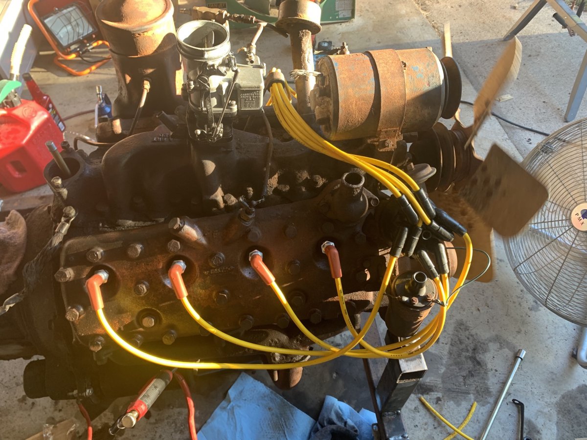

    Calling that done for now. Probably too much slack on the driver side but it will work. Not an expert but I think it looks pretty good for a first crack. My fingers hurt.

  2. Your doing just fine. F.Y.I. even if you don't cut the pushrod down or even cap closed the hole in the intake your not going to have an issue. The pump cam only lifts the pushrod about 1/4" total, hardly enough to make it Jump out of the hole. You don't have a P.C.V. system so not having a cap on the manifold hole is no different than leaving the Oil fill cap off the tube. It's no big deal until you actually start driving it down the road. This is just a test fire to see what you have. See if you can find a large Pipe Wrench that can grab the O.D. of the pully on the stuck pump and work it back and forth. I'll bet you can brake it loose and then put a belt on it when you find a Rad.

  7. Yes, the Pully is pressed on the shaft that goes through the housing and the impeller sits inside the block. It oils through a drip hole in the block to the pump shaft. It's not uncommon for them to hang up after sitting. Just get ahold of it and help it out. I have never heard of anyone braking a shaft off freeing one up.

  13. If you don't want the fuel pump shaft dancing up and down then for now just put a fuel line hose clamp on it to hold it up a touch off the cam lobe. You just need it in place to help with the Oiling system for now, you can fine tune it latter. Personally I'd be finding a manual Pump and housing. If you we closer I'd give ya one.

    It doesn't really bother me if it's moving, I was just worried about it possibly getting launched out of the motor by the camshaft. If that can't happen it's not a big deal to me at this stage. Good idea with the clamp though...
    I am a fan of the appearance of the mechanical pump with the gl*** sediment bowl so I am planning to revert to one eventually.

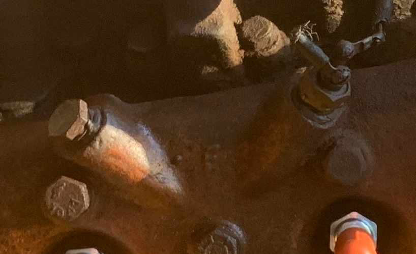

    Here's a silly question. I feel like I'm starting to understand these motors pretty well, but...
    I have been watching a lot of flathead content lately and I see these protrusions on the heads on all 8BA and 8RT motors, but like mine, they are always plugged. I just saw a video of a 41 truck with a 49 8BA in it where they had a hose coming off of one of them and running around under the block. What are they for?
  17. alchemy
    Joined: Sep 27, 2002
    Posts: 23,467
    alchemy
    A way to get at the water. Either for a temp gauge sender, a heater hose, or I've even stuck a sacrificial anode in there to prevent corrosion.
    kidcampbell71 and trevorsworth like this.
