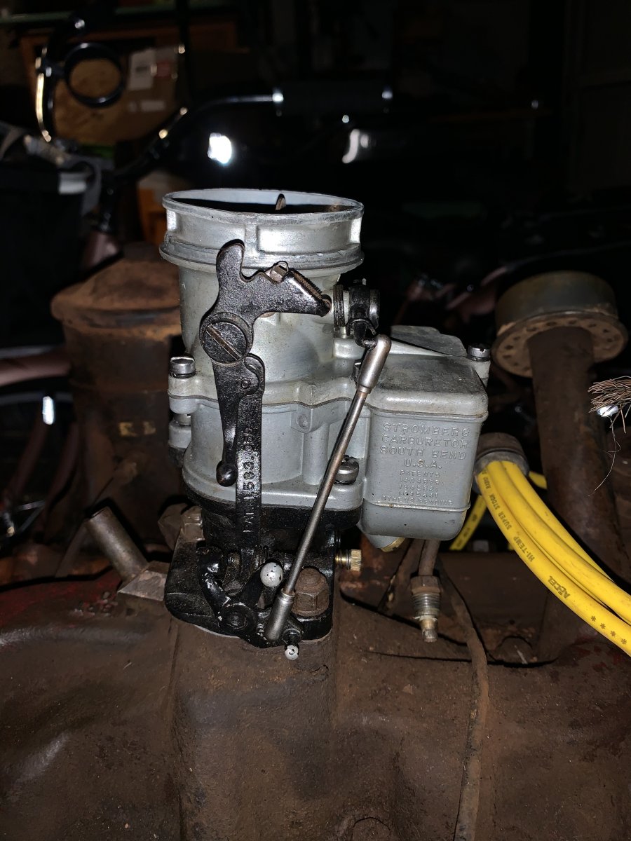

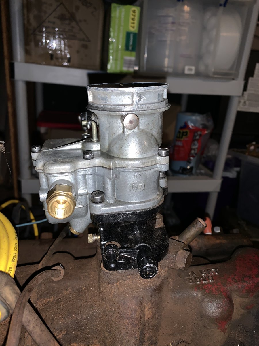

    E3E2D71C-184E-499D-859B-649858446DA4.jpeg 98A8C5D3-8240-458A-965A-D0AC8D6F370B.jpeg
    Here’s the best I can do in that regard right now. Can get better pictures when I get home this evening if needed.

    Can someone explain what the linkage in the first picture does, and how is it supposed to be tied into the linkage in the second picture?
    The ball connection (dont know what else to call it) at the top in the second picture is obviously the choke, and the one below it is for the ****erfly and to operate the accelerator pump via the angled rod, I am just not sure what the ball connector on the other side of the carb does.
    Can anyone help explain?

    The stock left side arm is usually sh!tcanned and not used by hotrodders. Most old Ford linkages from the pedal attach to the ball on the right side. If you use multiple carbs you can install the proper aftermarket connecting linkage on the left sides.

    What purpose does that linkage serve? I wasn't there to see the carburetor before trevor installed it, but it seems to have some sort of ****erfly in the plate below the carburetor.
    If it is removed entirely, wouldn't the holes need to be sealed off?

    The left arm will open the throttle plate a little via the stock dash "throttle" knob in the old Ford. It's attached to the same throttle shaft as the right side arm, except the left side has a slide feature that is useless to hot rodders. Drive the little pin out and remove it from the shaft. No holes to plug. Or you can leave the thing alone until you are ready to install the carb on a dual intake.
