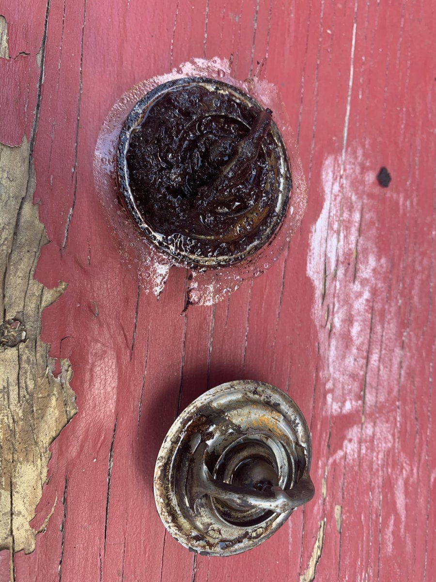

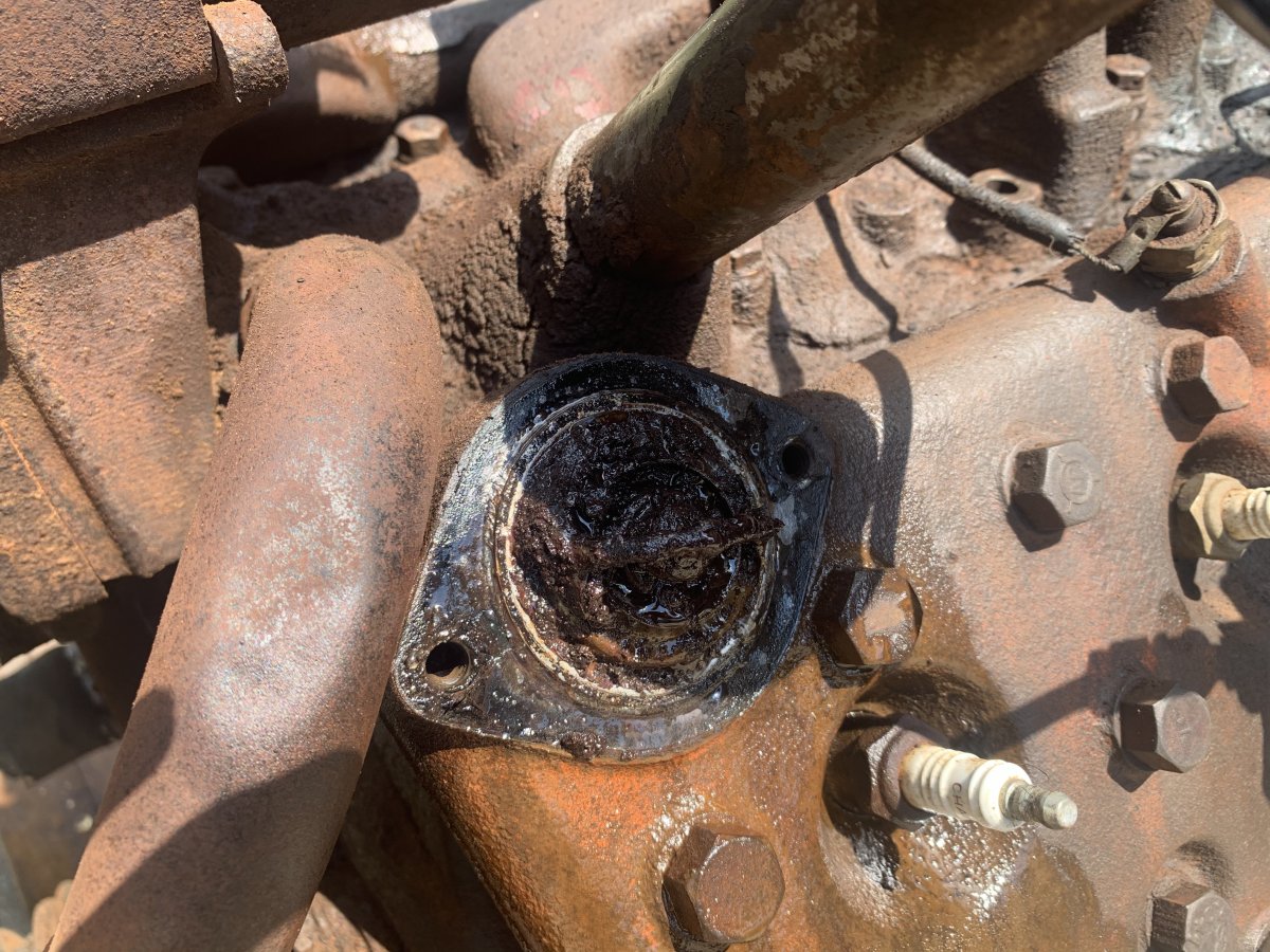

    Well here's some more good news, in light of adjusted priorities. The stuck p***enger side water pump broke loose today. I had an inkling that it was probably stuck on the outside of the shaft where it goes into the block so I hit that with a little PB blaster, let it soak, and then tapped it with a mallet and now it spins free.
    Since it'll have a radiator hooked up to it pretty soon I figured I'd better go ahead and figure out how to clean out the water jackets. The amount of crud @RMONTY and I were seeing was giving me some real worry, especially for the side with the stuck pump, so I went ahead and pulled the outlets off just to see what I could see.
    It was a real 'duh' moment when I realized that of course there are thermostats in the outlets and what we were seeing was just gunk that had settled on top of them. Inside the water jackets are spotless (well, they are pretty clean) and the valves seem to still work, so now I just need to clean the outlet necks, make new gaskets for them and get some belts, and then it'll be ready for the radiator.
    edit: In fact, NAPA has the gaskets in stock at my local store.

    You certainly could install the old thermostats if you want to , but boil them 1st and make sure they actually open. If it is as hot in Texas as it has been in Kansas, you might consider just leaving them out for now. While I did install a mechanical temp gauge. I have found that using one of those digital temperature laser pointer guns is really informative, as I can check the temperature of everything I might want to know about. I bough mine at Harbor freight cheap and it works great.

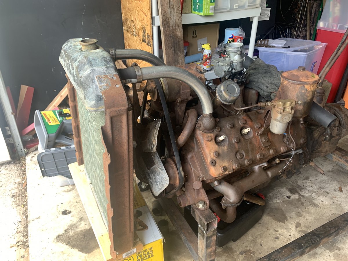

    Huge thanks to @amodel25 for lending me this rad out of his super cool Tudor. You were right - no leaks!
    If I can just figure out what size the fan belt is supposed to be we'll be ready to really start cooking. Supposed to be 32 but that was too small even with all the tension let out. I think the fan pulley is bigger than factory, so going to go a few sizes up.

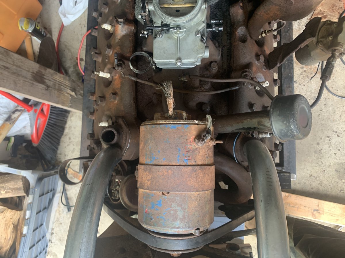

    How tight are the belts supposed to be? I swear the generator belt can't get any tighter and it still feels sloppy, but it's definitely the right size. On fordbarn I saw someone say it's supposed to have 1" of deflection?? How can it run like that?

    One inch of deflection is not loose. The belt will be tight and with your pointer finger you can press the belt in an inch with force and it bounces back. Its not slack.
    Also both belts need to be in adjustment kinda at the same time. The whole thing slides up on the stud off the intake manifold. The fan slides on the 2 bolts next to that stud. I let the 2 fan bolts stay slack and just do the generator belt. Then carefully with a bar pry up on the fan then tighten that up. That fan should have oil in it. Motor oil is fine.

    A surprise thunderstorm has sent me inside for now but I think I have the generator raised as high as it can go, so I'm going to have to go down a couple inches on the generator belt.
    I have reinstalled the thermostats and the outlet ***ty things and am working on the 90 degree elbows on the return side of the water circuit. Decided to use galvanized conduit pipe for the elbow because it's significantly cheaper than preformed rubber hoses and looks pretty cool. I pushed some water in through the inlets and found that the driver side water pump, the one I thought was good, has a bad leak around the pulley shaft, so I am definitely going to have to replace or rebuild it before we can really run this puppy. amodel25 actually loaned me some extra water pumps he had but it looks like they are for a 59A (pulley shafts too short) and won't work.

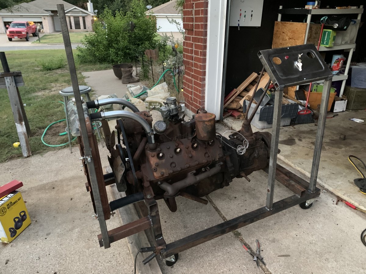

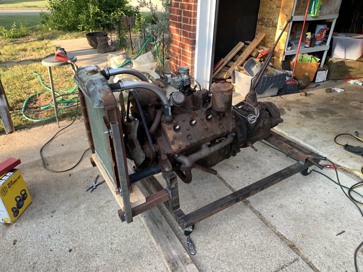

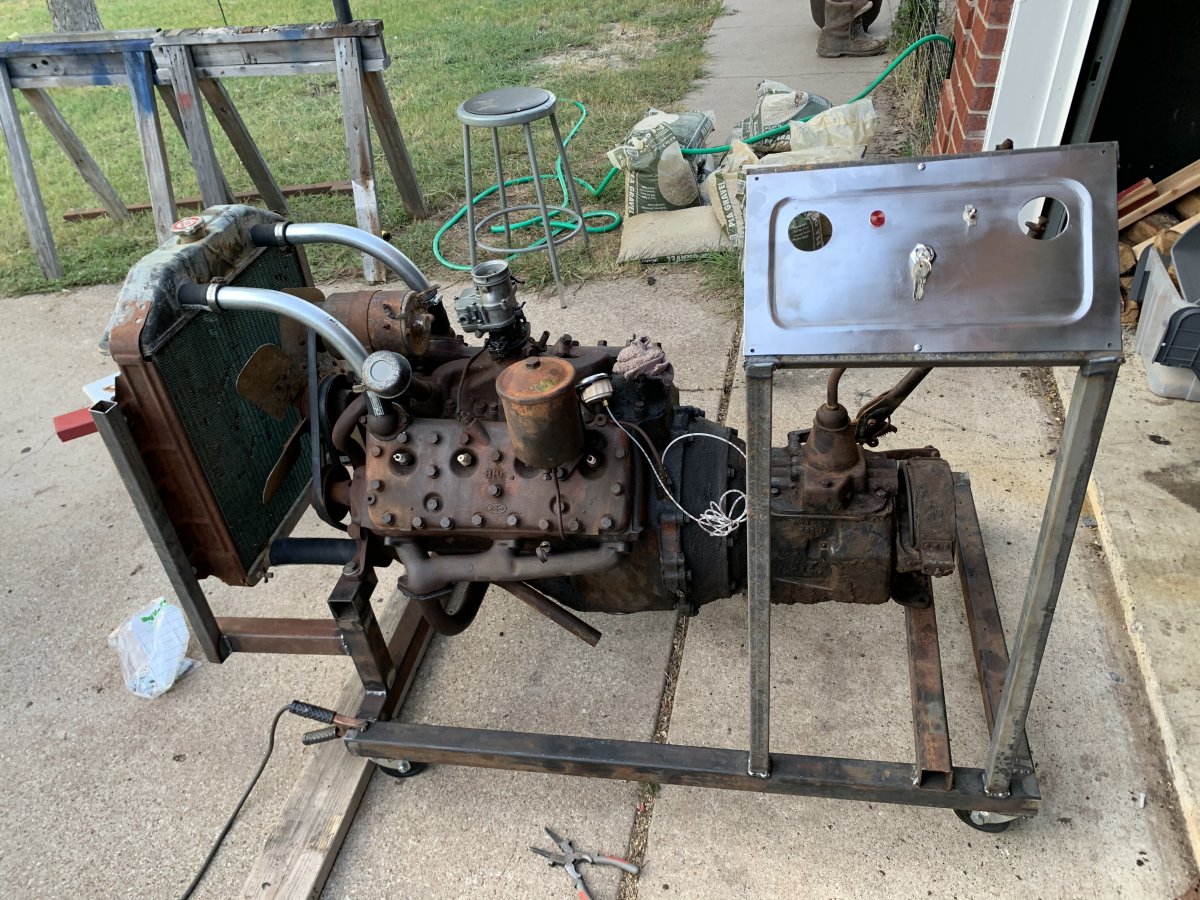

    741B4F8B-6E29-43EE-A2FE-13A53FC05F47.jpeg 1983A96F-9852-4B83-8444-60D151336488.jpeg 4FEE7C17-4983-4D53-BB7C-D977F62A2914.jpeg
    Lots of progress today with @RMONTY. The control panel he made up looks great. My welds don’t do it justice, but they’ll hold it aloft. Sunday it’s getting wired up...
    I think the big radiator pipes look slick as hell but boy were they ever a pain in the rear.
    Got some piddly things to do on it between then and now like hose clamps, getting the plug wires hooked up and stuff like that.
    I ordered an oil pan cleanout gasket yesterday and was very surprised when it arrived today. Long story short, I ordered some on eBay like 2 weeks ago, totally forgot about it, ordered another set yesterday, first set arrived today.

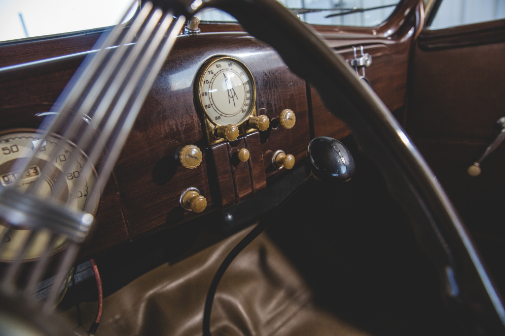

    See the knob left of the radio? That's the throttle lever. As you said, pull it and let er buck.
    Hot rodders don't need these. I've always just removed the left side linkage when I've dis***embled the carb. Should be a small pin running crossways through the shaft. Punch it out, pull the arm and stuff off, then bolt the carb back on and go about your fun.
