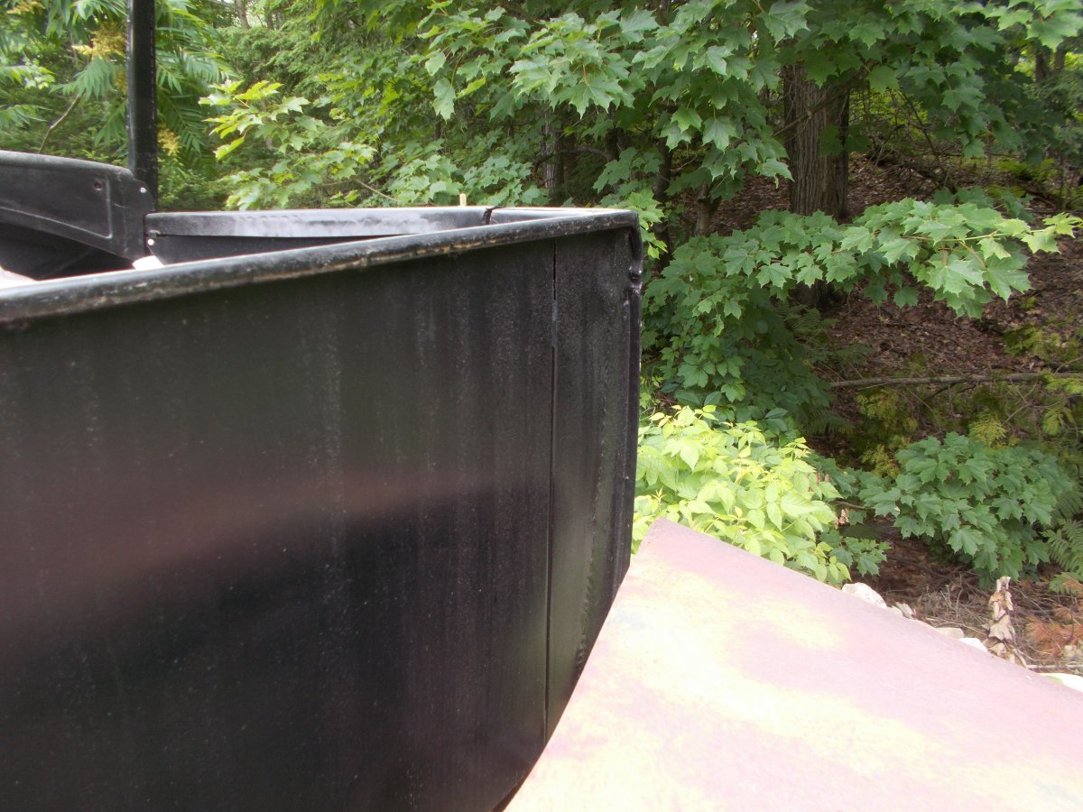

    Welcome to the HAMB, just found this build. Like that Cabriolet cowl and door find, back yard views are really nice. Bob

    Looking at the location of the stake pockets, looks to me like you found a Model A bed. You did good!
