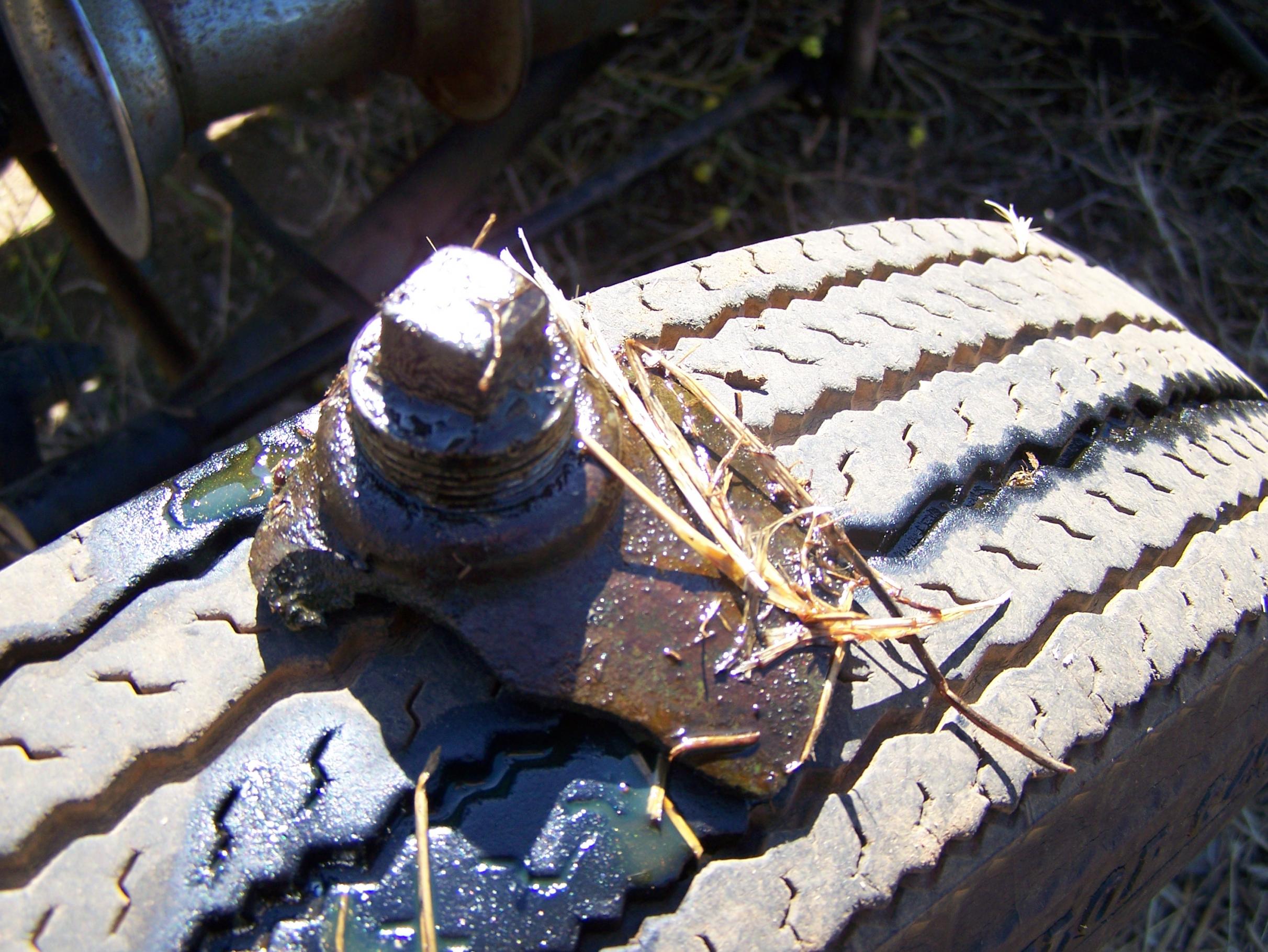

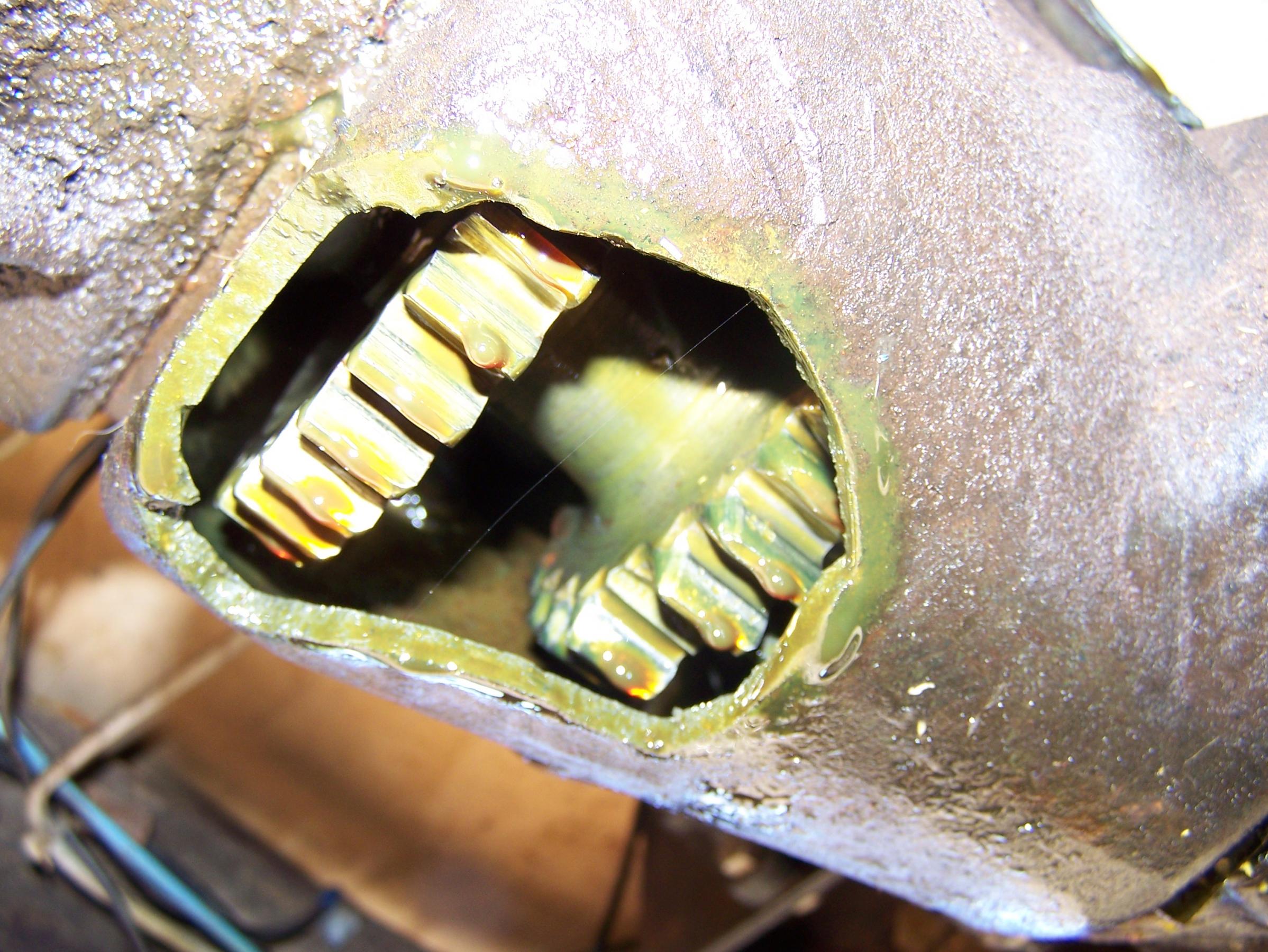

    Well after getting a new clutch installed. (i blew the last one up doing donuts in my field and raceing around my track). I took it on a test drive back around the track and did this. I guess i had more wrong then i thought.

    Looks like you still had oil in it.
    I think you just had a little more fun then the old girl could handle.

    Looks like your "modification" will make it easier to drain the 600 W. oil now.:eek::rolleyes:
    Looks like another endor*****t for a late model trans conversion.

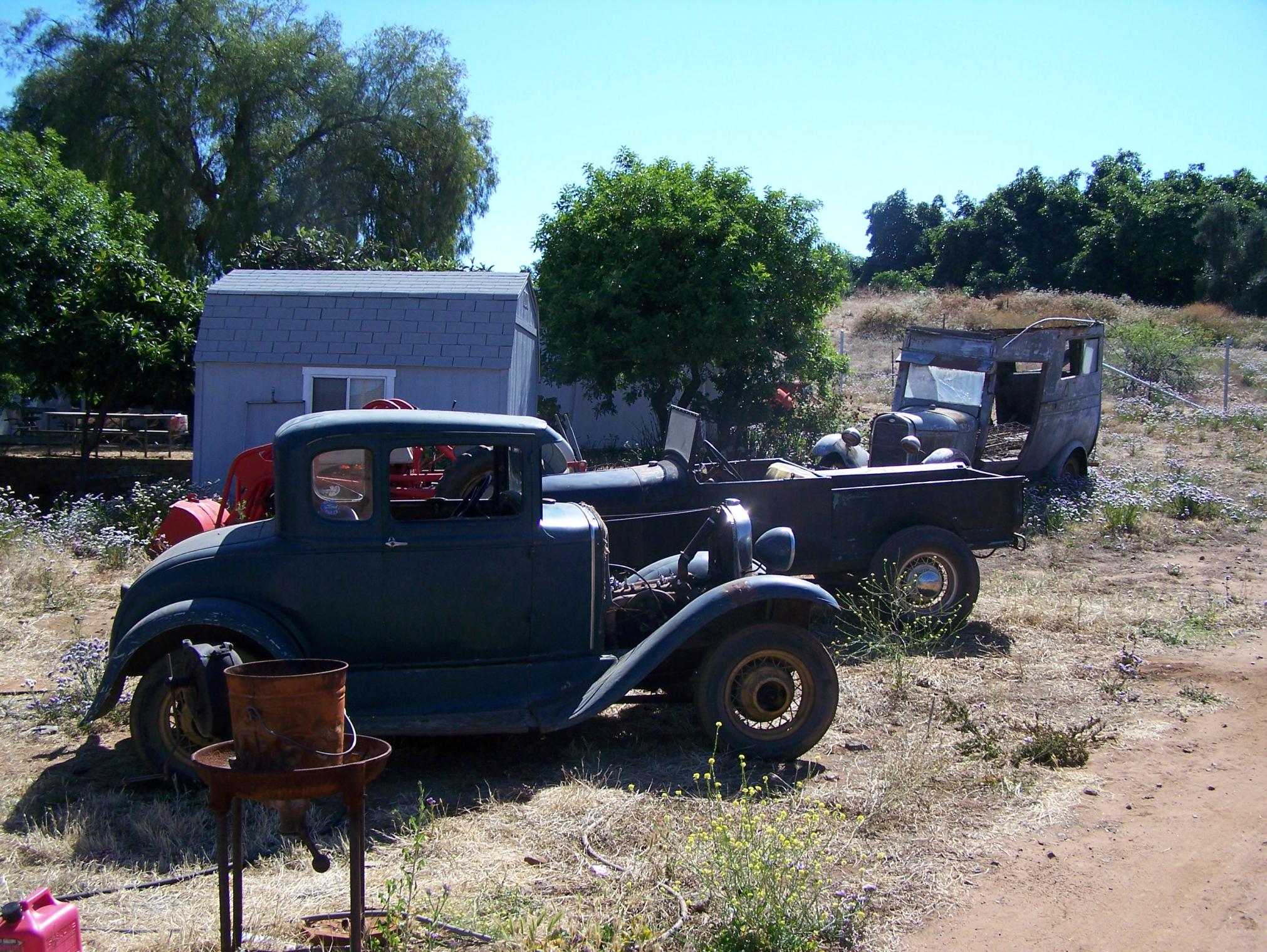

  19. Neat looking pit area! Is the RPU the push truck? Looks like a 8N portable engine hoist just like one I have behind the coupe, Handy looking forge in the foreground. Did you hurt your hand when you made that last shift? Maybe you should just sit in the car in the driveway and practice shifting before you go racing next time. I gotta a spare A trans out side some wheres. Drive on up and I'll give it to you.

    Yep 8n with the loader. The rpu has the broken trans. I acctuelly blew it up in neutral. It was clunking in first then no clunking in second. I reved it a little in neutral and it went. There was a pile of teeth on the ground. i should have known better. i got a spare trans im cleaning up now. but thanks.
