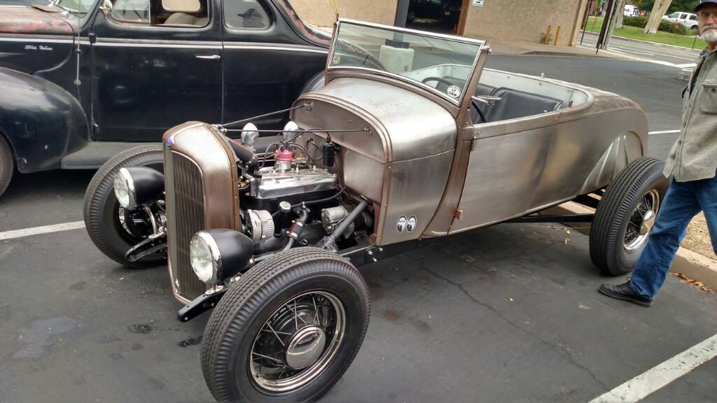

    Went to the National Automotive Museum in Reno Monday and saw this '29 that was said to be a reproduction of one of Bill Harrah's early cars. image.jpeg image.jpeg

    Thank you for the photo..... gives me an idea on one of my projects

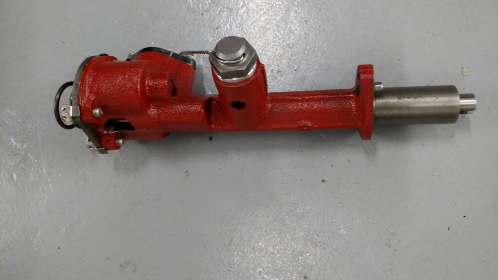

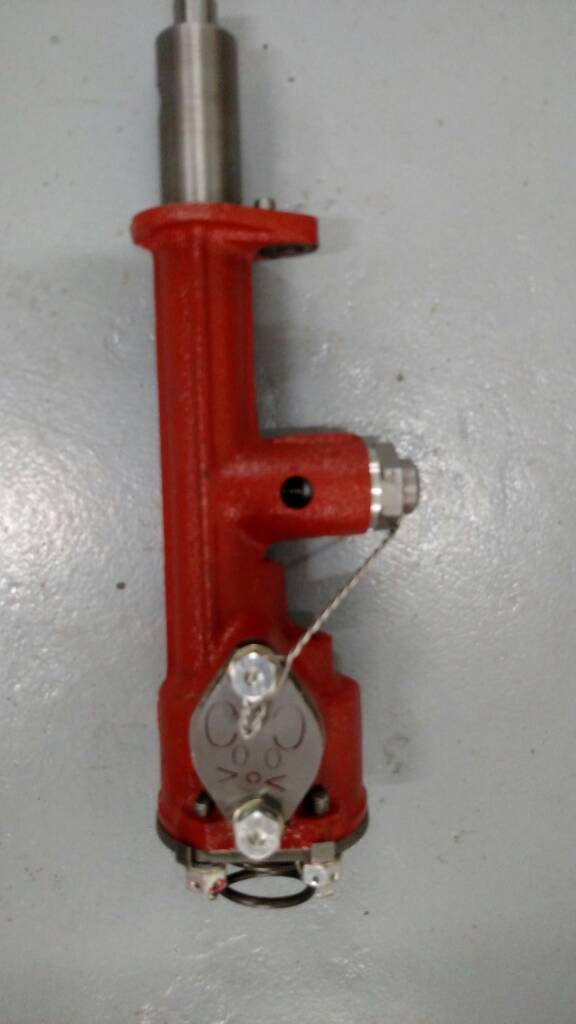

    I don't know what you guys are running for an oil pump in hour pressurized A bangers. I'm leaving for the LARS show this Sunday. I'm driving the '29 with a Miller conversion. The oil pressure has been a point of discussion with a buddy that is going along. He showed up with this today and made me install it. 1465522152729.jpg 1465522166021.jpg
    Modified V8 pump. Well see how it does. Don't have any miles on it yet.

    I use the same pump . works good . setting pressure is under safety wired nut on shaft . really a good pump .

    That is encouraging, thanks.
    Yes, added a spacer under the relief to lower the pressure. You can see it if you look closely. I've been running a modified A pump that has shortened V8 gears in it. This pump has 30% taller gears. Should have more volume.

    ive got mine set 25# . the nice thing is it doesn't change with heat or rpm . good luck

    Been using the V8 pumps for years normally set them 45-50 psi

    Hi! What year is the pump?

  11. The pump is a highly modified V8, I forget the years.
    I too have used them, they work very well and no external byp*** is necessary.
    I see Cliff around the For Ever Fours events and I think has another batch in the works.

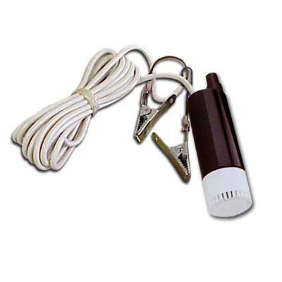

    water pump.jpg I have put these in the bottom hose of a couple of Ts they move plenty of water

    Details, please! 6 or 12 volt?

    The one I pictured is out of a '53 with the pressure relief

    It is one of Cliffs pumps. He is a wealth of information. Been getting the banger ready for the drive to the Los Angles Roadster show, going to try and make it by to see him. He says that 'this one was his last one' that he is having a hard time getting cores.
