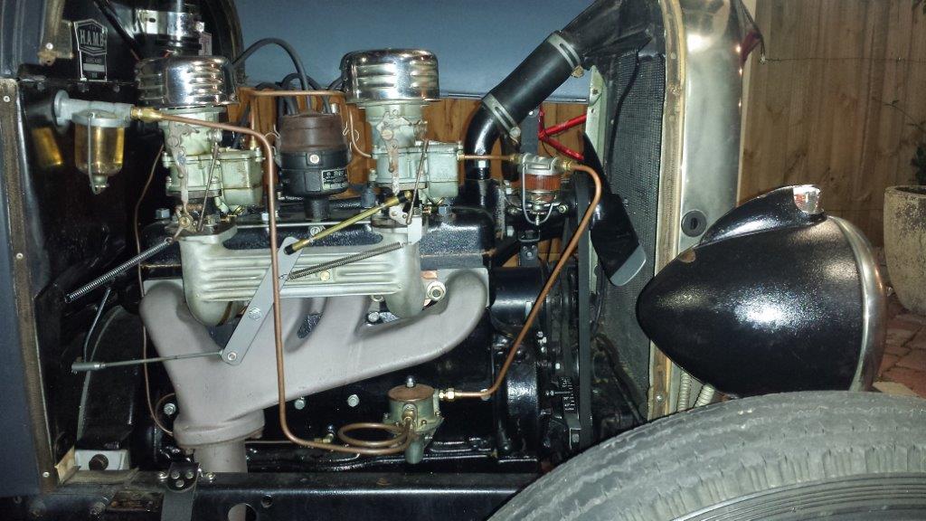

    20150622_205707.jpg View attachment 3242854 Hey fellas, went for a drive out in the sticks the other day and my model B motor ran like crap, missing and popping all over the place. I stopped to get some gas and noticed that there was condensation on the base of both Stromberg 97's. Putting my hand on the 2x2 Riley intake I noticed it was still cool, this is after driving for an hour. It was cold during the early morning blast in the roadster, and I'm not running a hood at the moment. Obviously manifold heat is an issue. Does anyone else have this problem, any ideas on a good fix?

    back when we were running webers on our motorcycle , carb icing was a good thing . but the definition is :
    What causes carburetor icing?
    Carburetor Icing, or carb icing, is an icing condition which can affect any carburetor under certain atmospheric conditions. Carburetor icing occurs when there is humid air, and the temperature drop in the venturi causes the water vapor to freeze.
    hope this helps . the missing was the water vapor

    I had carb icing (on an o/t car several years ago) - a heavy build-up of frost outside AND inside the carb. Turned out it was caused by an air leak around the throttle shaft. Couldn't find anybody who knew how or was willing to build it so I replaced it. I had been told it should be possible to rebore the hole the shaft went through and put in a bushing, but couldn't find anybody.

    On some of my old engines I wrap copper tube around the exhaust and then run the tubing to carb base. Looks old school and works. You can use brake tube too.

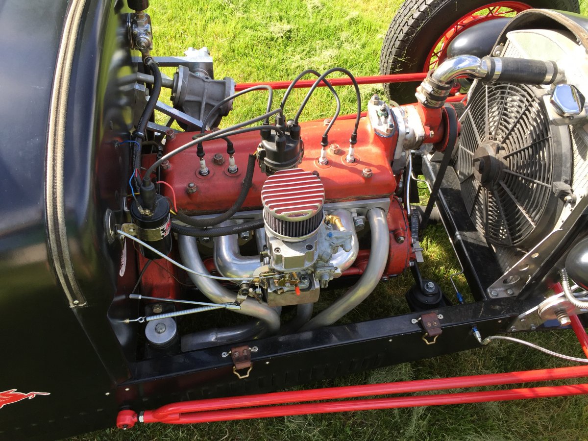

    Took a ride in the Zipper today and this is the first time I've put some miles on since a number of changes were made. Installed a bronze timing gear, new FS module and the 32-36 Weber progressive two barrel. After running a pair of English Stromberg 97's, a single Stromberg 97 and a Mooneyes EFI, the Weber is far and away the better setup. The intake was from Bert's and I bought the Weber adapter to use the K&N filter designed for 97's. In order to get the carb under the hood, I had to take 3/8" off the runners and another 1/4" off the mounting base. IMG_3024.JPG

    Great steering gear!

    4x4 , I went thru 2 of everything & the weber is much better in so many ways . congrats !

    Sorry, I've no photos for you but it's really simple you take a a piece of copper tubing 1/4, 5/16s and start wrapping it round from the exhaust manifold to the intake. Use a piece of rope to wrap first to get look you like. Measure that to see how much tubing you need And then start wrapping there is no real right or wrong way as long as it doesn't interfere with the linkage

    Heating the intake and/or intake air will reduce the likelyhood of carb icing, but heated intake air reduces available horsepower...its a compromise if the heating is working permanently. But you can take advantage of the principle that heat rises , make a sheetmetal "stove on the exhaust manifold and some ducting to the intake manifold and the air intake/cleaner which can be "switched" from hot air intake to normal ambient or even cold air intake. If you put the stove etc at the back of the manifolds it will not be obvious .
    Aircraft obviously have a much bigger problem with carb icing than cars... so they have carb heat as a factory fitted item .. with a control and all pilots are trained in it's use.
    http://www.pilotfriend.com/training/flight_training/fxd_wing/carb_heat.htm
    of course the Pietenpol airplane was designed to have a Ford banger engine and had a bean can on the front exhaust with a tube to the carb....
    http://www.hemmings.com/magazine/hcc/2009/05/Now-you-see-it--now-you-don-t/1814233.html

    Thanks 97, there's some great information in those articles. I like the idea of tubing wrapped around the exhaust manifold and then around the intake, however it would be a nightmare to remove either manifold when required. I think either circulating coolant around the intake or using the heat from the exhaust manifold might be a better solution in my case. Thanks everyone that posted for your assistance on this.

    I used some small diameter copper tubing wrapped around an exhaust on an off topic car way way in the past. BUT it was for heating water for a steam injection system II was experimenting with. Trying to overcome detonation issues , after we went too far with raising compression . It worked well, and kept the pistons and valves very clean ( from carbon) but as always, we moved on to different ideas... and until now I had forgotten about it. I guess you could make a wrap of soft copper tube on the exhaust, leave the lower tail below the manifold and direct the upper tail either at the carb base or into the intake. the hot air in the tube should rise and suck in fresh air to be heated . Bunnings has 3meter coils of 1/2 " soft copper here so I imagine they also sell it in Melbourne.... about $20.
