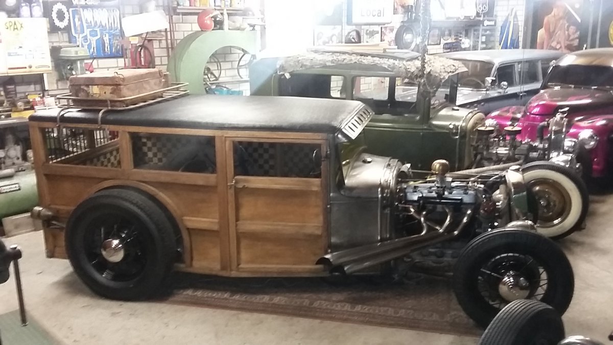

    here it is my newly built woody model a ford .

  23. Very kuul, Hotrod Holland! Do you have a build thread? And what's the story with the tudor behind it? :)

    I agree! Both cars look cool. What is the wagon? I would love to see some more pictures of all of them.

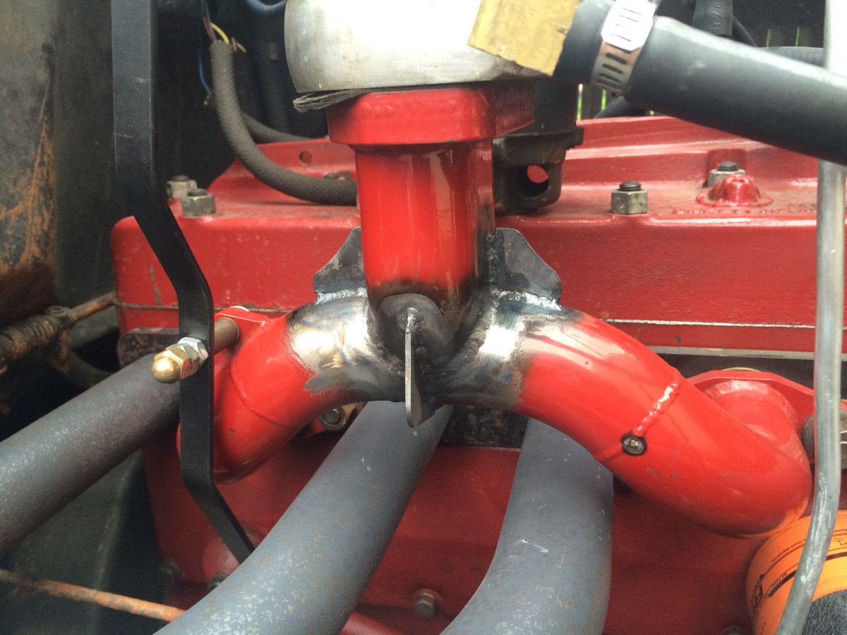

    Drove the phaeton 1000 miles from Chicagoland to Loveland CO for the MAFCA meet last week. Cruising 55 - 65 mph the whole way, no worries the entire way. Until ...20 yards from the motel parking spot and the car sputters and dies. Daughter #2 and I push the car into the spot and let it cool down for inspection.
    Turns out the tubular steel intake manifold developed some significant cracks.
    Recalled an earlier FordBarn post from Rex at The Forge in Loveland CO offering his shop to MAFCA attendees in distress. I brought the intake to his shop the next morning.
    The guys at The Forge took my manifold, immediately weld it up, and I was back on the mountain roads that afternoon. A few hundred high altitude miles and 1000 flat land miles back to Chicagoland later, the repair is holding up well.
    So ... in the words of some of the Kiwis I met at the meet, "Good on ya, Forge!"

    you made some good friends there . maybe to much heat on long run ?? glad you got the help .

    Looks like vibration to me...hard(er) spots in the manifold around the welds . Look at Phred's post #111 the carb , air cleaner , heater are tall, also the weight of the hoses full of water from the heater bouncing would offer lots of leverage to any vibration and add cyclic stress on the neck of the manifold. The braces welded on are a good call... I think the hoses probably need a support.

    I would think you could eliminate most of the extra stuff mounted on the little neck on the manifold. the next may be the fuel lines . "97" I'm tending to agree with you . simply is better . a lot of things going on there .
