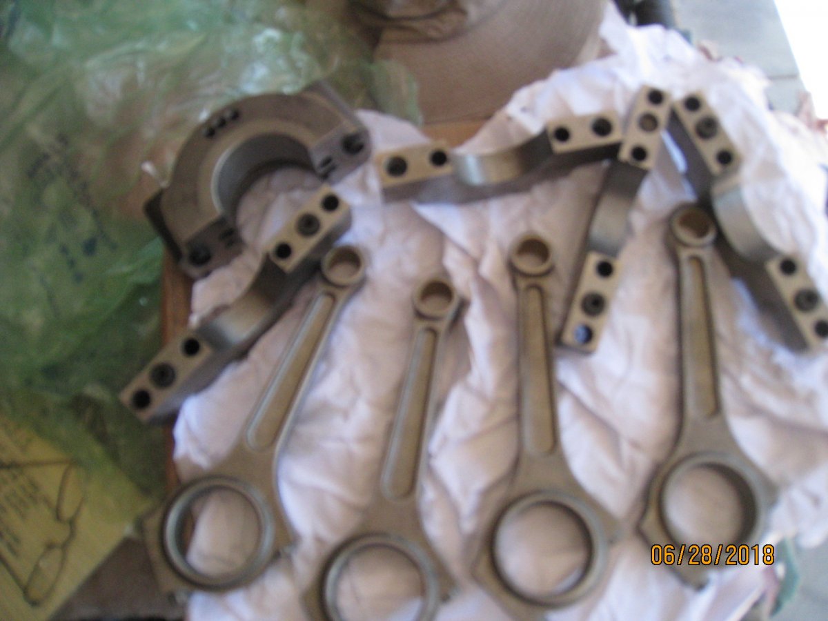

    Well, 'what's new in banger', may just be a Crower crank and (I think) what may be Cunningham rods. Look at the rod picture. The small end is not model A/B size (1" pin), but smaller !
    Anyone can say if these ARE Cunningham, and if so, what pin size fits this rod ? 001.JPG

  3. more than likely the pins are Ø.927, common Chevy. and yes, look like cunningham.
    Is this for Tod's new block or did we locate a Donovan?
    J

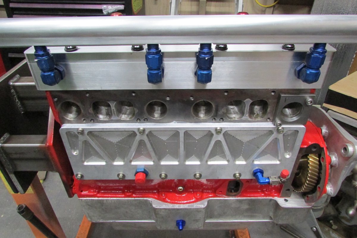

  7. That is a nice assembly but I would not run that head on it.
    J

  9. Crazydaddyo
    Joined: Apr 6, 2008
    Posts: 3,365
    Crazydaddyo
    It is almost a crime to build that engine with anything but a flat head. IMHO. OHV would waste all of the work redesigning the porting.
    A blown flathead set up would be even better.
    But I'm weird.
    winduptoy likes this.
  10. Thanks Dan, you hit the nail on the head.
    Flatheads suffer in the 6 port configuration, 2up/2dn cranks are expensive.
    That configuration will give a flathead really good performance and put a hurting on most OHV's. IMG_0396.JPG
    They look like Cunningham rods to me too. Mine have .972 pins.

  13. Crazydaddyo
    Joined: Apr 6, 2008
    Posts: 3,365
    Crazydaddyo
    Is the block filled?

  15. Yes, no welding, solid alum fill. A very hot day of my life.
    With my billet head ran 99+ for flying mile at Bonneville in a '30 coupe.
    One pass and the valves need lapping, that is dedication.................or insanity.
