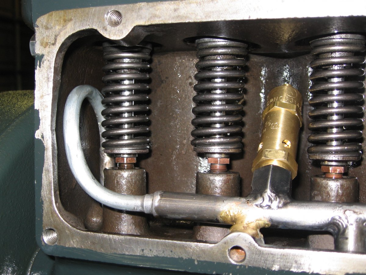

    Do you just solder the copper into the tee's too?that would shorten up the work,make fitting easier..Going to use an A pump,want to find a quality small relief valve..

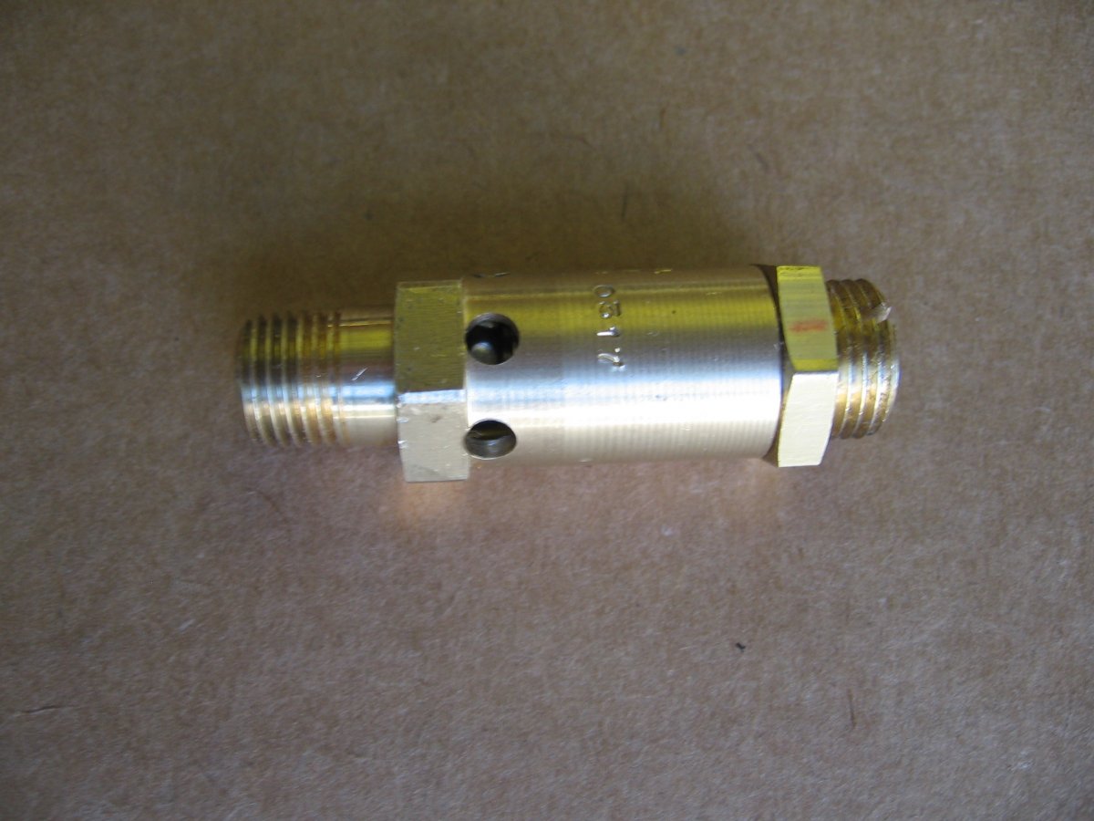

    Try either of these available from McMaster-Carr. They are air relief valves but can handle temperatures up to 300 degrees. I have used the large one in a pressurized A since 2012 with no issues and have recently built a B where I used the small valve. The small valve only had one port so I disassembled it and drilled two additional relief ports to achieve more flow based on my experience with how the bigger valve has performed.
    · McMaster-Carr PN 4772K2 1/8”-NPT X 1.75” height for 25 PSI at $9.71 each
    · McMaster-Carr PN 4772K4 1/4"-NPT X 2.50” height for 25 PSI at $13.27 each

    Thanks,nice work..was thinking about running the relief external which would allow relief adjustments without opening the engine up,by using bulkhead fittings on the valve cover...Ive got Yapps article on it just have to actually read it :)..but everything might change coming up here,got a date with what looks like a honey hole saturday..41 lincoln OD trans,21 stud and a 59AB lead the list he says he has a huge stash and wants to sell,Ill roll with cash,it might determine the next build..Ive been down this road before,its all shit till you lay eyes on it..

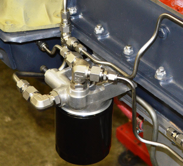

    I just order a combination external filter mount with adjustable relieve valve from Dan McEachern email dmcgears@yahoo.com relief pressure rages from 5 psi and up as I understand. waiting on delivery of the unit.

  23. 4bangerbob
    Joined: Jun 29, 2013
    Posts: 152
    4bangerbob
    from AB, Canada
    Picture of the filter relief unit

    ^^^looks like ORFS fittings..nice work right there^^^^

    Pretty busy looking, more pipes than an oil refinery. Nice job though and Swagelok fittings, high buck stuff.

    I like the idea of external plumbing,you can fix it or adjust it without tearing the engine apart..those air compressor pop off valves constantly over relief is scary,those things are dicey when they protect a compressor.Dont mind paying to protect an engine..
