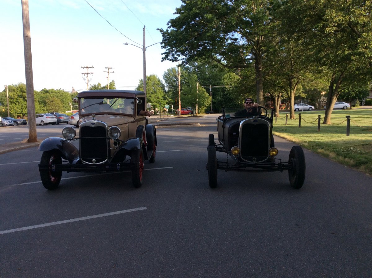

    7ACD230C-46AA-421D-A1C1-C4F792E600CE.jpeg Checking in...my buddy Cody and his 31 pickup moved 2 1/2 miles down the road from me so I gotta sidekick now for my banger powered cruises around town...
