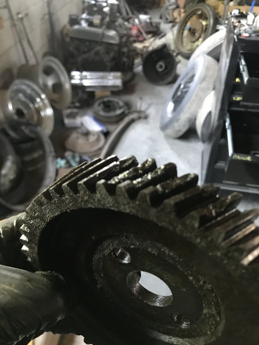

    Pulled pan on the pickup last night to check clearances. Down to one shim on mains, two in the rods. Babbit looks pretty good, no cracks or anything. Found out I have one of those custom-balanced cam gears so project expanded some... 83311BF9-128B-46AC-A1E8-E62675FDA04F.jpeg

  15. Jet96
    Joined: Dec 24, 2012
    Posts: 1,431
    Jet96
    from WY
    I've got an alum. gear already. I was planning on doing a cam etc. later but this might be as good a time as any.
    -When the gear let go in my roadster, the backfires were extraordinary!

    Turning the spring loaded plunger into a thrust ****on lets you 'adjust' down the clatter some..those fiber gears steal power without you noticing ..the teeth wear,slowly degrading valve timing.
    Logic says reducing compression should extend life..what it does do is make the engine more tolerant of timing deviation,its why the manual distributor was effective with the stock compression.Bearing wear is caused by improper timing and torsional vibration,poor driving habits lend to it,like lugging the engine..Get a kick out of the purists who say higher compression destroys babbit..
