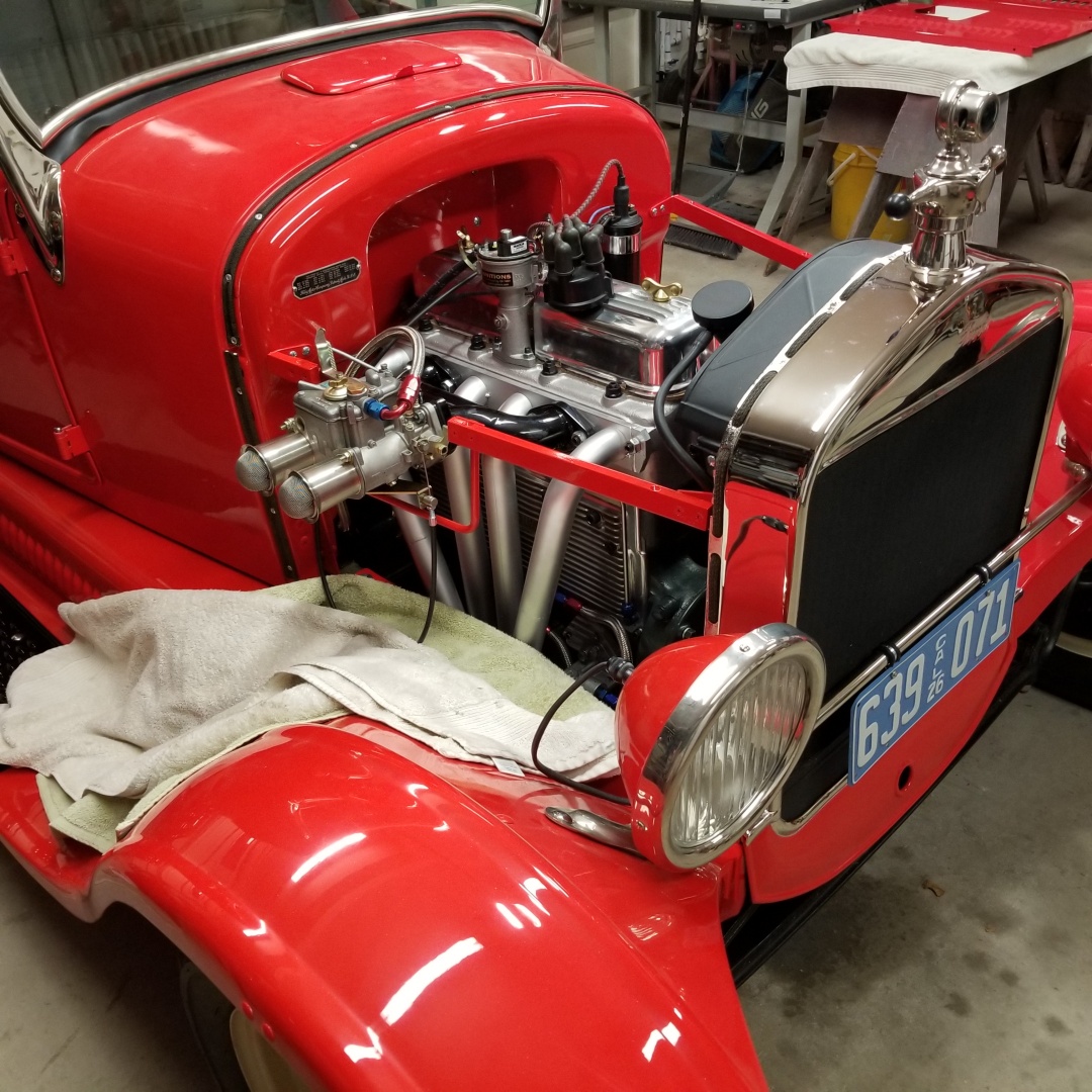

    I’m not good with remembering names, dates and details these days. But I can still see his face and great info he shared with us.

    With a combination of magnesium and polished aluminum, I think it'll look cool! Black oil pan going on soon.

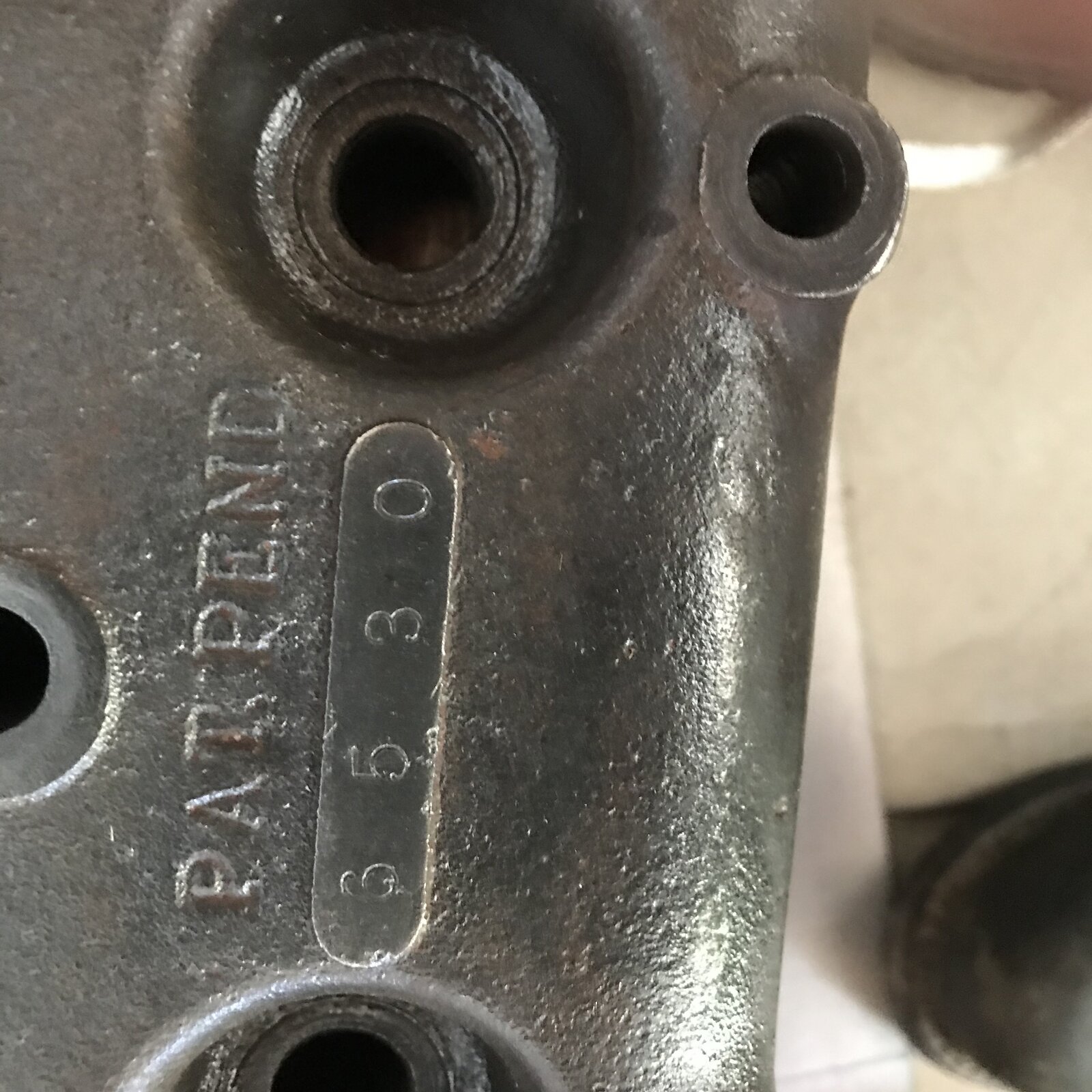

    Any Winfield experts on this board ?
    I have a 6:1 original cast iron , born on 5-1930.
    I never can remember seeing a compression ratio standing proud /above the head surface !
    My question… is this ratio marking standard winfield practice ?

    On the small oval pad the first number is the compression. This has been printed in many articles. Is it fact, I dont know.

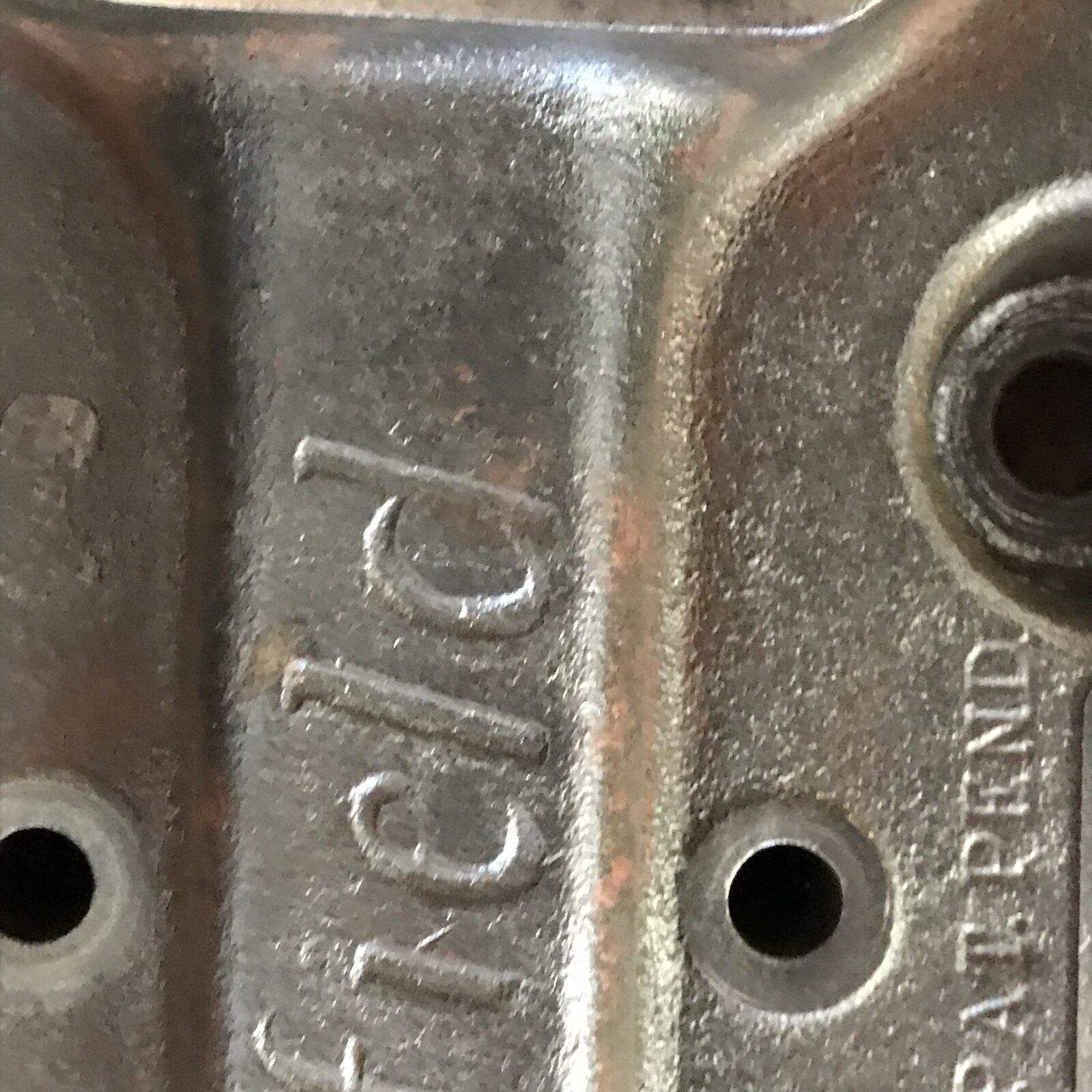

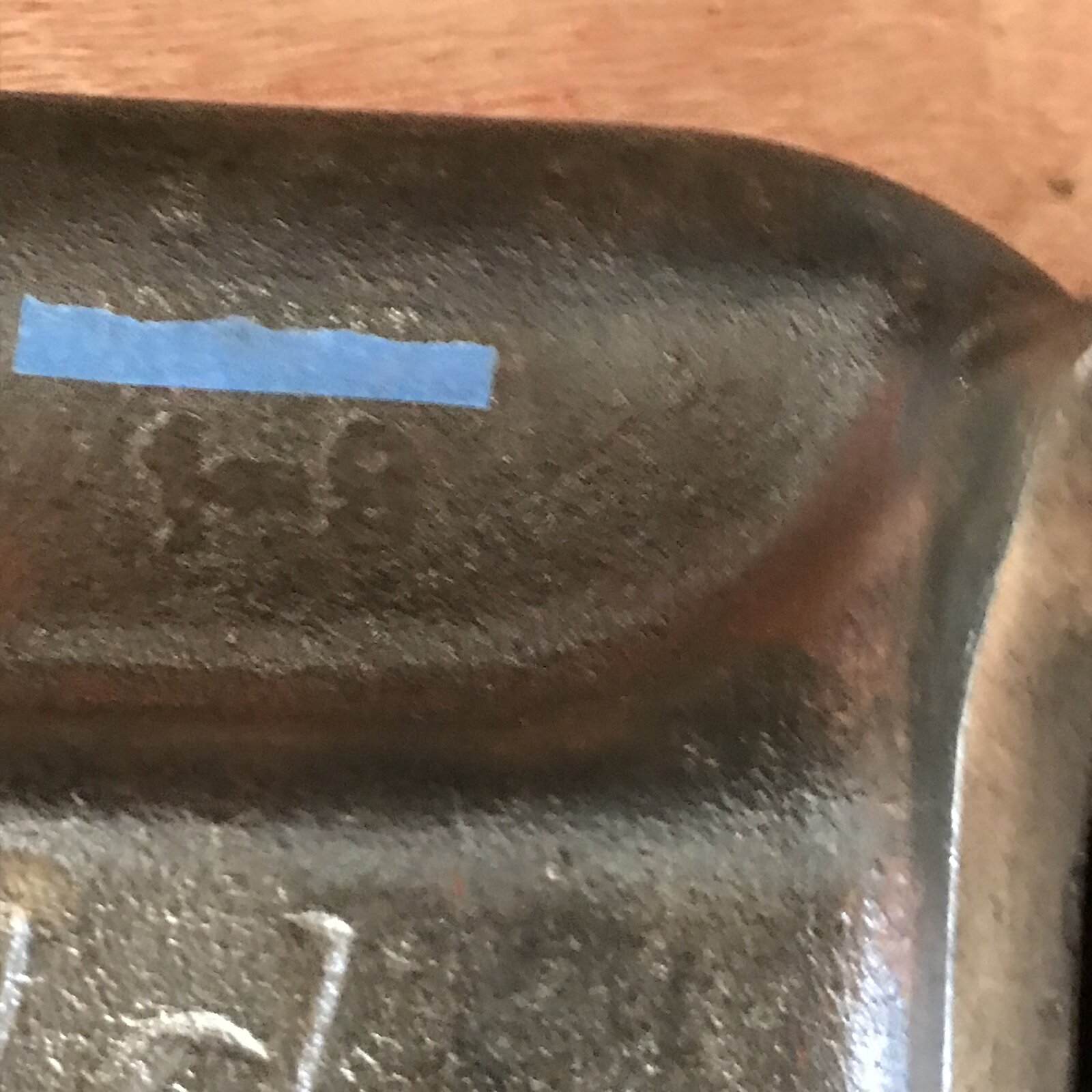

  24. hardtimesainit
    Joined: Jan 24, 2009
    Posts: 626
    hardtimesainit
    Somehow, My question about this winfield head… was not clear. Look at the FIRST picture, with blue tape… under the raised compression ratio , i. e. - 6:1 C/R raised cr ?
    I’ve never seen that before. Anyone ??
    Q: Do all Winfield heads have this raised
  25. hardtimesainit
    Posts: 626
    hardtimesainit
    Yes, Its pretty well established /known that the FIRST number that appears on the patent pending pad… is the head cr !
    No different on my cast iron head and on all aluminum winfield copies. NOT questioned.
    Again… look at first pic with blue tape.
    This raised head cr IS same cr as on pad just below the word WINFIELD ! Ive never noticed this before. Would you check your iron winfield for same situation. Thanks

    Not arguing that but you did cite the rest of serial number as a date code,its not.
  30. hardtimesainit
    Posts: 626
    hardtimesainit
    Ok, Ill bite.
    What do you say that the ‘rest ‘ of the number represents ?
