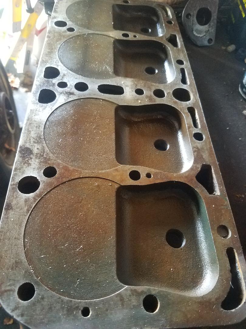

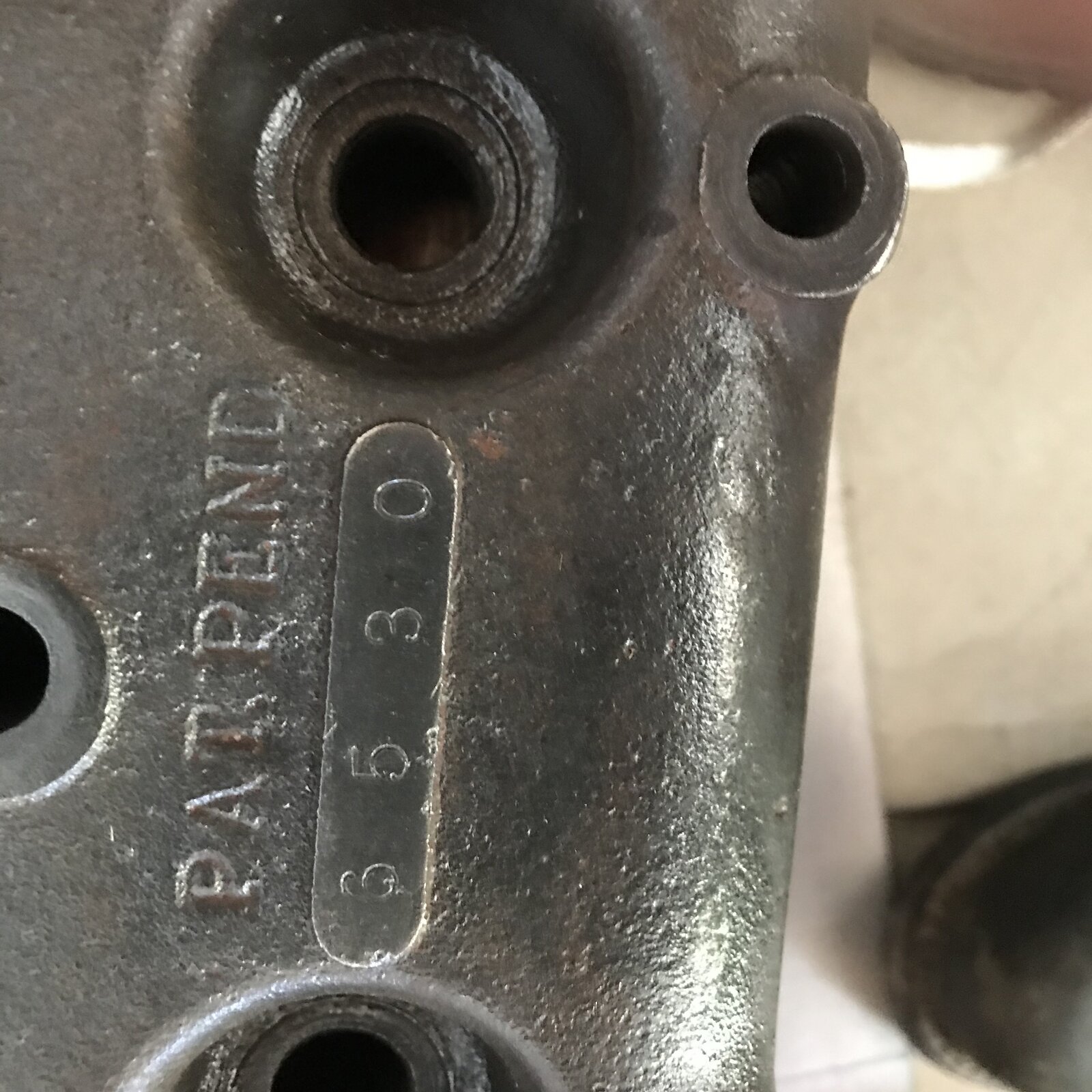

    serial number , unless railcarmover's Winfield head was made in 1983! The other thing I notice is that if the raised letters on your head ( Winfield), are about compression it's either 19:1 or 1 to 9 if I read the first number correctly as a 1.

    your guess is as good as mine.. maybe a production sequence, I don't know..all I do know is its a good head,and who doesnt like good head?

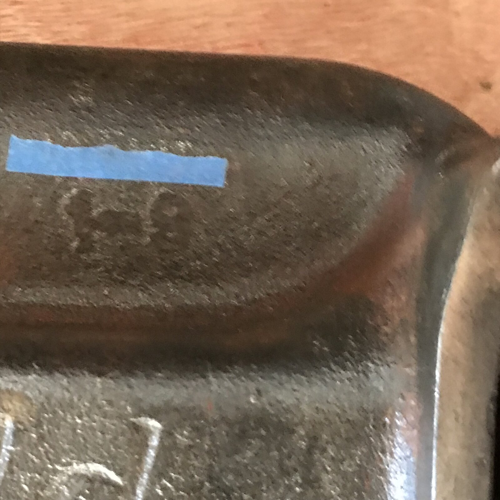

    Ok, I just took picture of 6:1 again and maybe not confusing to you. The 6:1 is underlined by blue tape. This marking is opposite side of WINFIELD head lettering… from the pad with 6 5 3 O. Not 9:1 head. Wish it was !!
    Winfield IRON heads were not made up into 1980s But plenty aluminum copies were and are still being made ! I have an alum at 7:1.
    I do have an iron FLATHEAD… with a 8:1 cr.
    It has the winfield crowfoot/ wedge comb chamber. It is a one off new caste iron head that I tested on a hot B. Ran great.
    It Was made March 2016.
    Had it flatened, put couple hundred mi. on it. Then went into storage.
    Made of mechanite. Machine shop said hardest iron head he’d ever flatened !!

    I found the head in Orinda CA,it was in the parts stash of a '28 tudor for sale, being sold by the grandson of the deceased owner. I cut the deal and drove a block away before I stopped, got out and danced a jig..I don't know **** about Winfield, or any other banger stuff other than what I read in a few old SOSS mags and Jims book combined with 42 years of pulling wrenches for a living, Ill never take the hobby to the extent others on this board do. I never measure the chamber volume of this head, just cleaned it bolted it on and ran it. Runs good, better than stock, better than a shaved Snyder 5.5 and a Rosemead aluminum 6 to 1 winfield repop I had ran before on the same engine.

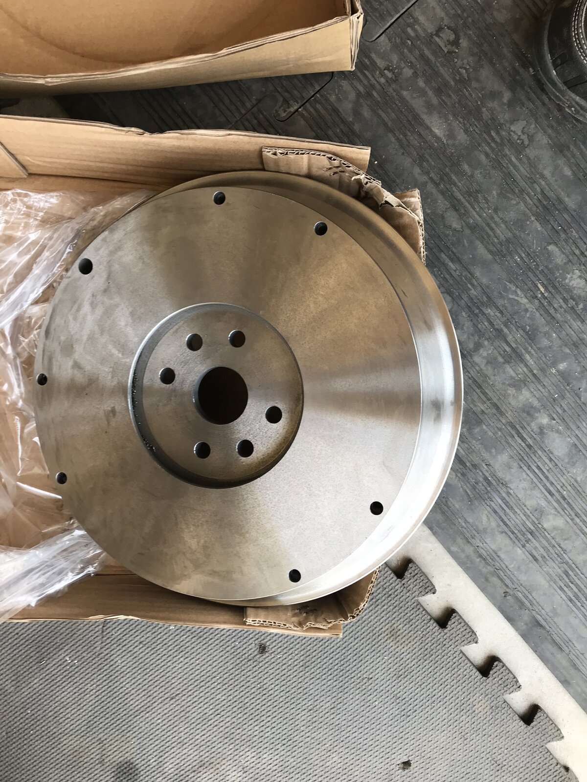

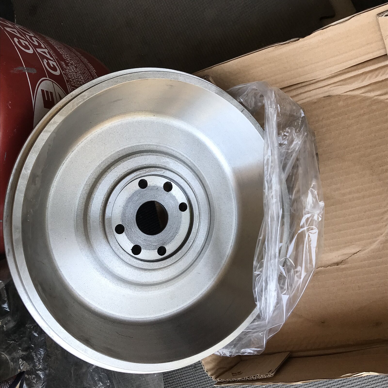

    Picked up my Burtz engine flywheel yesterday at warehouse. Palets of ton of them available. I wished now that I’d got two. Very nice. Now need ring gear ! Anyone got a GOOD source of quality flywheel bolts ?

    Nice score. from here I would say it is somewhere between 6:1 and 7:1.

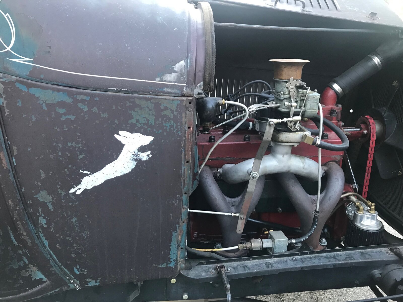

    Stromberg 97 and Banger help needed.
    (1) In order to enrich the air/fuel mixture at the idle circuit the 97, does one turn the needles in (CW) or turn the needle out (CCW)?
    (2) I may be reaching the cfm limit of my single 97 carb on my warmed over flathead banger at upper rpm range. Does the engine go into a lean air/fuel condition when it runs out of carb, or does the engine the engine receive just less of a "proper" AF mixture because only so mich ari can p*** through the carb?

    Back the idle air mixture screw out to fatten it up. 97 has a power valve at the end of the fuel pump stroke,take top off and pump out,make sure its clean,97 is an emulsion tube design,picture a straw with a bunch of little holes in it basically the more you throttle the more of the little holes get fuel..those holes do get plugged with ****,that 'white crust of death' is nasty.

    how about a little more information?
    at what rpm does it seem to go rich/lean?
    you say warmed over flathead, which head/cam etc.
    I have a single 94 on my coop, it will pull up past 5k

    Lion Head III with intakes relieved, Isky 1007B regrind cam, Intake and exhaust ported as much as I dared, valve springs shimmed to help with valve float, stock oiling system, dual straight pipe exhaust. Spark plugs #2 and #3 are lighter than #1 and #4 (nice tan color), probably due to Siamese intake ports and 1-2-4-3 firing order. Engine seems to run out of steam after 3500 rpm in 2nd gear. Runs VERY good otherwise, quite comfortable at 1600 rpm and up. I've read I want to stay below 4000 rpm with stock oiling
    1) I want to enrichen the idle circuit to cut down on "snap, crackle, pop" on deceleration and over run.
    2) I don't know that the engine is going lean at higher rpm. I just wanted to know if an engine is under carbed, does the AF ratio go lean or does the carb become a "restrictor" only allowing so much properly AF mixture into an engine that can "pump more air"?

  19. It sounds as if you are running out of fuel?
    Do you have a pump to feed carb
    Could your float level be too low?
    Restriction in the fuel line or inlet filter?
    J

    Air flow/depression at the venturi draws metered fuel from the bowl, after about 25% throttle opening the idle circuit will have little effect on air fuel ratio. A 97 in good condition should be able to meter enough fuel to feed your motor at those revs, as John says if it is still on gravity feed the float level may be dropping too far. Or, there may be an air leak (which the carb cannot meter).
    Popping and backfiring on the overrun is often an air leak into the exhaust. A warped header plate would cause that and also possibly an air leak at the intake/exhaust manifold interface . Depends on how your manifolds are made...do you have pictures of your setup?

    Here's a photo. 2-1/2# Facet fuel pump, split exhaust, hot water heat under the English 97 carb. I'll be adjusting the valves next week so I can change the manifold/block gasket then. I'll also check the float level and clean the carb then. Engine.jpg

    I see you are using the original tank, the pumps are designed to be mounted no more than 12" from the tank, and the FAQs at Facet say some pumps should not be lower than the fuel level.
    Another possibility is fuel getting heated and vaporising in the line , I cannot really see how close the fuel lines are to the exhausts . Your exhaust does not have the full length plate with the intake manifold bolted over the top of it as some are, but the manifolds do look relatively heavy and could easily be leaking air at the head/manifold joint. You can check that with the engine idling and spray some starter fluid, gas, or propane around the joints. CAREFULLY . If the engine changes note then you know there is a leak.
    https://www.facet-purolator.com/faq/
    http://www.facet-purolator.com/wp-content/uploads/pdfs/2018 Automotive Catalog.pdf

    Thanks, I'll test with starter fluid prior to taking things apart.

    No fuel pressure regulator! What's that thing with the hose coming out of it under the carb? block it off and try running it.
  26. Steve
    The factet pump does not need a regulator if the proper model selected
    The hose below the carburetor is a heater plumbed into cooling system

    That test only applies to the intake manifold obviously , you should also carefully remove and closely check the gaskets as well , for both intake and exhaust leaks . Other places for an air leak could also be at the base of the carb , top and bottom of your water heater , etc etc. But I think that if you have two cylinders light colour on the plugs and two looking rich , any leak is likely to be at the manifold to head joint. As you have ported the head "as far as you dare" , check to make sure the gaskets are actually sealing right around the intake joints, it only takes a small air leak !
    One other thing I just thought of, is the fuel tap under the tank inside the car and also the filter/watertrap on the firewall...they often get clogged up on Model As , there is a screen in the tank which pushes into the top of the valve under the tank, which can get clogged up too, any restriction in the lines like that will cause issues at higher revs. https://www.mikes-afordable.com/product/A9193T.html
    It might be a good idea to check fuel flow and pressure , at the carb inlet fitting .

    Phred, where did you get that intake heater? also, with that long bell crank in the throttle linkage you want to make sure you are getting full throttle.
