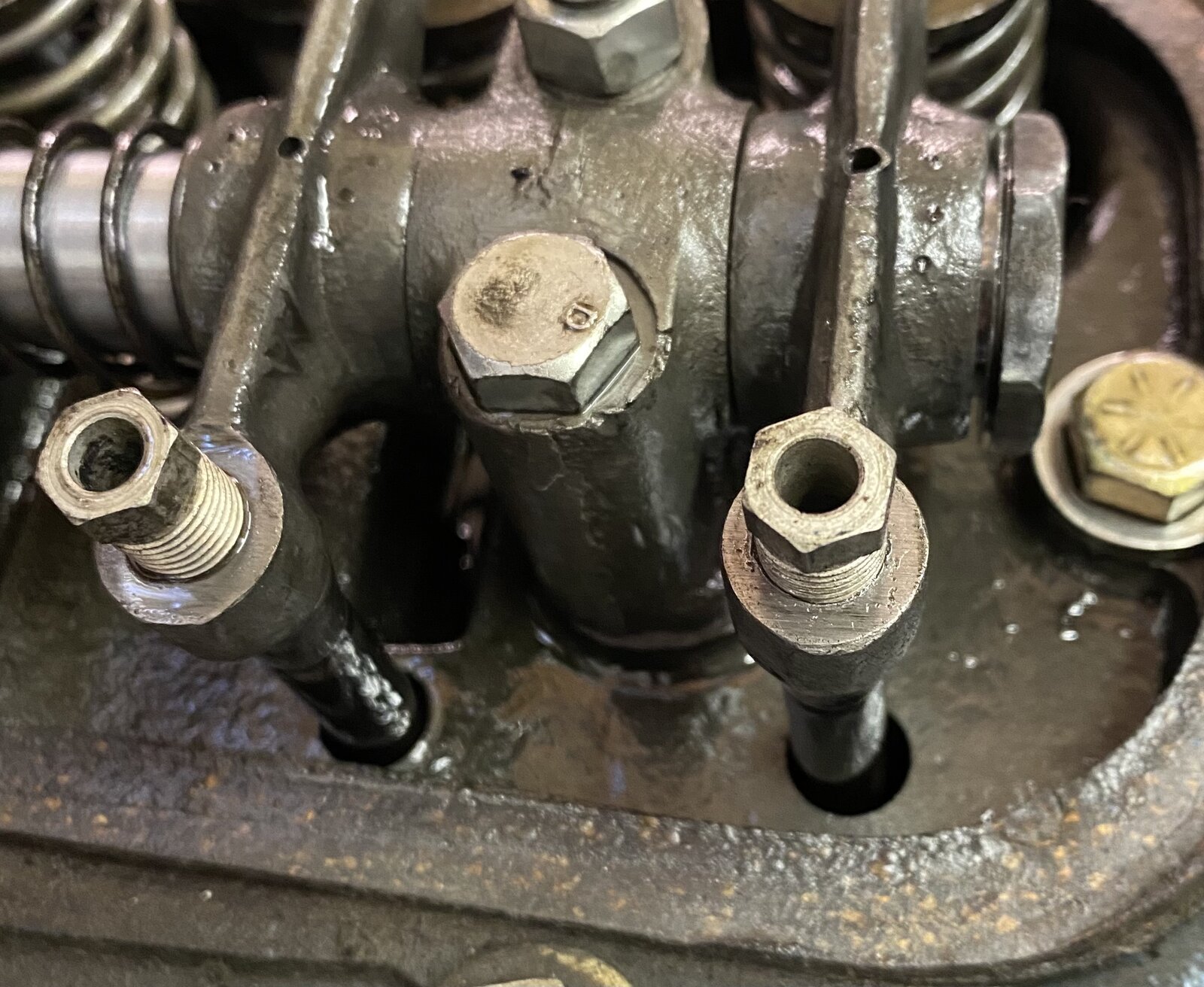

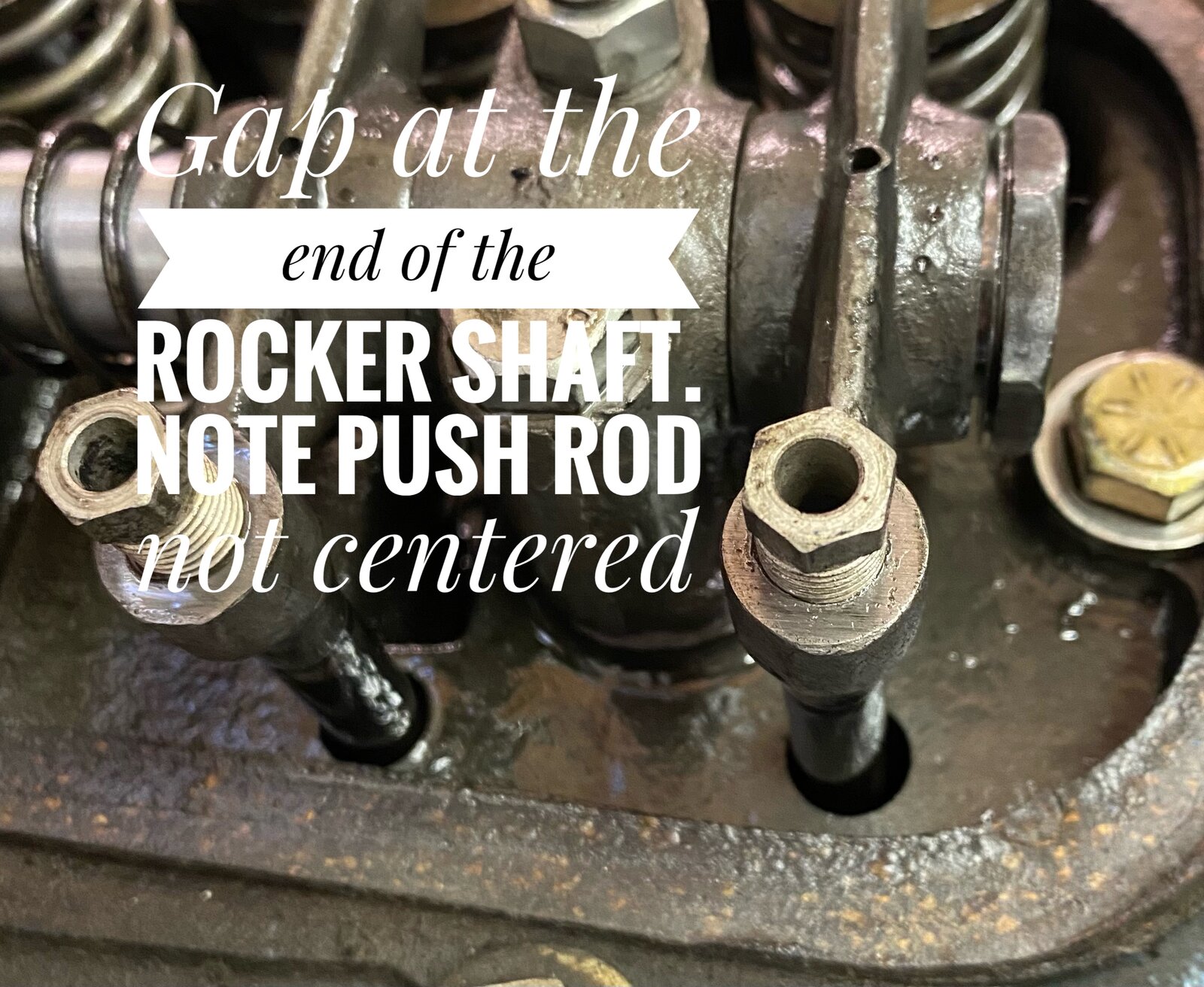

    Need some help here. As the photo shows, the first rocker has a gap and the push rod isn’t centered in the hole. Tried tightening the nut on the end to no avail. This is an original 1935 CRAGAR head.

    Pull pushrod,roll it on a true surface

    Rocker arm looks bent from that angle.

    Note the gap at the end of the rocker shaft. I’m thinking that there needs to be a spacer on the left side of the rocker and then the push rod will be centered. Rocker is not bent....camera angle is bad

  7. might just need a shim or wave washer between rocker and stand
    how does geometry look?

    you can fire it up with the cover off, see what's going on..
  9. How does it look on the valve end? Will a spacer put that end out?

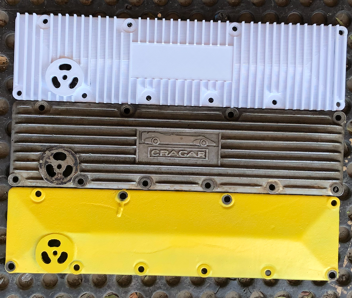

  10. Welp, the 3D print came out sorta decent. Got a LOT of work before I can start having them cast!

    Looks good to me, however I think Cragar had it right... vertical cooling fins will likely slow your top speed by several mph from wind resistance, haha.
    Unless of course, you chrome it. Everybody knows any chrome part is good for 3 mph.

    Your 3D printed part looks to be the exact size of the Cragar - it needs to be larger to allow for the shrinkage when the metal solidifies - aluminum shrinks 6%, iron 10%.

  14. This is simply something to stand out and not be "cookie cutter" I'm curious in a hot rod with a full hood if it will affect it.

  15. Correct, this was just a mockup print to see how it would look on the engine. I'll be scaling it somewhere between 6-7%. Just need to clean this one up first.

    Did you talk to them first? The foundry I use will not cast in holes like your mounting holes. If I am using an existing piece I make up aluminum plugs the same length as the thickness and put a center drill mark in the plug on my lathe. Them press them in. That way I can just drill out the holes on a drill press without measuring.
  17. To be honest, no. I'm still searching for people to cast them. That's pretty smart about the plug, I'm going to have to try that!
    Do you recommend any foundries?
