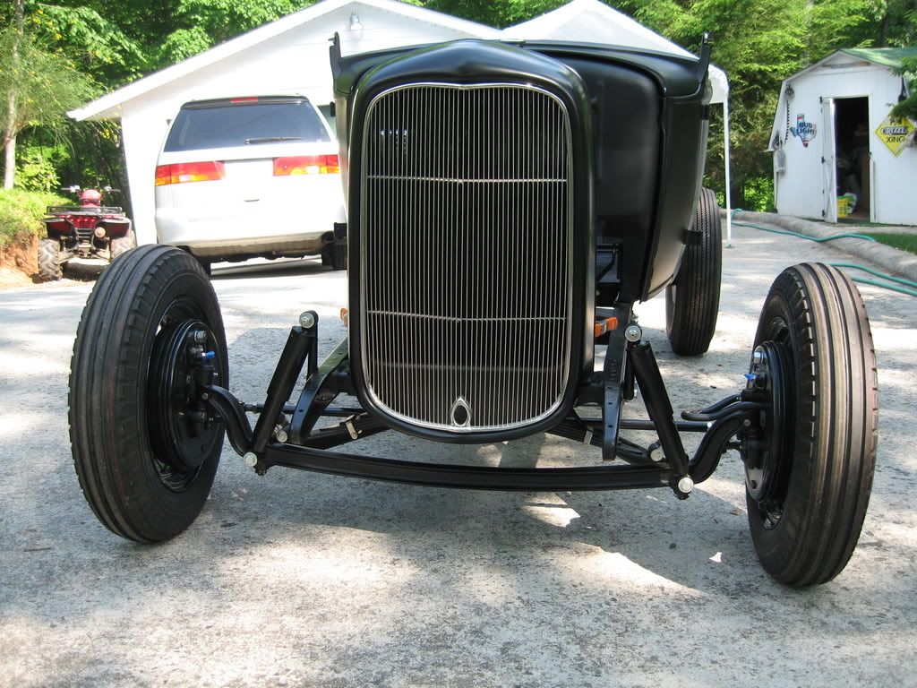

    I scored a rebuilt B engine since my last photo update ('32 with non-counter balanced crank) and am very excited to see how it runs in the car - sounded great on the test stand!
    We are still going to remove a leaf from the rear and install a reversed eye main leaf, that should bring the rear down a couple more inches. Just didn't get to it this trip. Also still have to get the rear converted to hydraulics...
    I have always imagined this to be maroon, but it looks so good in DP90 that it may stay that way for a long time. The paint turned out much nicer than I expected - not bad for a driveway paint job. Plans are for a full hood, deluxe windshield, stock roadster seat, and a handmade wooden bed.

    Will...damn. That's great. Seriously.
    If it were me? As is. No hood, no screen, no bed....but that's me.
    I'm jealous of ya.
  3. Be a shame to get it dirty! I like the primer, looks like old times.
  4. Will, your Banger/Rod project is sooo *****'n! If you're going to spin that "B" baby up, particularly with that crank, put a Harmonic Damper on it. You can modify a SBC damper; or get one that's been modified from Jay Steel at Taylor Engine in Whittier, CA.

    Thanks for the kind words guys - it has been a long and spendy road to get to this point, the encouragement really helps and I sincerely appreciate it.
    I don't think I have ever seen a '30-31 extended cab roadster pickup done up this traditionally before. I am still trying to figure out exactly what I've got. Artiki's ideas are interesting, it is easy to look at it and envision it more as a modified than a RPU.
    As for the hood, I am going to start with a stock '30-31 full hood and go from there. It is easy to remove and run without, or alter it into just a hood top later. I need the windshield to block the air for my big head! You can lay a '30-31 windshield all the way down on the gas tank like a Jeep, can't you?
    I am pretty much committed to the stock gas tank (and dash, steering column support, etc.) and it looks like I will even be able to keep gravity feed to the carb since the manifold is pretty low. So an oval T gas tank out back is probably not in the cards. But maybe... Would give me an excuse to find and hook up a B fuel pump!
    One idea I had was to put a big, black trunk out back instead of a pickup bed. Any opinions on that idea?

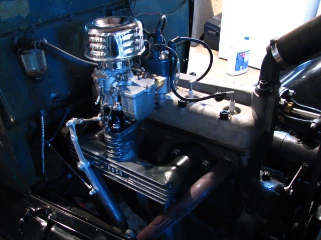

    Hi Monkeybiker, here should be a pic of the s.u's .No real issues with them, she's popping a bit as the revs get up, could be leaning out or electrics .I have a twin downdraught manifold and a few 94's [81's dont seem to exist here] so i thought a pair of singles would do ,plus i can then run bonnet sides and keep the local boys guessing!! The carbs are a swapmeet pair [1 1/2" I think] . The manifold is just some pipe,flamecut flanges and a balence tube [ which also means i cant run headers] and i rigged up a idle rod from the valve cover to a bracket on the frame for the linkages [right hand drive of course] .Hope this helps, thanks Brett

    Will, very cool engine compartment. I am curious as to who makes that intake manifold?

    Will that ride looks so perfect.. I take it that you're using a 30-31 roadster pickup cab?? I'm in love.... motivation man motivation.. I got the frame, just need the rest and I'm thinking I'm gonna get it soon! thanks cheers!
  9. Ah - and RHD too like my Sedan. So - would the carbs fit within the bonnet line with shorter ram pipes? I'm probably going to a header anyway so hope to keep them tight to the block. Or throw them away and use a 94....

    From my initial mock-ups with SU's it seems that they will fit under the bonnet, its very close though. Don't think theres much chance of keeping a ram pipe under the bonnet.
    To run SU's and a header you will have to space the carbs out on a longer manifold, which then causes more problems with the fit under the bonnet.
    I don't intend running a balance tube, but I supopose you could always loop a rubber one over the header??

    Coupehead - the intake manifold is a "Scalded Dog" from Charlie Yapp at SOSS. I cut off the front throttle linkage boss, ground off the letters, sanded out the machine marks, and had it gl*** bead blasted.
    Retro54 - the body is an extended cab '30-31 roadster pickup from Brookville.
    Lucky Star - Thanks for the input, your car is really cool! Some people say it will work without a fuel pump, others say it won't. It is hard to tell from the pictures, but I think I may have more drop from the sediment bowl to the carb than you do. I am gonna see if it will work without a fuel pump, and if it doesn't I will either add an electric one or try to get a B fuel pump.
    I have pretty much decided to ditch the wooden pickup bed idea and go for a modified look with a big, black trunk on the back. Something like that black trunk on the back page of the new Snyder's catalog...

    Will, that thing looks great. I would look for a full length bed for that thing to make it complete. I enjoy the looks of Model A trucks w/ the original bed (not all chopped and shortened to make the car look un proportional)

    Hi S.U. fans did a quick measure and my manifold tubes are 3 1/8" long [ the flange clears the exhaust by about 3 /16 '' at the back] the carbs are 4 7/8'' long and without the ram tubes the bonnet sides will just touch the front carb. If you ran a header exhaust the intake could be shorter and fit under the bonnet{hood for you Americans} hope this helps ,thanks Brett
