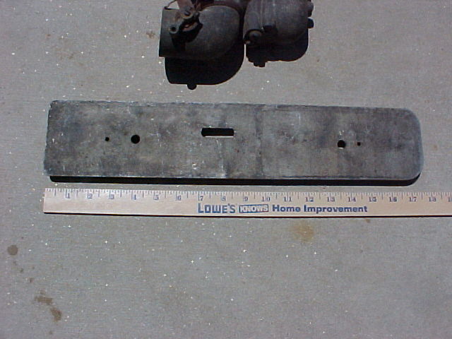

    Another dumb "what is it?" question. I picked up some cool banger stuff from a local guy and included was this finned aluminum side cover. It is smaller than a model A, any ideas? Thanks in advance! Kenny.
  6. flyin-t
    Joined: Dec 29, 2004
    Posts: 1,719
    flyin-t
    That side cover looks to be late T

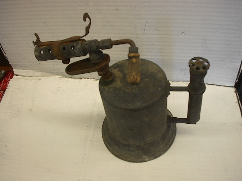

  13. I too have one of those although it is not as sophisticated as yours. The one I have has the pump built into the handle and it is a bit worse for wear. When I was in High School one of the guys wanted to lead in or fill the hood on his parents 46 chevy, I was asked to help as I was the only one that knew how to light the blow torch. In those days almost all home farm repair shops and garages had one of these. Not too many people could afford an acetylene outfit. Most welding shops had an acetylene generator and they were usually large and bulky. The bracket on the top was where you would place your soldering iron to heat And the small propane torches were not around yet . Well, after he was done with the hood you would almost get seasick because of the waves and warps in the hood
