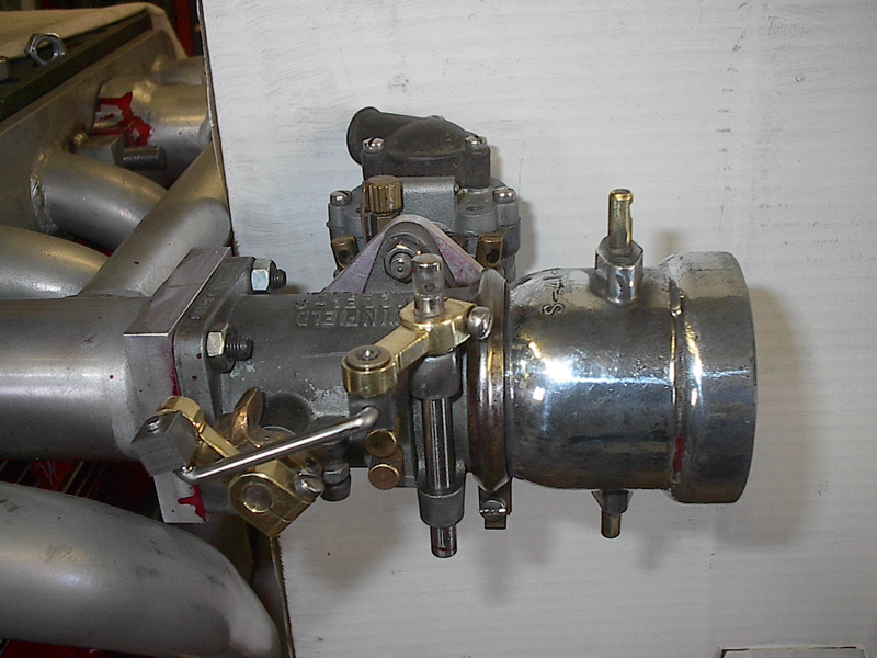

  13. Side drafts Some of the pics are out of place but I'm sure you can figure them out. This is a group of pics showing the various components of my new set of sidedraft conversions. First are the pieces required to fab a new manifold, You are going to need a sidedraft manifold so I included the pics of mine, then the finished components along with the welding fuxture. I made up a pair of blank pieces that held the finished balance tube in place, they were a little close and I had to bore them out. Then there is the new linkage I made. any dual Winfield's will need good linkage, no slop! The next is the adapters themselves. They must be clocked right, the first set Of side drafts I set up were one down and one up draft. In the pic the one with the studs is one of the original pair. I laid them out and drilled the holes using a new gasket for a lay out guide. I drilled the hole for the ports or p***ages and planned on setting up my rotary table to machine the p***ages but one night with nothing else to do I cut the p***ages with a Dremel type tool and a six pac of Coors Lite. The current set were done on the rotary table. I include the gasket pic because the current style as sold on Ebay has too many holes and I was afraid the thin webs wouldn't seal so I made up the little die and punch my own with 1/4" holes. Also a word of caution, if you use the original studs that connect the float chamber and the throttle they will protrude and hit the float chamber unless you shorten them or use thicker material for your adapters. I use a 1/4 28 allen flat head screw to hold the plates and recommend loc***e on all threads, especially the flat head screws. Ask me why! I hope this helps. The last pic is the finished piece installed. Ask me how it worked. The last pic was taken after the race. I use just one choke and key the other one open. If you look closely you can see the adapters in place. If you look real close you will see my high tech wire holding the distributor and if you look closer than that you will see the small dia. copper wire as safety keepers on the sparkplug wires at the plugs.

    Nice job Bill..... I can appreciate all the time it took to do that..... So the big question is how do they work as side drafts? And did you run these at the Antique Nationals?

  16. Yes, we ran them sunday, as to how they work, I ask how does 82.7 on an ET of 15.9 for a first time 18 year old driver sound to you? His second run was against a "T" bucket with a small block that ran 80. I think they work. Actually, I didn't do any fine tuning on them. I had to open the idle needles quite a bit more than the book said or more than I figured. In fact, I had to open the intermediates up just to get the engine to idle. Idle port is fed by the intermediate well on Winfield's. And the pumps are blocked off. Although some people shy away Winfield's in reality they are actually very forgiving.

    If I look close I see... an incredible amount of knowledge, experience, mechanical skill, clever modification & attention to detail.
    'No Tech' my ****.:D
