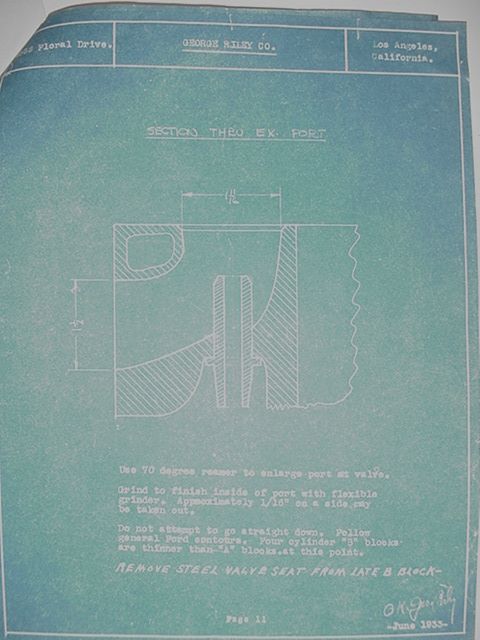

  16. George Riley recommended using a 1.625 (15/8") with a 70 degree angle cutter to open the exhaust valve pocket and port. It would seem if there were any difference it would be more water around the exhaust port/seat I think he was referring to "B" blocks I don't see why it wouldn't work on the intakes. I have my intakes opened to 1.625 at the ports on an "A" block. I also remember Joe Mac blowing the bottom out of an intake port because he or someone had removed too much material. I'm not sure but I don't think there were any casting changes around the port. The main difference is the deck is thinner on the "B" block There was a drawing of the casting changes dated late in 31 prior to production of the "B" showing the dimension changes. Wayne Actkinson also opened up ports in some of his block flow tests. All this is from articles in S O S S. The Riley info is from his recommendations on setting up a block for his 4 port head.

    Here is the George Riley porting dated June 1933.
