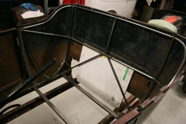

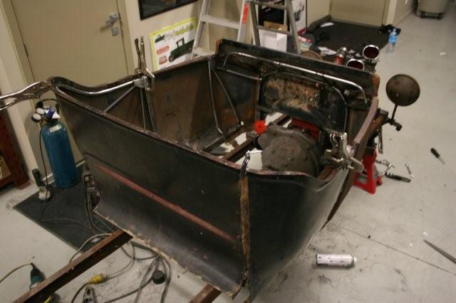

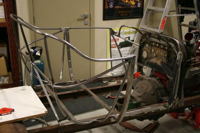

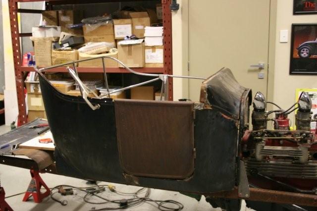

  4. Tonight I got about 2/3 of the way through steeling out the T body with 5/8" OD steel tube.
    Just gotta frame around the door, the cowl and also the door itself.
    Next week the running gear arrives and I want to get the body steeled out by then.

    Greg I like what I see but am a bit worried about the use of the tee ch***is three points
    1 they flex a lot
    2 they do not like to be welded
    3 the motor becomes a structural part of the frame ie solid mounted I think a box section ch***is or A ch***is[zedded and wheelbase adjusted may be better] Just my 10 cents opinion:rolleyes: Rusty

  11. Thanks Rusty
    1 - T ch***is going to be blown apart and bolted together like an early Miller race car.
    2 - maybe dont like to be welded due to the flexing?
    3 - motor will be rubber mounted - ch***is will feature an X type member out of folded channel that will allow to retain the early style but tie things together a bit better.
    The thing is that I am being VERY careful to spend NO money on this or very little as I want to keep progress going on the 32

  30. Progress by Sat night of this weekend is this.
    Next is a couple more days of gussets and fitting seat riser and toe board then running gear should be here
